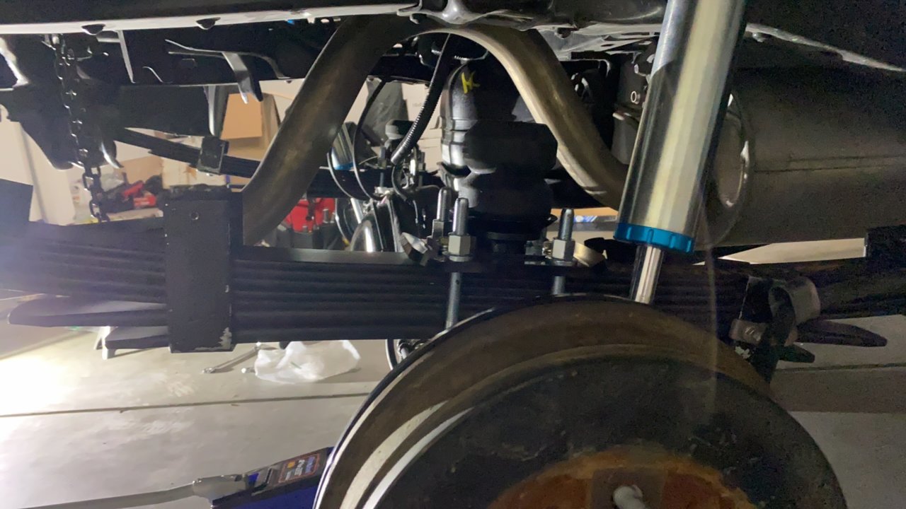

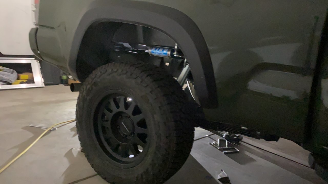

    Got the rear suspension dialed in and ready for the weight additions

    which leaf pack? Did you get the truck weighed? If it’s a Dakar leaf pack and you have bumpers armor fair warning it mag not be up to the future task for long. I’m waiting u too I get the x1 to fully swap our. Currently have a HD Dakar setup so good enough for pickup

    Ome HD right now, I won’t be getting rear bumper anytime soon, most likely would go Deavers when the time comes. My estimated weight is SP (300), Rigd carrier/ spare (150), and camp gear (150)

    Current weight rn is about 300. RTT and rigd/spare.

    I'm Doing the same after you and i have discussed have the same leafs currently. Just waiting for my kings to put my new towers on.

    make sure you account for any skid places, sliders. seems like you will be ok but just, for example, I have full armor and a swingout and my truck is estimated at 1700 over stock when I thought it was be closer to 1000 so def recommend weighing your truck just to make sure. You should be fine but it was a big surprise to me.

    yah that's the good way to go. I did my relocation last year with the Dakars and they are not up to the task. My truck/shock shafts sit a couple of inches lower than they should. I hope the the new leaf pack give some the 2" that they are missing if not I will need to have the lower mounts moved lower. Ideally do it with whatever leaf pack will be the go forward but at the time I did it anyway.
    the dakars will get me to Portland and back so it's ok for now. I also just ordered some energy suspension body mount and radiator kits. Likely the mounts are toast anyway but with the extra weight some poly's will possibly give me some lift in the front back. I would highly recommend adding that to the list even if you have a newer 3rd gen.
