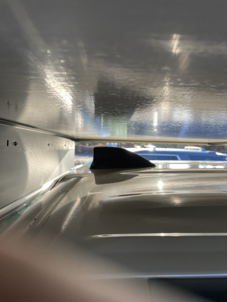

    Drawing not to scale. This was the best way I figured to show the clearance at different locations all at once. This is a top down view.
    The sleeping platform extends 35.5” over the truck cab at the furthest point of the corner hardware. The center front is measured at the tightest point which is the rail as it’s a smidgen thicker than the rest of the underside. The remaining measurements don’t have the rail included as the camper is wider than the taper of the cab. Hopefully this all makes sense. Again this is not to scale and the “square” is only the sleeping platform that extends over the truck cab. The antenna is 2.5” tall so the actual clearance over the antenna is 1.5”.

    1,330
    cool - so the shark fin is the highest point - that's good to know.
    Using the 2.5" roofline clearance number on the 3rd gen, you should have approx 1.5' inch roof clearance on the 2nd gen since the bed is 1" lower (not sure what the shark fin takes up of that space), so if you swap bed rails you'll have about .75" clearance over the roof (which will most likely cause the tent to rest on the shark fin if it's actually the tallest point).
