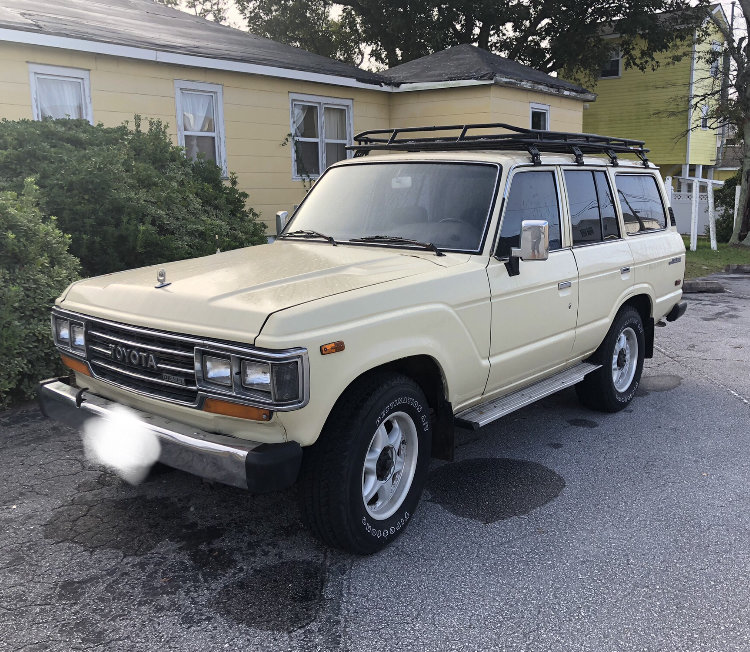

    Been for sale near me for a while. Owner wants way too much.

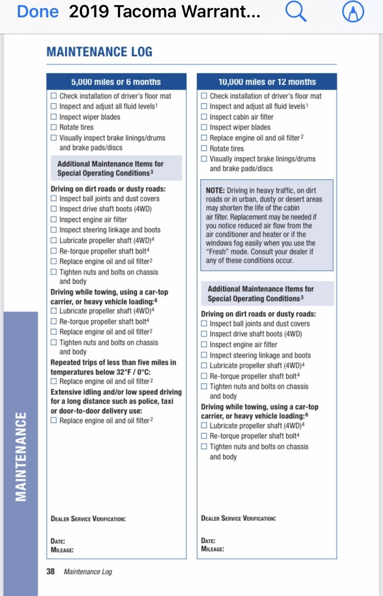

    True Ken, lots of different thoughts on OCI. But Im not sure there is one definitive answer that fits all. Posts that say change it every 10k miles per the manual aren’t accurate either. The manual lists some conditions that warrant a 5k or 6 month interval, and 10k or 12 months for other conditions that do not meet the 5k/6mo interval guidance. Maybe this will help the OP or others, its from my 2019 Tacoma Warranty and Maintenance Guide:
    Many of us will realize our driving conditions vary, some under the 5k/6mo listing, some under the 10k/12mo listing. So maybe the guy who posted on an oil thread in humor that he was gonna split the difference and change his oil at 7500 miles had it right after all lol.
