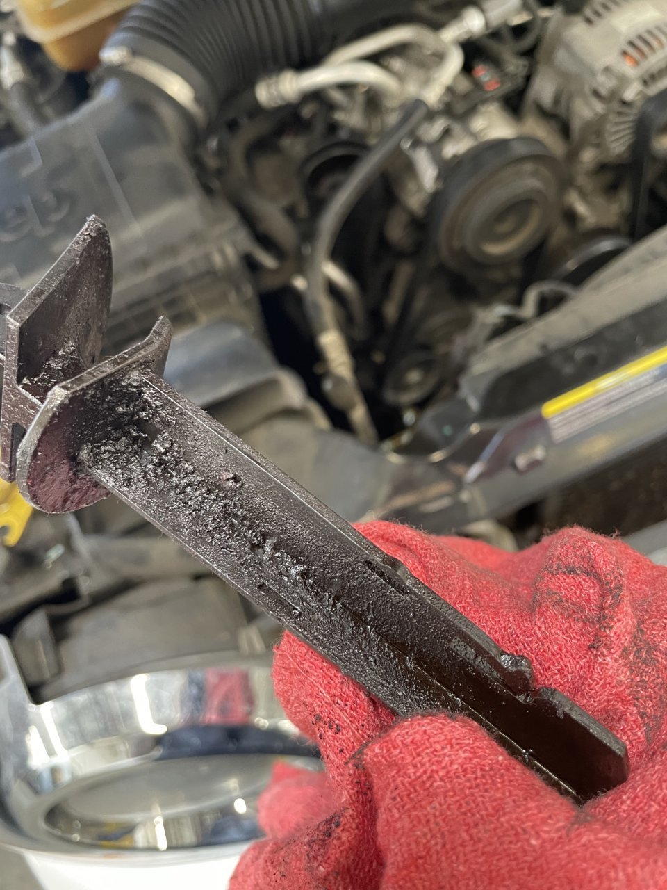

    Err...That's not a compass. That's a Liberty. And it's been well known that this little baffle piece sludges up with lots of short drives and lots of cold starts.
    I'm not making an argument here one way or another...but this literally has nothing to do with an oil change. If that little baffle isn't wiped off in some miles, it's going to look like that. Mine looked like that all the time - I just had to wipe it off every now and again.

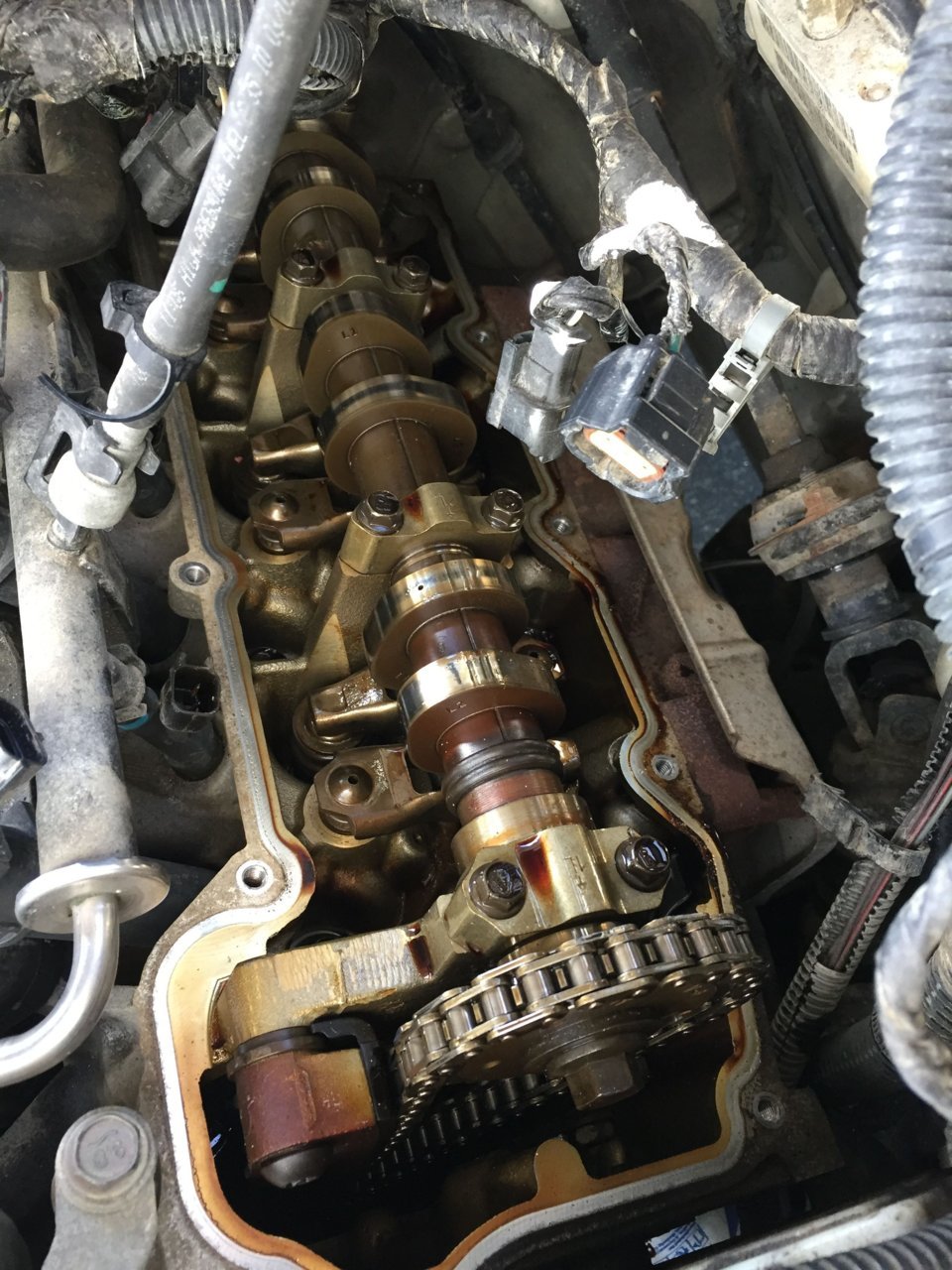

    Here is what under the valve cover of a 3.7L looks like with 3-5k OCIs. Mileage probably around the 130k mark. No sludge, just a bit of varnish. Lobes look worn (high miles) but no scratches.
    Edit: might as well add another picture a couple of years later. Mileage maybe 160k? Looks the same.

    You are correct it was a liberty. That was my mistake. Like I said take it all with a grain of salt and do what you think is best. I’m just sharing some of my experiences in my day too day and why I do what I do. You guys should do what you do based on your own knowledge and experience.
