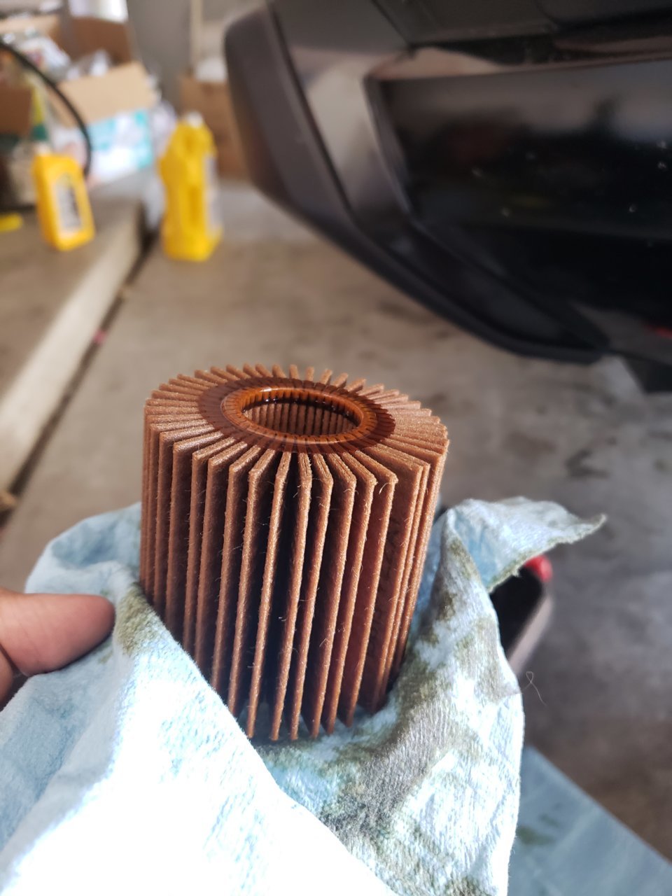

    My oil filter at 5k ish. I'm sticking to 5k going forward, every time the maintenance required light comes on basically. 20230625_125747.jpg

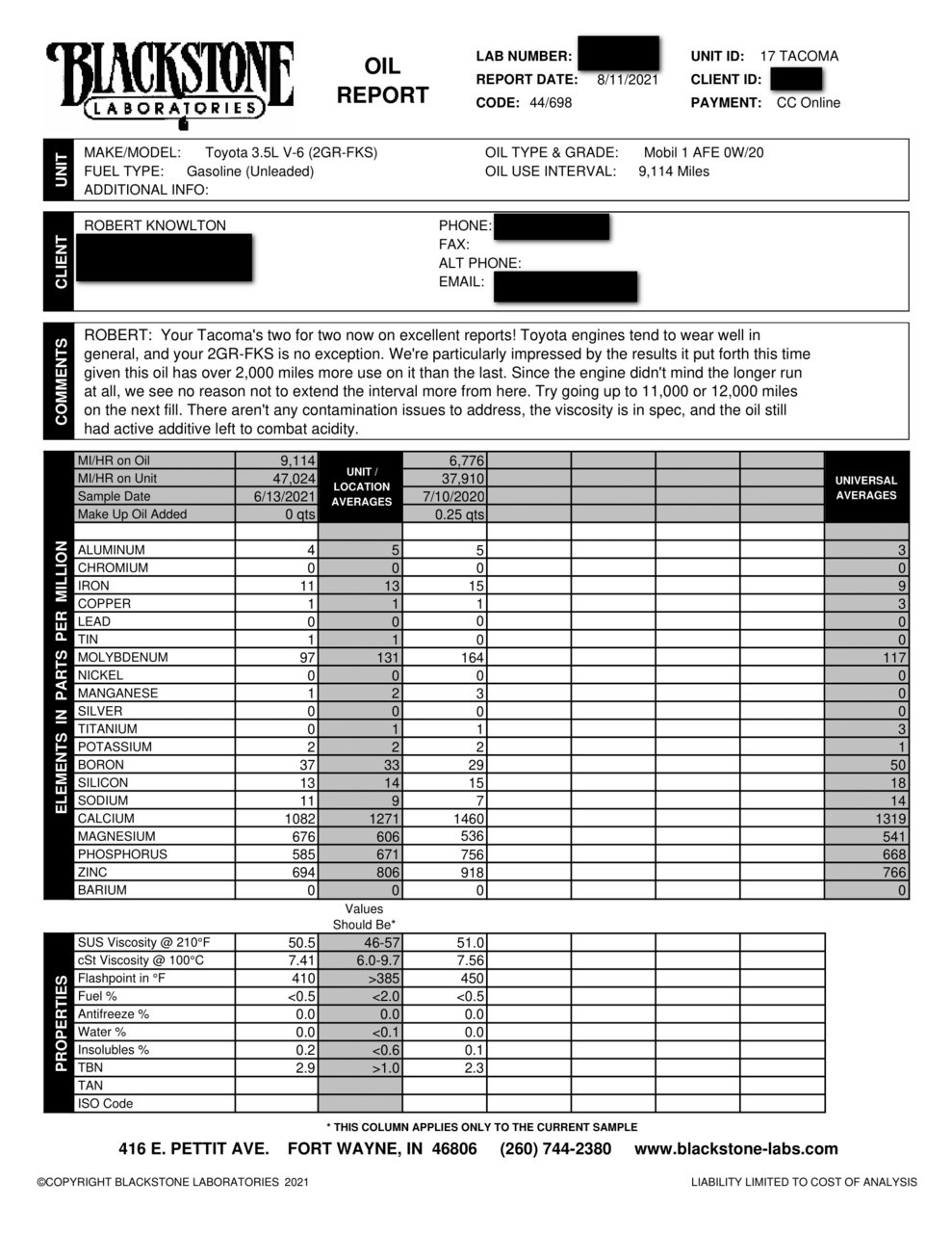

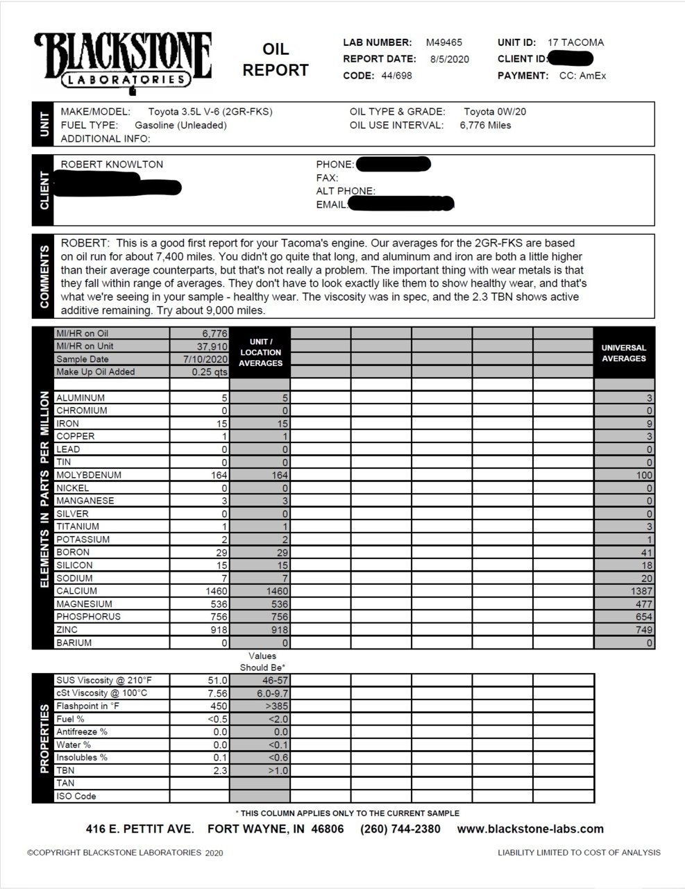

    10K works just fine for me in temp ranges from -10F to +95F, lots of trailer towing (~4,000 lb), and offroad use. I use Mobil 1 0W-20 Advanced Fuel Economy and a Fram XG9972 Ultra synthetic filter.

    Because if men are going to argue about anything, it's going to be about oil and oil change intervals. :)
    "Severe duty" describes the typical driver nowadays. Auto manufacturers give OCIs based on certain criteria with the intent of having a very healthy safety margin built in. They don't count on customers performing used oil analyses.
    UOAs indicate that modern oils are more than trustworthy up to 10K in this truck for the typical user. Owners who confirm this have full confidence in 10K OCIs. It reduces oil changes by 50%. Sure, that's only $35 and one's own time, but hey, if I know for sure that I don't have to do it at 5K, then why do it at 5K? If one does not have that confidence or lacks UOAs or doesn't trust someone else's UOAs, then he can stick with "severe duty" 5K OCIs and be confident that he is changing the oil WELL within the safety margin.

    Why "yikes"? Does something in the UOA (or in the 4 UOAs with this same filter in my Rav4) seem concerning to you? Hint: Take a look at the "insolubles" rating. That's what's left in the oil that the filter didn't pick up. I can show you the magnetic drain plug from both vehicles, too. We can then compare the datapoints with UOAs and magnetic drain plugs from others who are using ostensibly "good" filters to see if I should be concerned.
