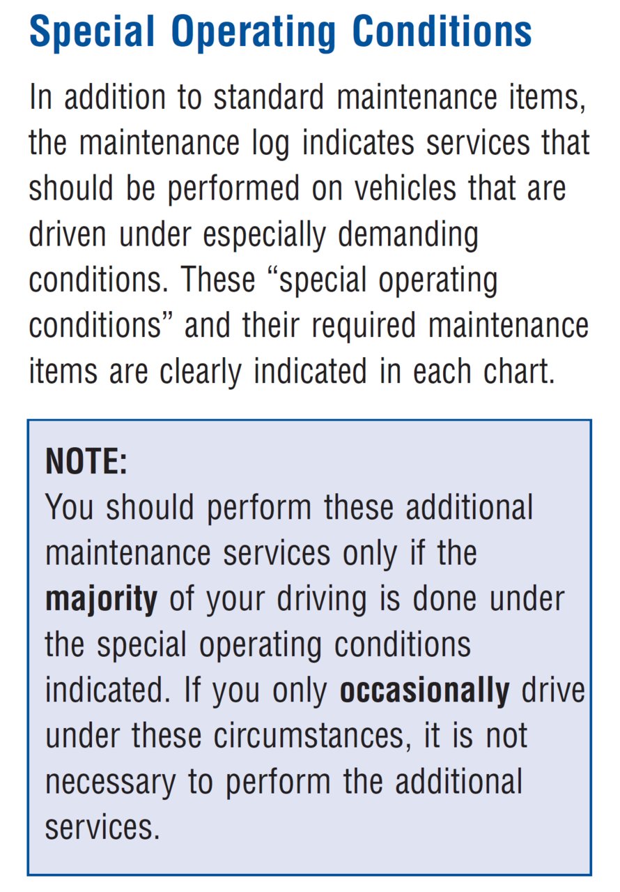

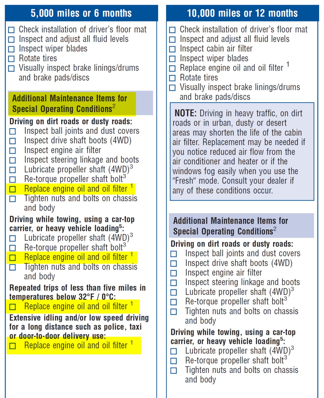

    No, it's not an ad. It's just a web version of the maintenance interval chart from the Warranty & Maintenance Guide that comes with this vehicle (https://www.toyota.com/owners/resources/warranty-owners-manuals.tacoma.2017). Toyota is the author of "Special Operating Conditions" or "severe duty schedule" for this vehicle. By listing what those conditions are, we can all refer to the author of the criteria rather than guessing.

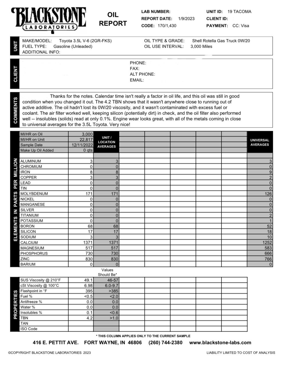

  8. Jun 27, 2023 at 7:43 AM
    #648
    goingplacesanddoingstuff
    goingplacesanddoingstuff Well-Known Member
    Jul 31, 2020
    #336240
    784
    2019 TRD Off Road
    2.5” OME lift, Koenig Six Shooter wheels, 275/70r17 Nokian Outpost AT, CMC, Nitro 4.88s, Greenlane aluminum sliders, CBI aluminum skid, Greenlane aluminum front bumper, Out Gear Solutions HC rear bumper, Baja SAE fogs
    This was after 15 months and 3k miles. Truck was used on an overland trip in Utah with plenty of off road. The oil was fine.
