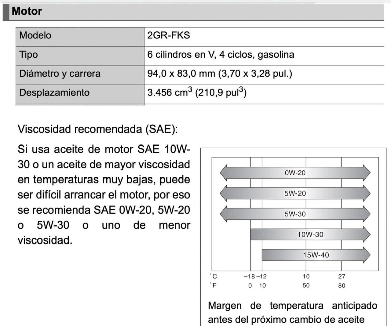

    this is not correct, 0w-20 is US only. The engine is rated up to 15w-40 outside the US. Welcome to the world of CAFE.

    excellent report, Amsoil is fantastic oil. I’m sure this plays a role.
