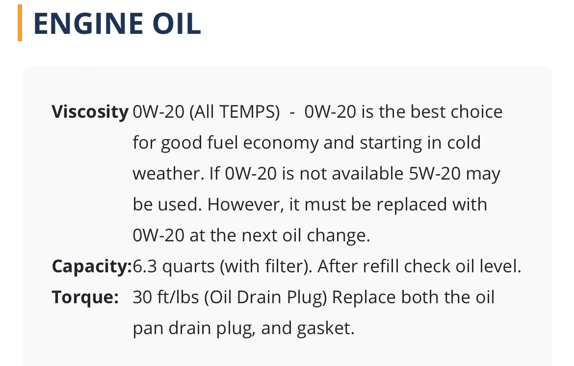

    Another incorrect fact. Where do you pull this info? The 3.5 is approved to work with 0w20 all the way to 15w40...
    Other than the block most internal metals are the same....
    The same 4.0 has called for 5w30 for 15 years. Put the same engine in the new 4runner and now it calls for 0w20. It's all about the MPGs.

    Incorrect, 0w-20 is mpg based / CAFE and nothing to do with engine design.
