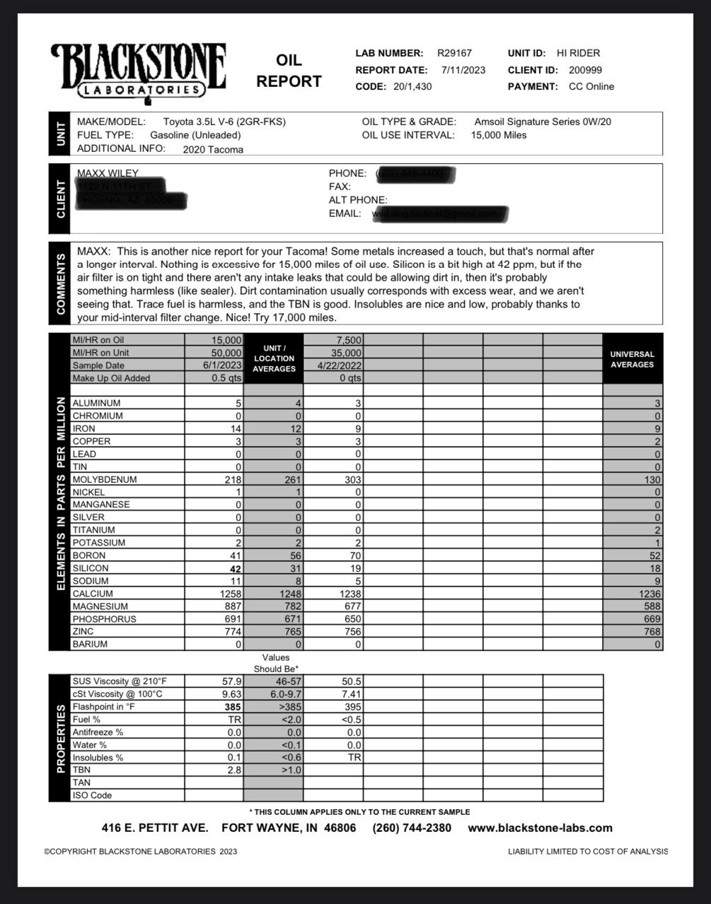

    In before all the “scamsoil” shitposts lol. It’s amazing how people can ignore the data that does indeed show that Amsoil is damn good. Sure there are other great oils, but this is very impressive overall. TBN of 2.8 is a little too close for comfort for me, personally. I wouldn’t go farther.
    Also changing the filter is the most annoying part of the job, so it’s not a huge deal to change the oil while you’re down there.

    Fuel will only build up if the truck is driven short distances and not given an opportunity to get up to normal operating temperatures. Once the engine is up to temp and being driven, any fuel in the oil is going to be vaporized and pushed out of the system into the intake.
    Not allowing the engine to get up to temp is what kills oil and engines faster than anything.
    If that’s your driving habit, then you do need to change your oil more regularly. My engine sees long drives and heavy load which keeps internal components free of deposits and carbon buildup.
