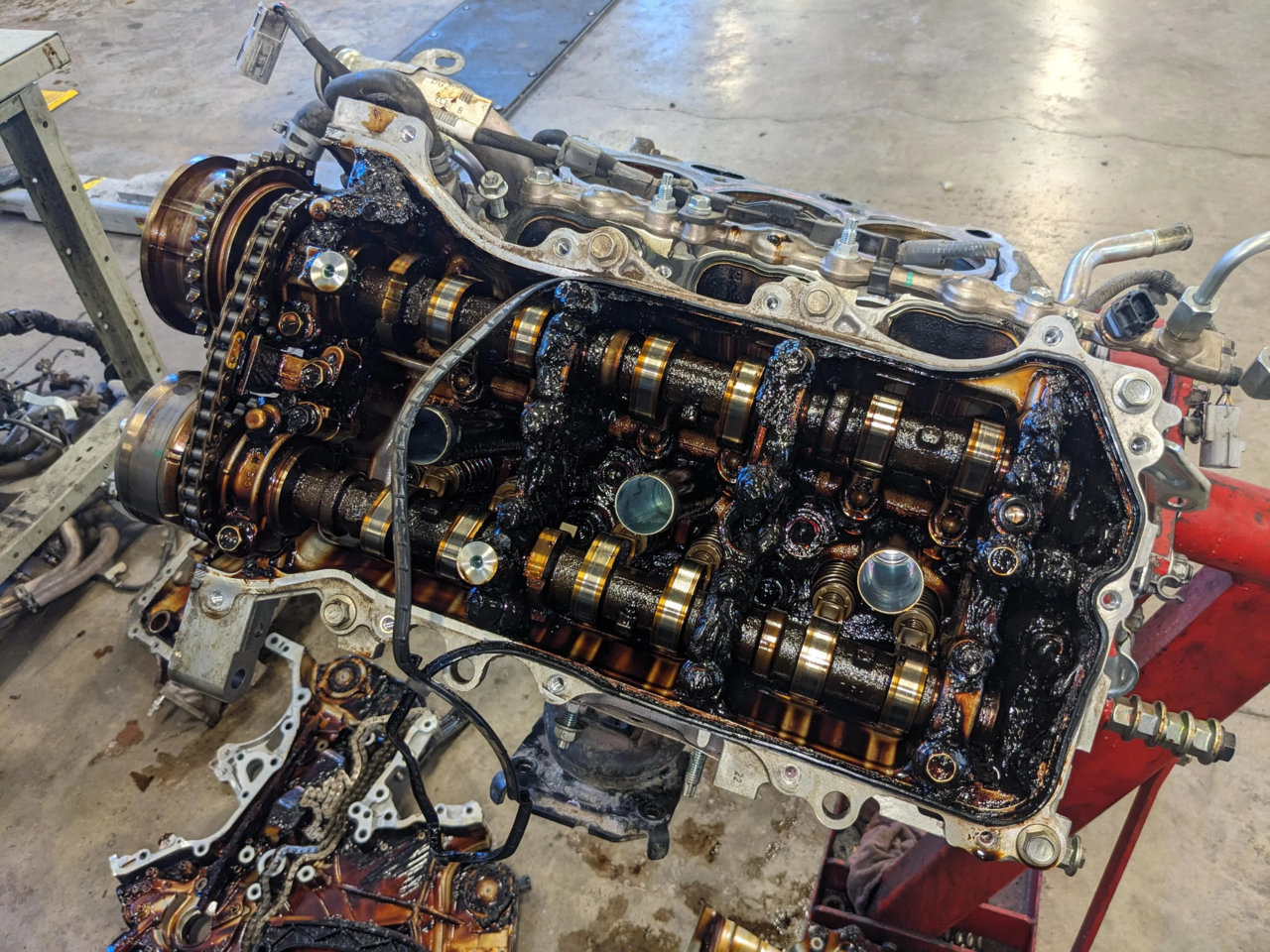

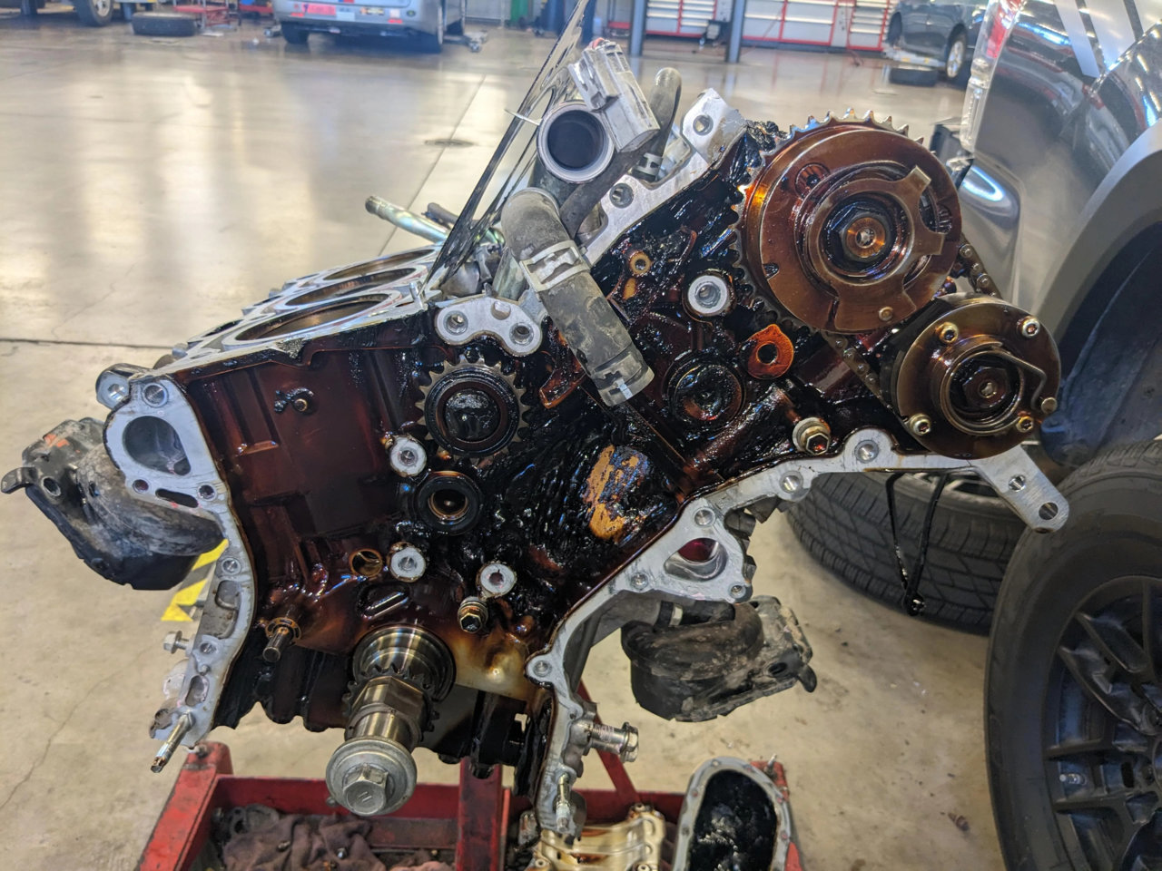

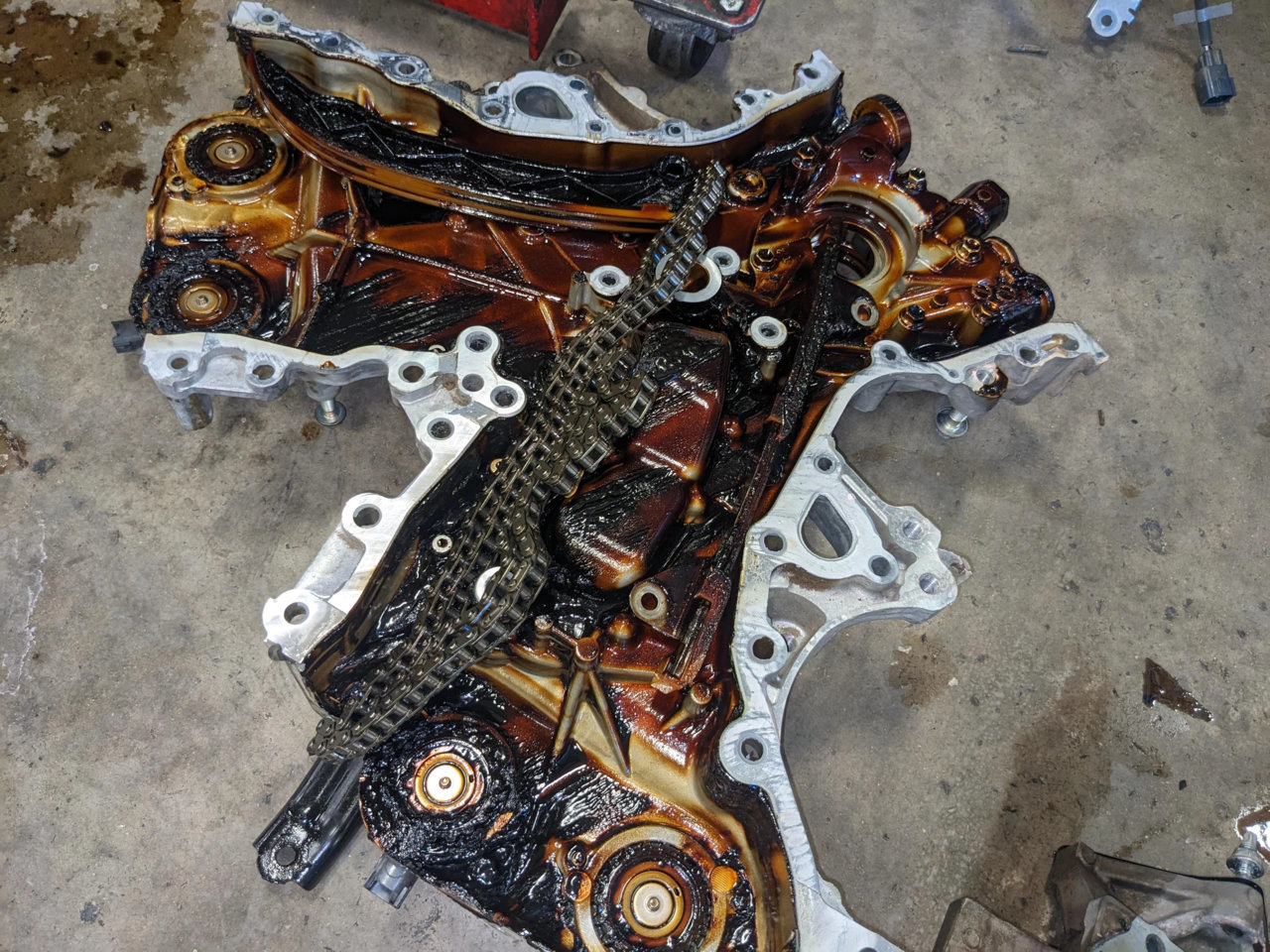

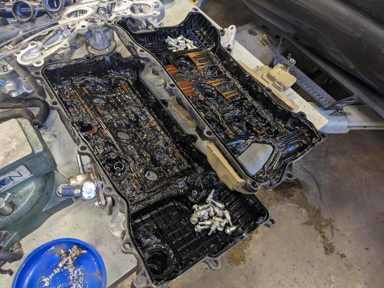

    2020 Tacoma rolled into the shop and "consumed excessive oil at 70K miles."
    https://www.reddit.com/r/Justrolled...eeds_to_add_4_gallons_of_oil_between_service/
    He couldn't produce records, as "oil changed at independent shops."
    Hmm, 14 oil and filter changes vs new engine (guessing short block and labor for $8000). Your choice.
    Me, every 5,000 miles with Toyota Engine Oil (keep your receipt, not mileage and date in pen on receipt) and OEM Filter (I buy four at a time)
    Cheap insurance.
    NOTE: I suspect the owner did 20,000-mile oil changes with cheap oil. Boy, that looks nasty for 70,000 miles.
    Teardown showed one nasty mess.

    I've seen that picture a few times now floating around. Somebody never changed their oil....ever. Who knows what even type of oil was used.

    That’s an extreme case but likely from using non-synthetic and going way too long between changes. You don’t get that kind of sludge build up with 100% synthetics.
    I worked as a lube tech when I was much younger man and most places don’t really give a shit or looks at what grade oil most vehicles call for. It’s an in and out kind of business. Most don’t even use synthetic unless you specifically ask for it. They also typically use bulk 55 gal drums of oil from the lowest bidder.
    If you use good synthetic oil, you can go longer OCI without any long term issues like what is seen in this failed motor.

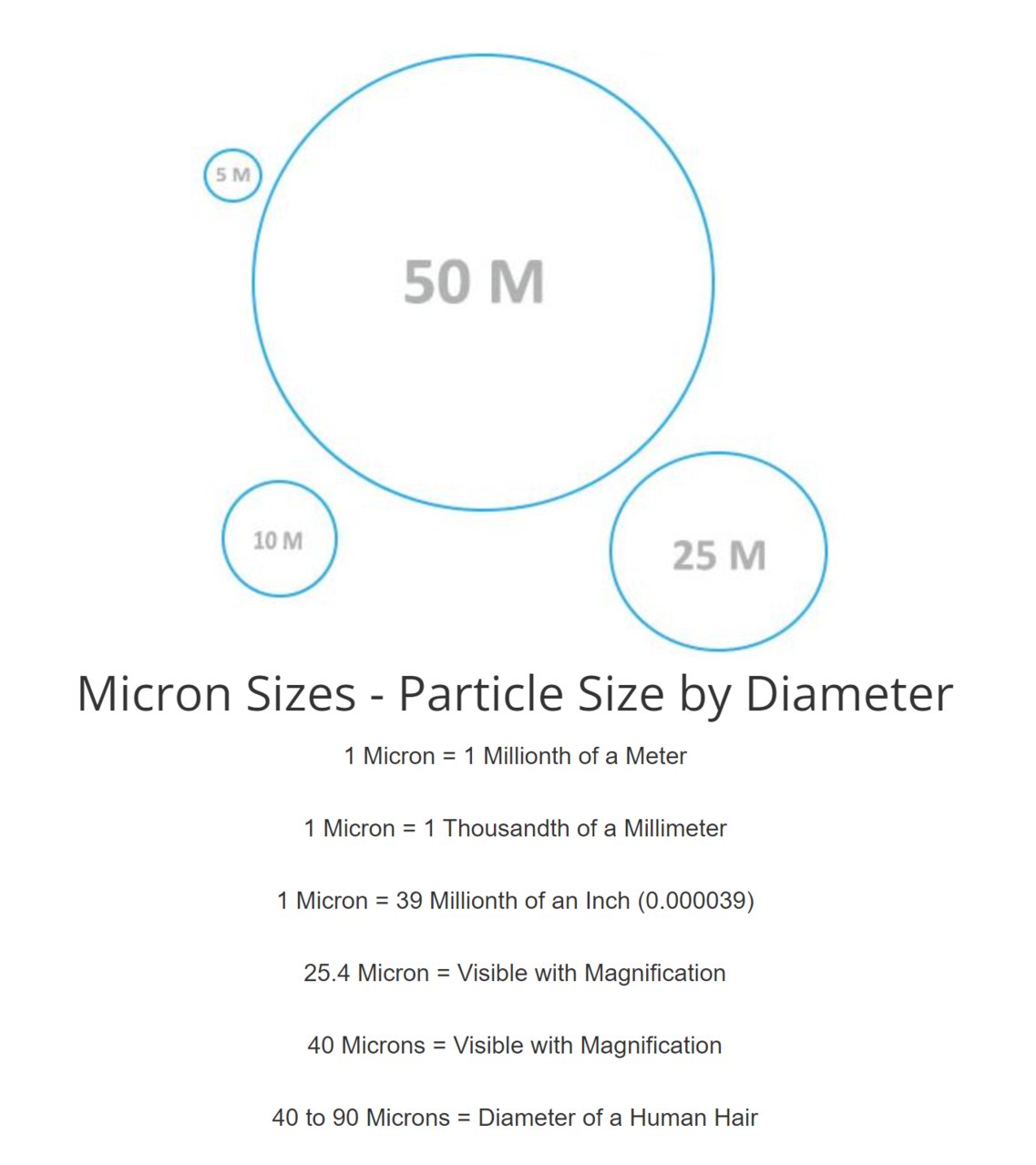

    Weird. How do all of those "little shavings of metal from the engine breaking in" -- if they even exist -- manage to get through a 20-micron oil filter? 20 microns, by the way, is about the size of a single skin cell.
    These modern motors don't need "break-in oil changes". That's old advice for outdated motors and outdated lubricants. I demonstrated that way back in 2013 with multiple UOAs on a brand new Rav4.

    You dont have to be a master tech to see that this customer didnt change his oil out that often

    Often? From the looks at 70k miles, maybe once if that.
