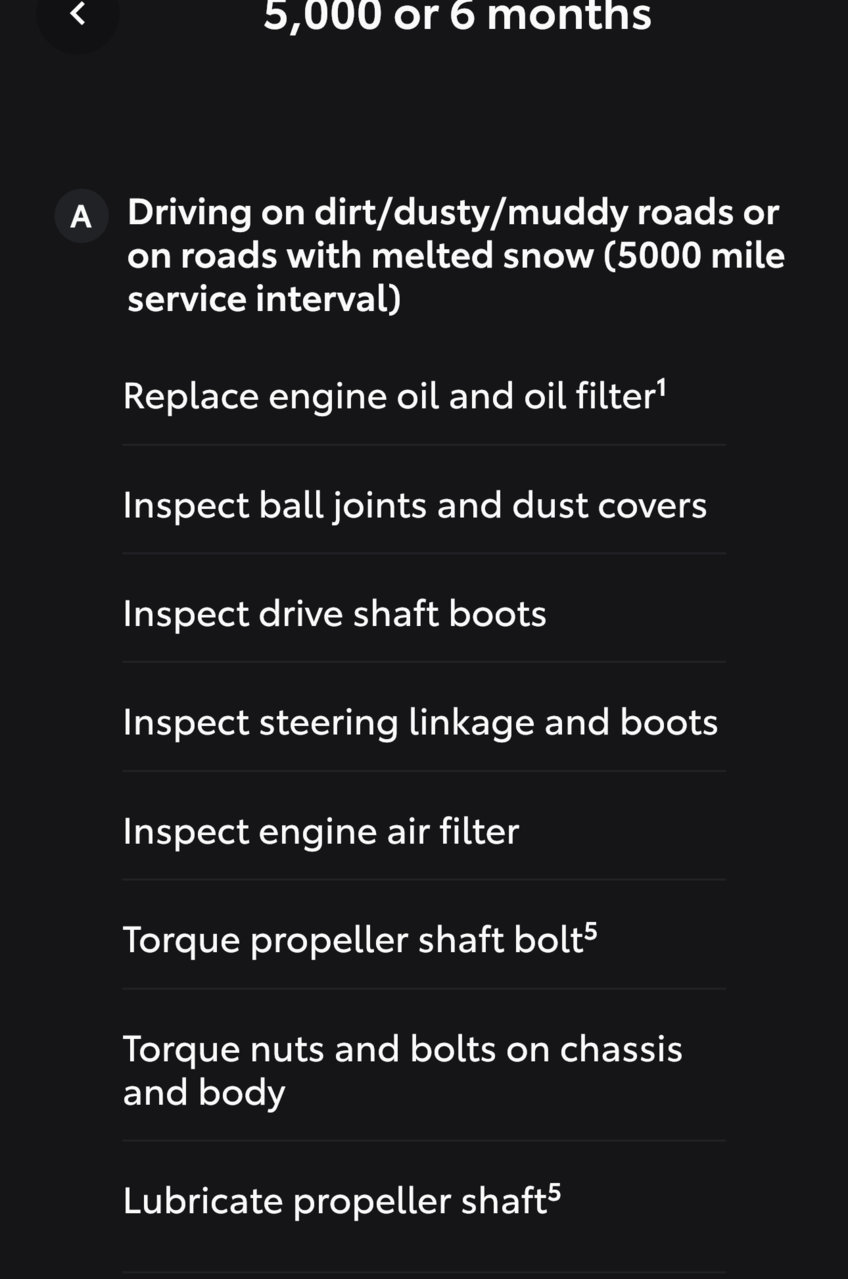

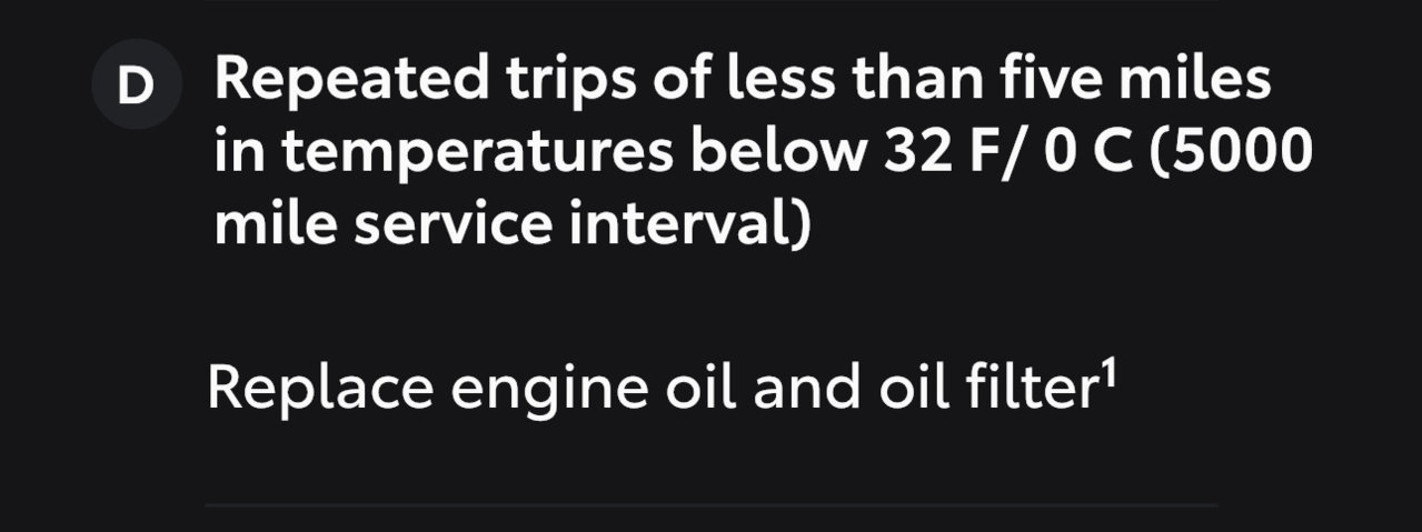

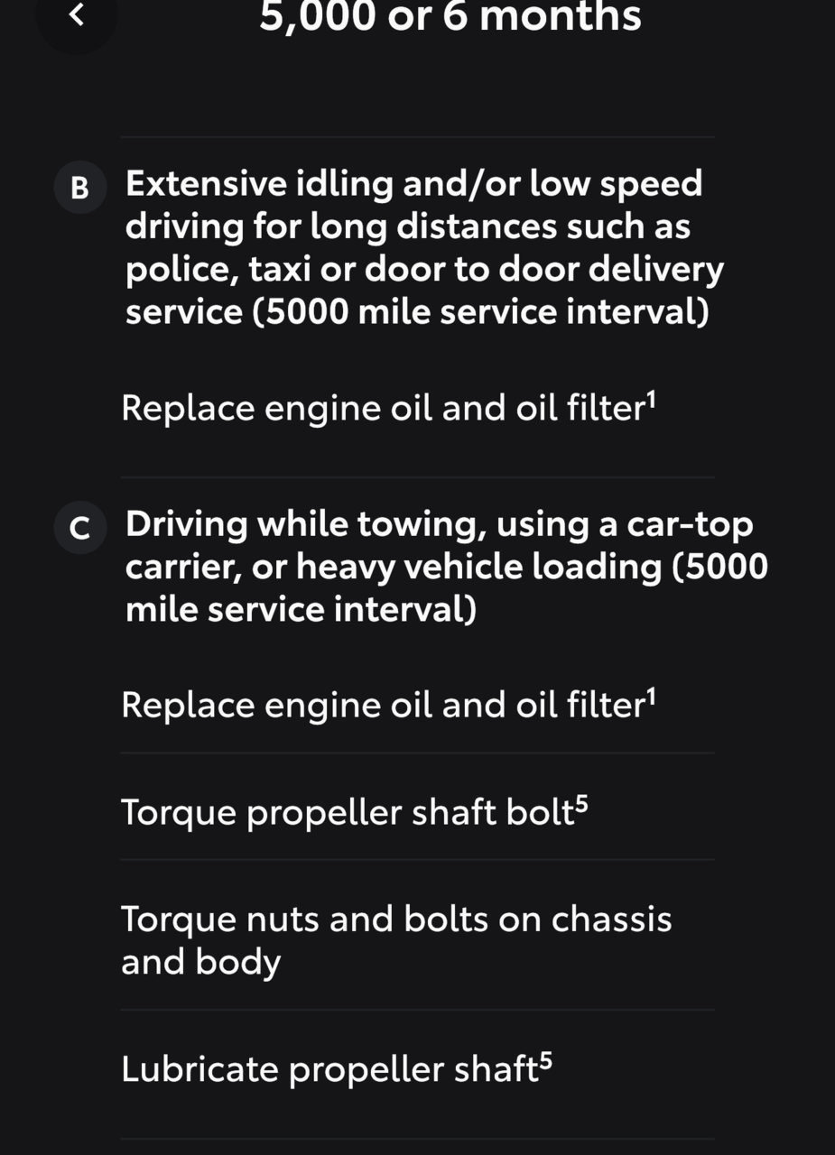

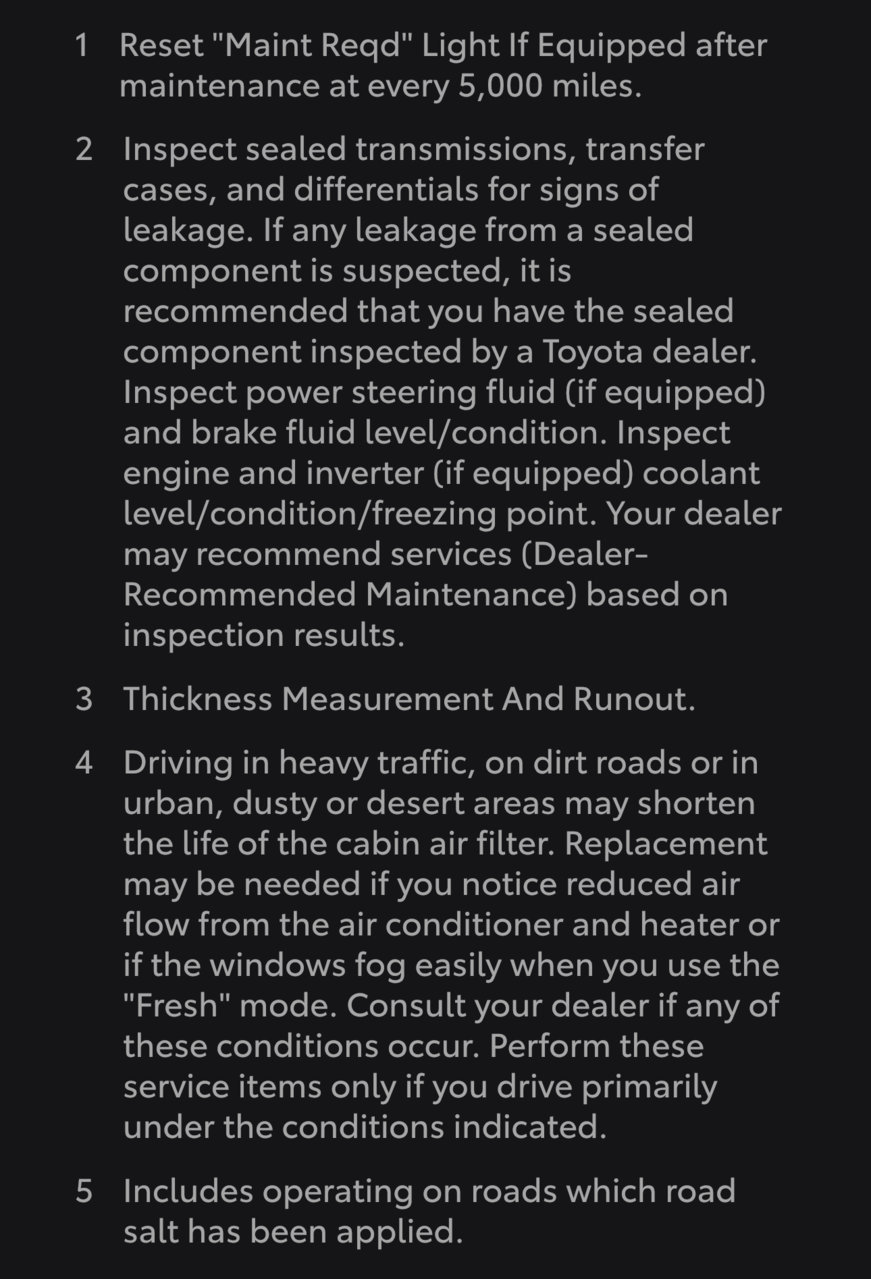

    Toyota recommendations for 5k service intervals on the Tacoma.

    so they expect us to drop the driveshaft and lubricate it every 5000 miles? why didn't they just give us some zerks?

    Correct but all those listed come under severe use. Its 10k for the rest of us that aren't in that category.

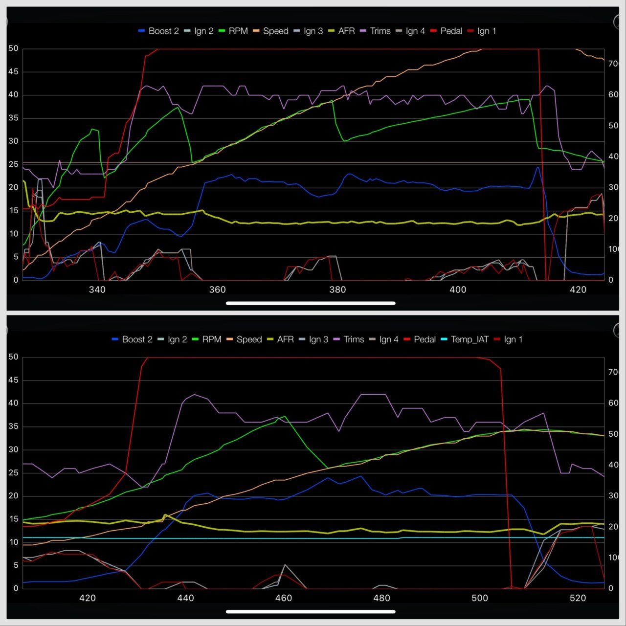

    I wish I could hook up a JB4 to the Tacoma, but they only do turbo engines. We also own a Tucson Hybrid, kind of wish we went with the Highlander HEV, but this one was $20k less. As you know, Hyundai / Kia are not known for their engine longevity and I have done a number of things to try to keep this little guy running in tip-top shape. Example of my logging and looking at fuel trims, timing, boost, and AFR. Top is e20 bottom is 93. It’s has a little 1.6t engine with a small electric motor. It’s actually pretty fun to drive pushing 6 lbs over stock. It’s by no means fast but for a small SUV it zooms around pretty quick. Whoops the Tacomas butt… lol. Trying to keep her from consuming oil as long as I can.
