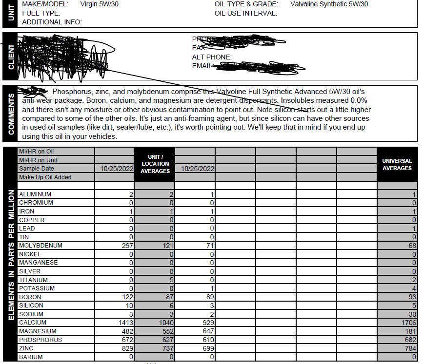

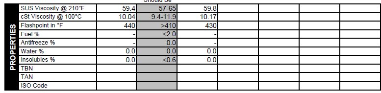

    Sucked into this thread unfortunately. Yes, would take UOA to determine what is best. But there is also anecdotal evidence and professional anecdotal evidence (from trustworthy technicians). I try to cross-reference the two. I trust the Toyota engineers but they are not the ones in charge. Marketing and sales are.
    Anyway, I am thinking that Valvoline 5W-30 may be a good route at a 6-7K interval. Here is a VOA I ran:
