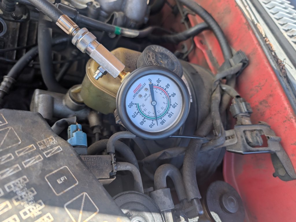

    I still have a check engine light for P0304, cylinder four misfire. Truck runs rough, idles rough, accelerates poorly. The last time I took it on the highway to get into 5th gear, the check engine light flashed.
    I think the culprit was bad gas but not sure.
    Things Ive done:
    --Replaced coils and spark plugs
    --Switched coil wires to see if I had a bad wire
    --Changed oil
    --Fuel cleaner x2
    --New fresh fuel I trust
    --Replaced the MAF sensor
    Today, I was able to get a long screwdriver on the fuel injectors. All seem to be firing the same so I no longer think that it is the fuel injectors.
    The only thing I haven't tried (which I will today) is changing the fuel filter which could be the culprit.
    Anything else I should try?

    What's the compression on cyl4?

    If you want to for sure rule out the injectors, swap them around and see if the misfire code follows. I know it’s not a super easy job to swap them, but it’s not that bad either. And it will tell you for sure if it’s the injectors.

    Since the 5VZ is a waste spark system. I doubt its spark. But never hurts to do a visual check.
    Just because the injectors sounds like its firing, doesn’t mean it is. Or that it is spraying correctly.
    First thing I’d do is a compression check as the previous poster suggested.

    How is your coolant level? If it’s low you could be leaking coolant into the cylinder. That was my issue 2 years ago.

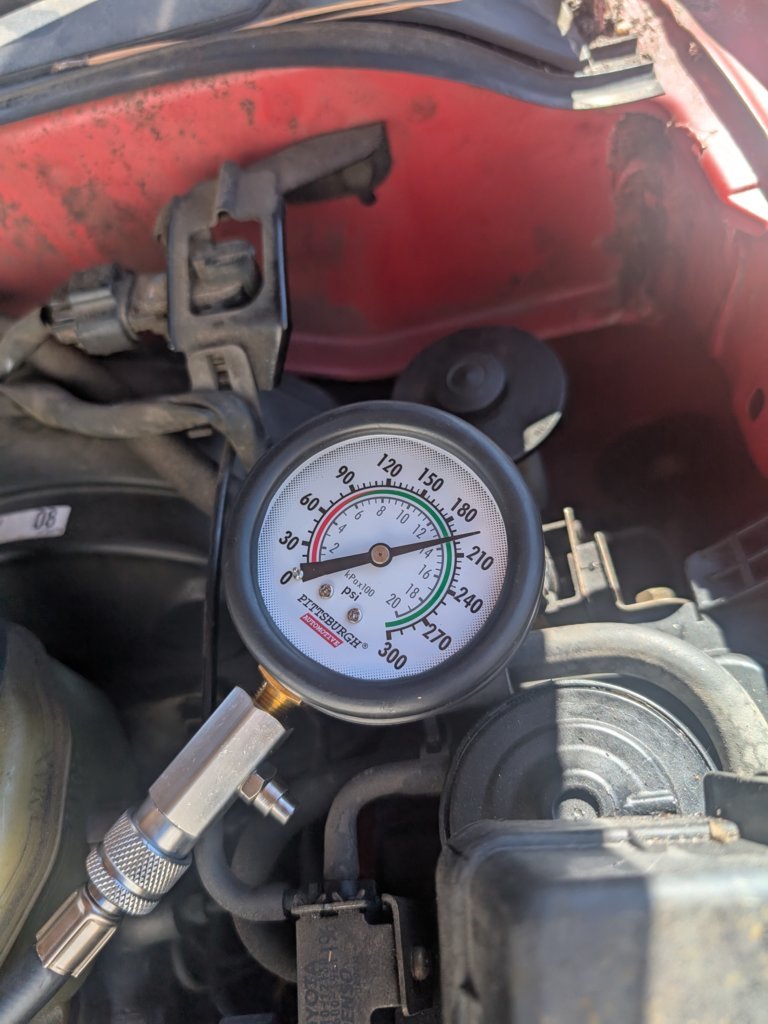

    I tested the compressor and cylinder 4 seems to be in line with the rest of them.
    I will test the engine coolant level but I doubt that is the issue. But, I'll do that before I take it apart to test the injectors.

    You can have good compression and still be leaking coolant. I was in the 180s on all 6 cylinders and was still losing coolant. Just check your resivor real quick it’s right there.

    200

    Last test I would recommend is a leak down
