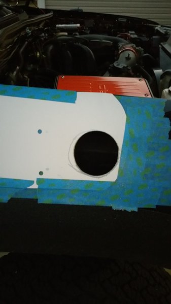

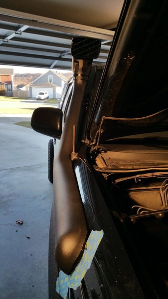

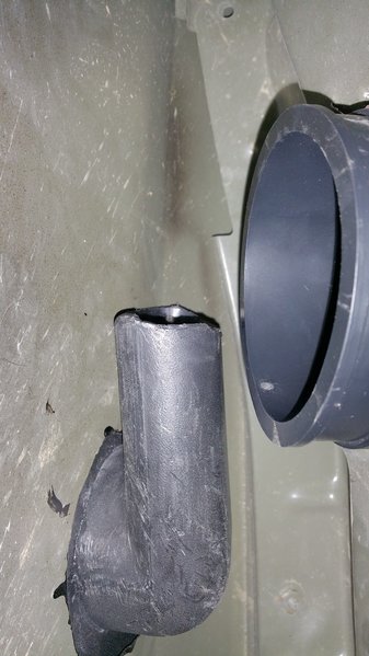

    11/21/2015 Update
    I bought a Chinese knock off of the ARB snorkel from Ebay as several others have done (technically it was a Christmas present from my wife) and got to install it today.
    My original plan was to plumb it into my TRD CAI, but unfortunately it didn't work out as I hoped. The snorkel tubing came in too high through the engine bay and I couldn't get it to line up with my CAI. So I'm currently in the process of trading my CAI for a stock intake, and then I'll get some pipe bent to finish the job like everyone else has.
    But I got the snorkel installed fine otherwise. Here's some pictures. Had to do a fair amount of cutting and widening holes, but sadly, getting the snorkel on was the easy part... Hoping I had it lined up right was tough, and then fighting to get it to line up with the CAI in vain was difficult.
    This is where the snorkel plumbing came in exactly above the Fernco fitting I wanted to hook it into.

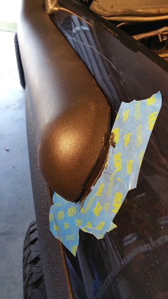

    For the gap at the front I filled it with black silicone. Looks pretty good in person.
    There may be a slight whistle, at least at around 40 mph, but I only heard it cause I was listening and had my stereo off.. Which I never do. So I doubt it'll bother me if there is a whistle.
