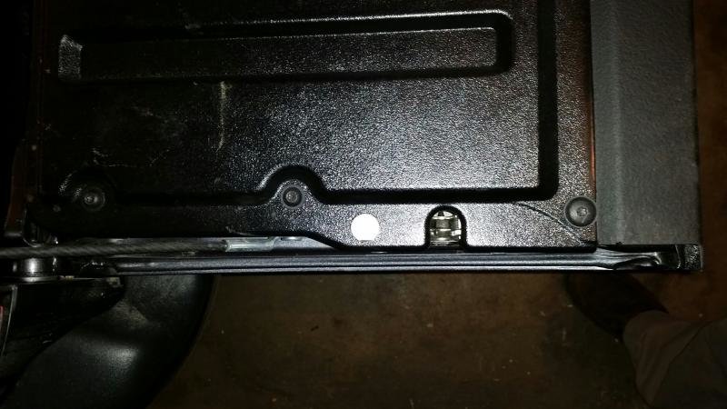

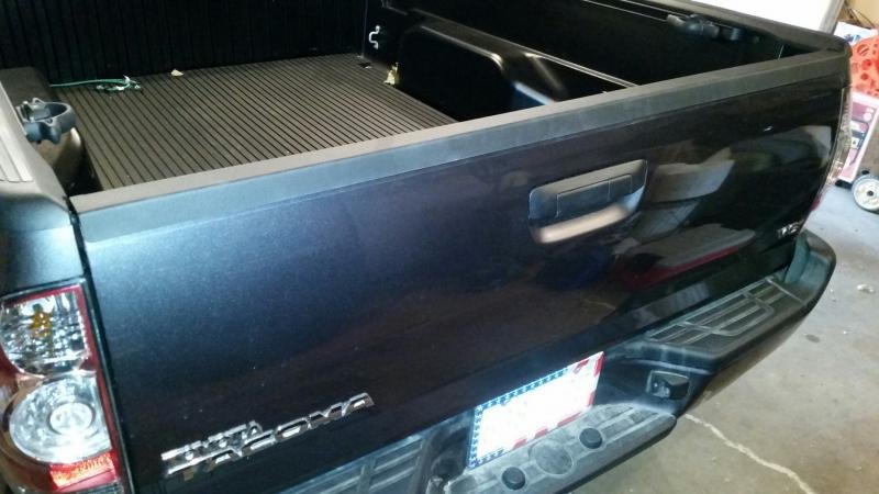

    Just got mine installed this afternoon. Figured I'd add my 2 cents to the thread.
    I used a spray on bed-liner product on just the cap area to give it a black protective coating. About 6 coats worth. You can also see in the pic that I covered the tailgate edge underneath the cap area with a clear protective layer that I had in the garage. I let it stick out about 1/4" to protect the paint from the sharp edge of the cap if they come in contact. Right now there is just enough room in the very middle to fit a single sheet of paper between the tailgate and lip edge.
    I wanted to re-install the plastic liner on the tailgate so instead of grinding down the rubber bumpers a little to allow for the extra thickness, I used a 3/4" spade bit to drill holes in the black liner so the bumper touches the inner aluminum plate instead. Worked great and fits perfectly.
    I bought the re-enforcement plate because I plan to haul a couple dual sport bikes in the bed and I didn't want to taco the tailgate. Now she's stiff as can be and has a much heavier feel to it. Highly recommended.
    I do plan to buy a few of the screws with smaller heads to replace the top row.
