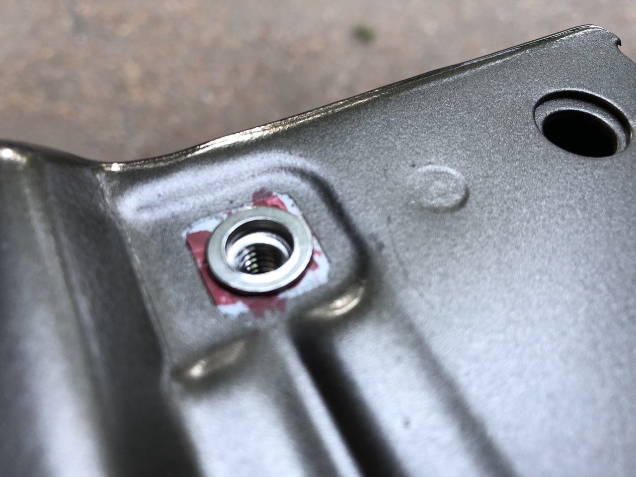

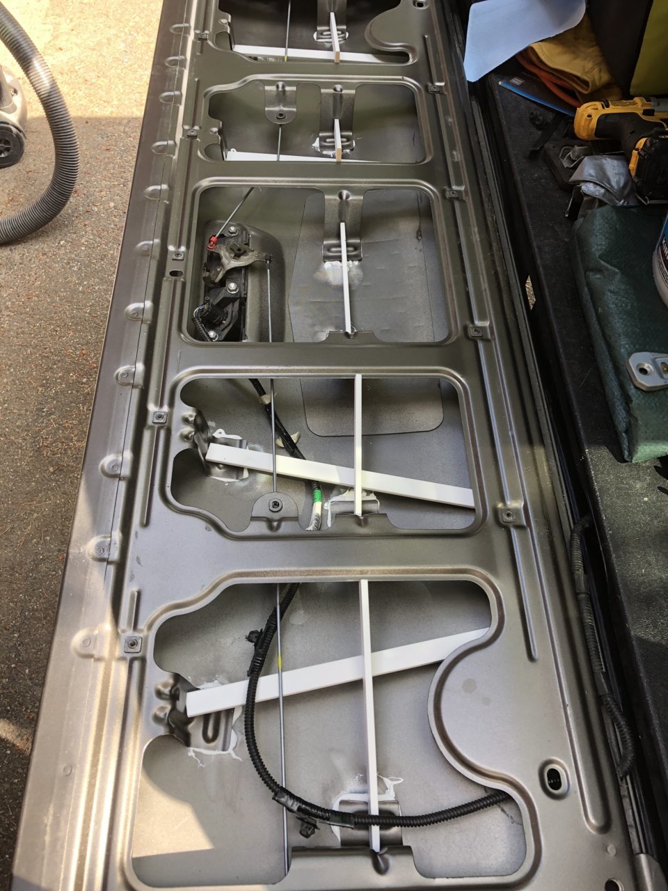

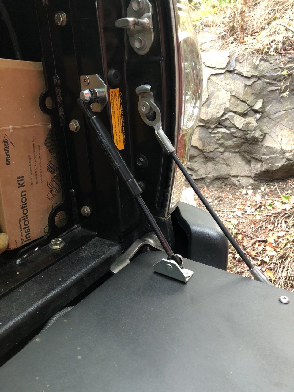

    Added the EZ down with some extra brackets. This way the cable locks don't bind on the strut. I borrowed this idea from @Crom who has one of the most organized build threads.:hattip:
    All but two of my stanchions where unglued. So I made wooden braces to hold the stanchions in place while the marine grade sealant cured.

    For bolts see my post above #161
    I didn’t think reusing the plastic clips and stock screws would be strong enough.
    So I upgraded to rivnuts and stainless button head screws. Also reglue the braces because that helps with rigidity
