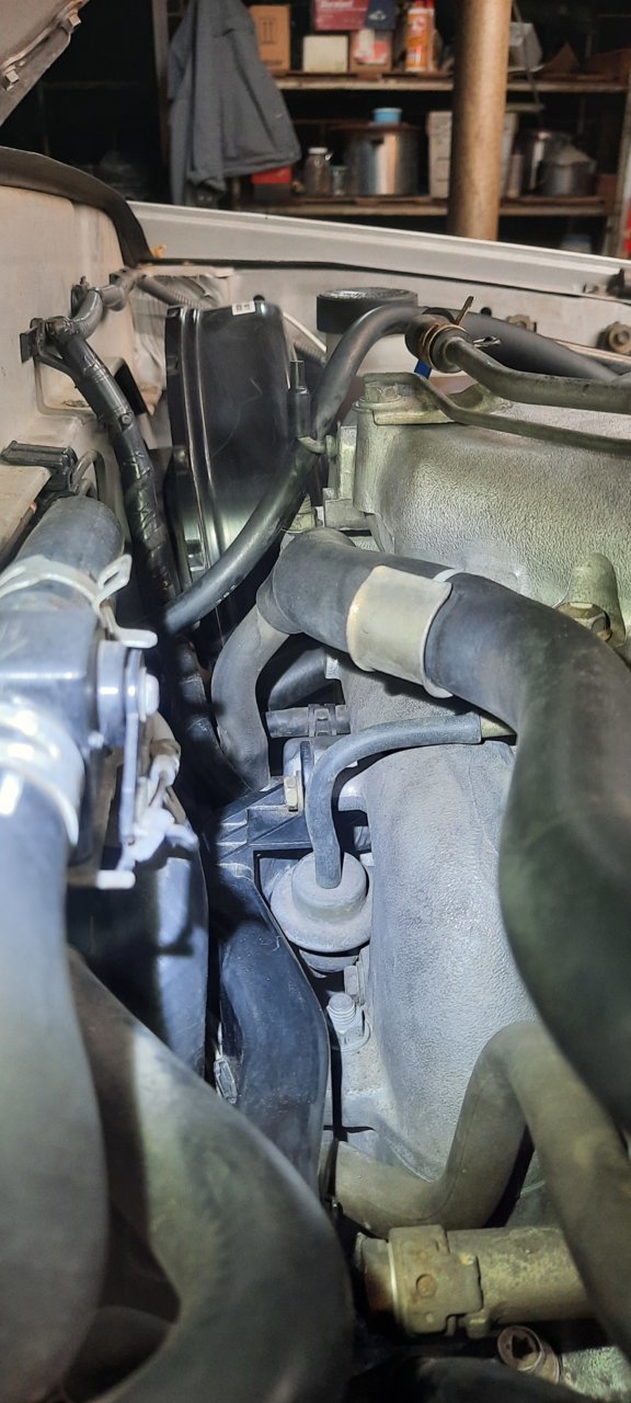

    Just changed alot of stuff and had this code pop. Had the entire intake off to replace knock sensor loom. The little vac hose on the fuel regulator seemed old, swapped; now my fuel trim is back to normal and everything seems fine. Just an idea.

    This little vac hose, top end seemed loose. Maybe it's that simple.
