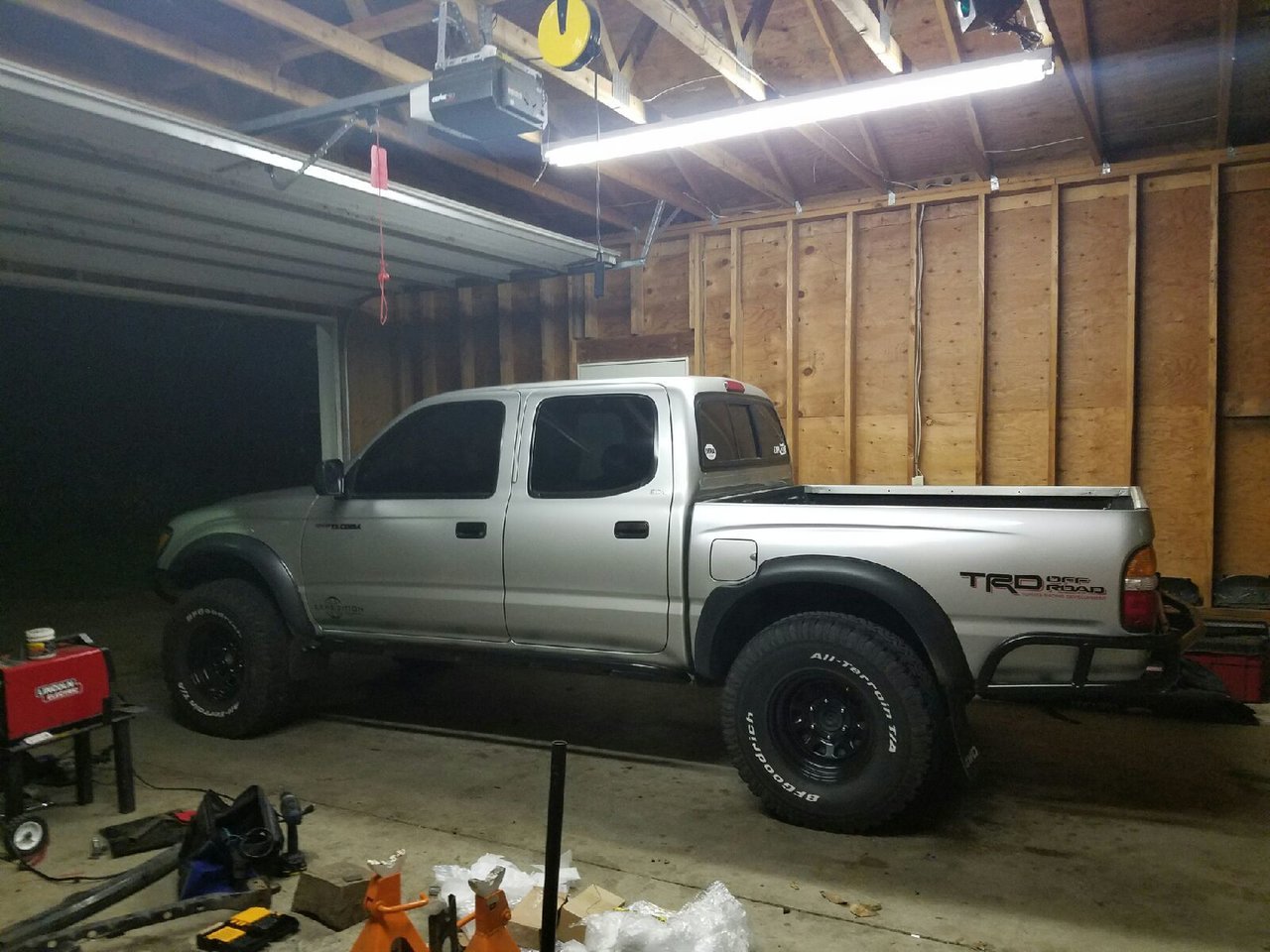

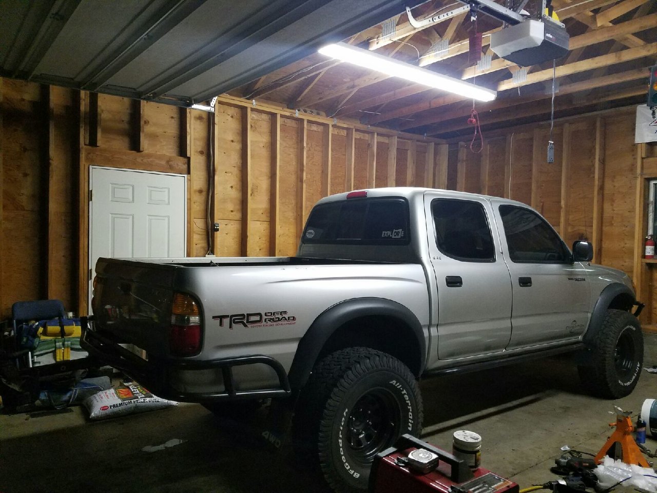

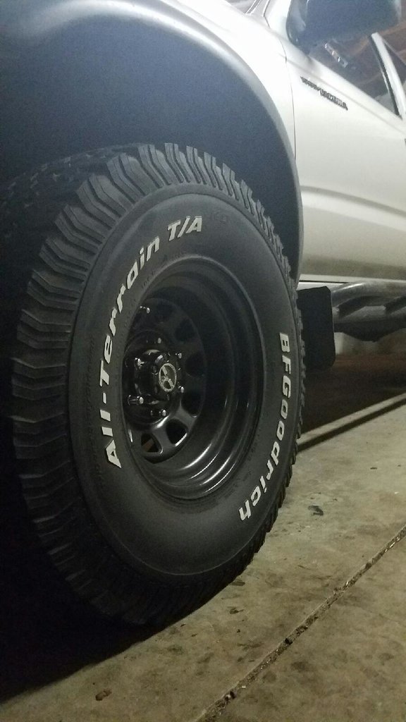

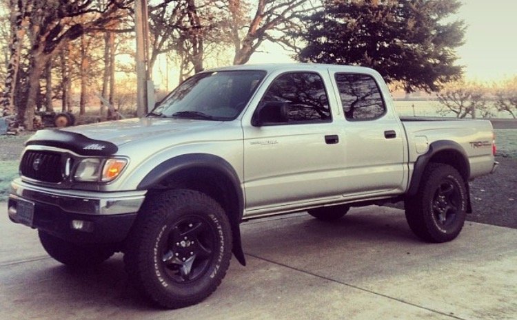

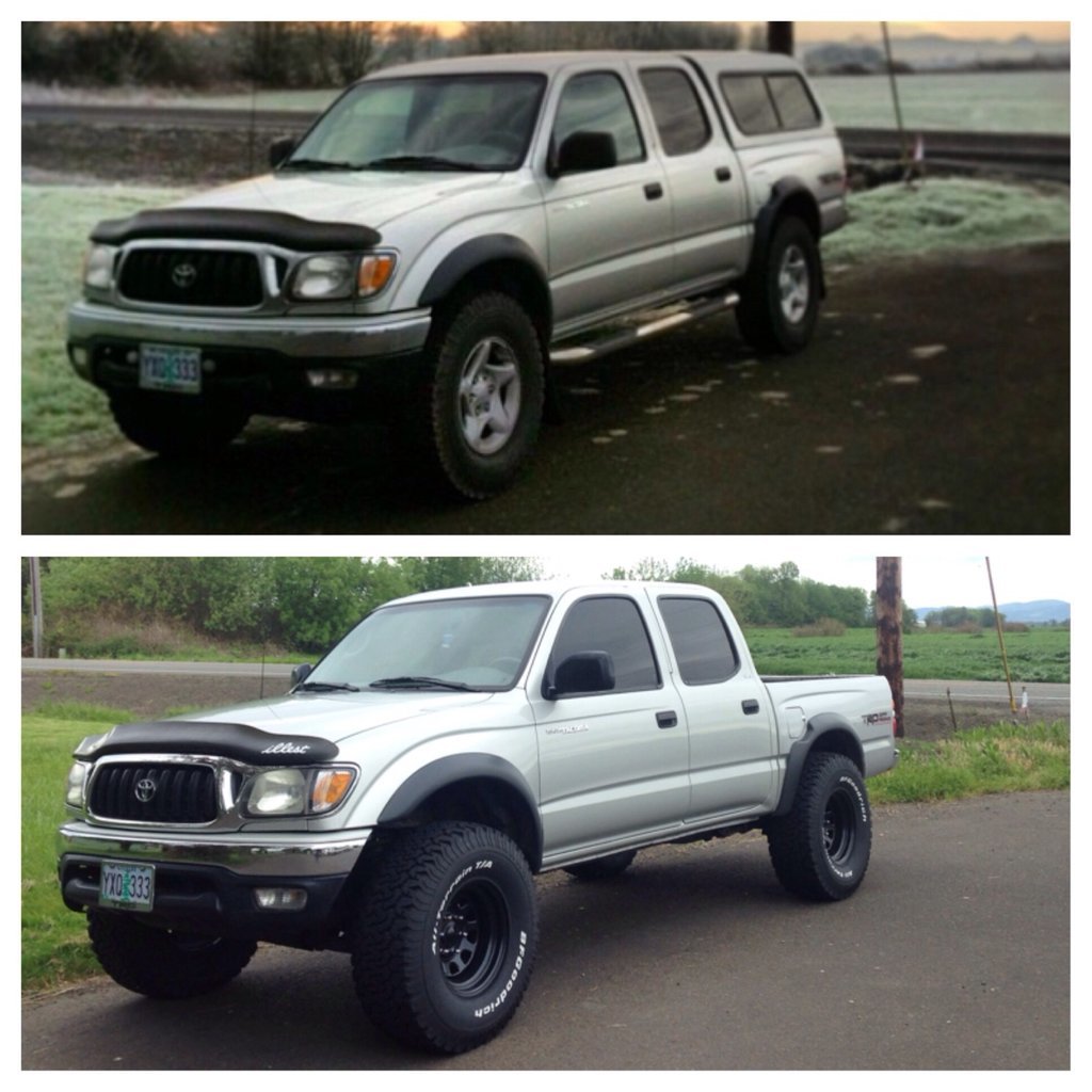

    Installed:
    -Bilstien 5100's F+R
    -15x8 black rock crawler steel wheels
    -33x12.50 BFG A/T's (trimmed bumper and smashed pinch weld to fit)
    -Flowmaster muffler
    -Deckplate mod w/K&N filter
    Before/After and it stayed like this for quite a while.

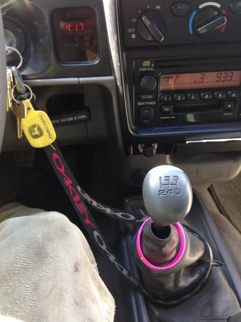

    This had been my dream pickup since they first came out. The only disappointment I had was that Toyota didn't offer a 5spd option. When the auto tranny started slipping on me I started crunching numbers on a 5spd swap. It was slightly beyond my skill level with all the wiring that would need changed. I made a call to Toyonlyswaps and arranged for them to do it for me. After a few days in the shop I was driving home with a dream come true.
    Their work was top notch. You would be hard pressed to tell that its not factory. There was a notable power increase according to the butt dyno and the mpg's also saw a slight increase. Overall extremely pleased with the change.

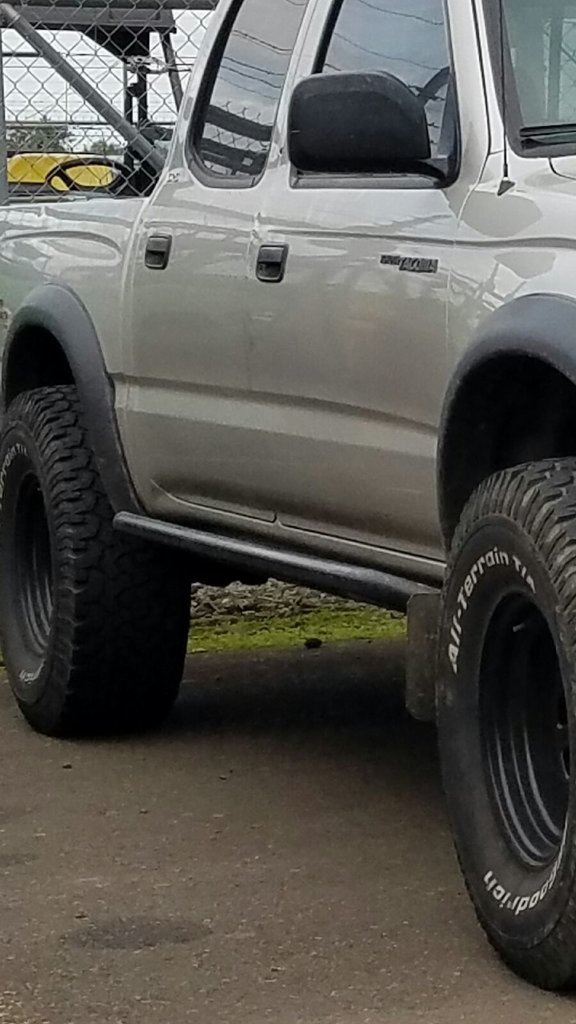

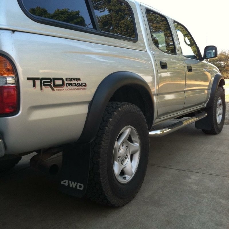

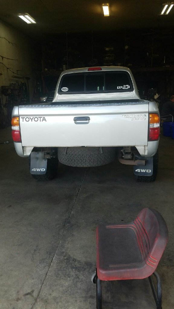

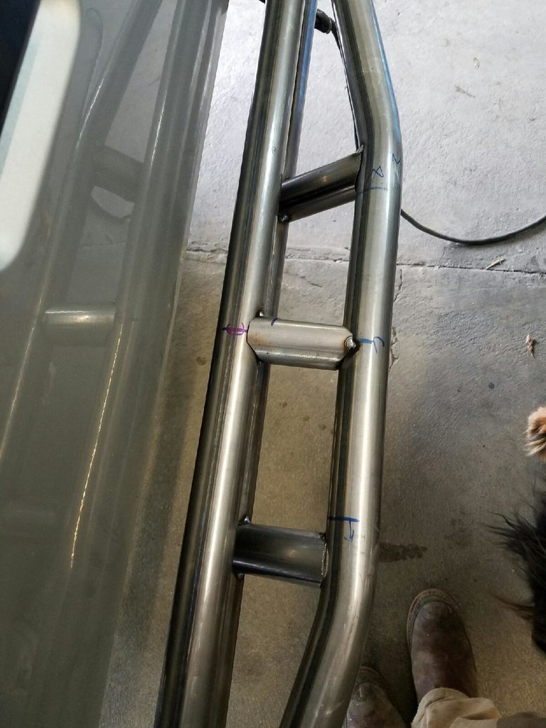

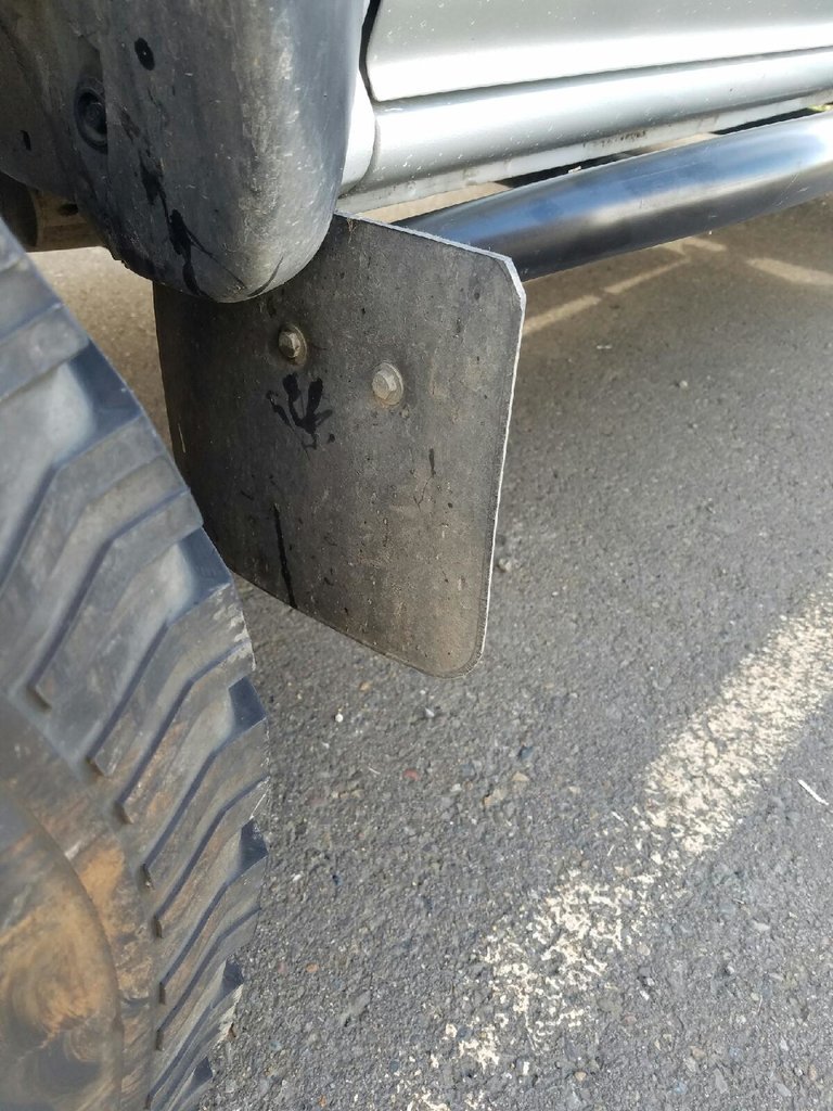

    Next I had my buddy bend me up some sliders. In my experience sliders protect the truck just as much at the mall (people swinging open their doors) as they do on the trail. I didn't want to drill a bunch of holes and swiss cheese the frame so instead I plated the frame and welded the sliders with / angle gussets to the frame plates.

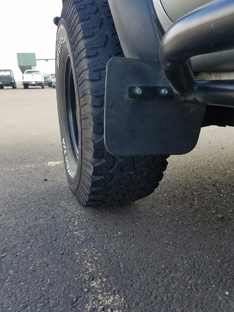

    Fitting 33's meant I had to previously remove the front factory mud flaps. Even with the fender flares the tires sprayed crap all over the side of the truck. With the sliders on I was able to fab up a simple mount for some rally style mud flaps that sat a little further back from the tires. I trimmed the factory flaps to fit the contour of the fender flares.
    Personally I'm loving the rally/minimalist look they give along with the extra protection from gravel sand blasting my lower panels.

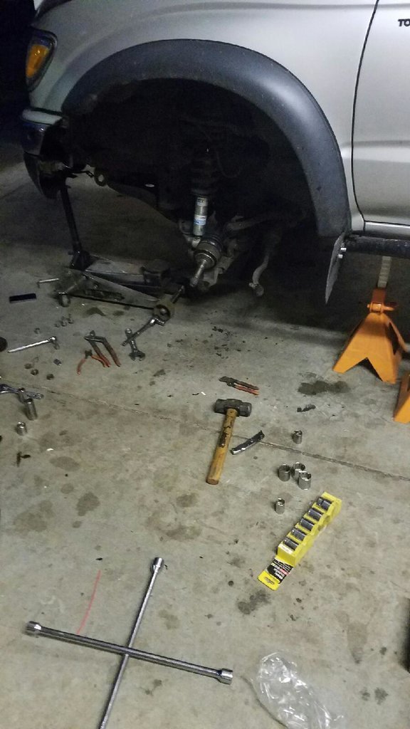

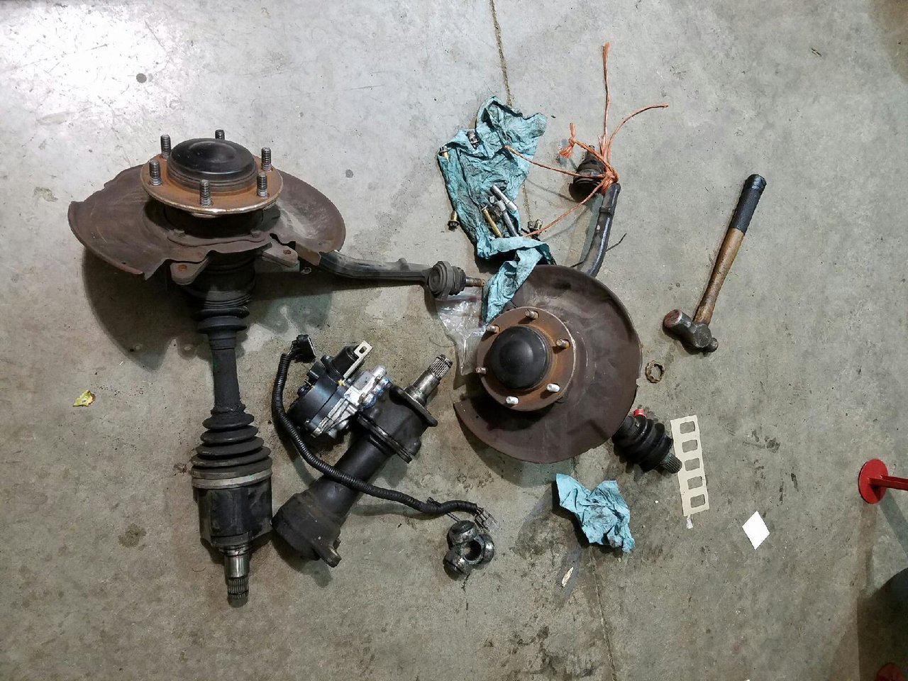

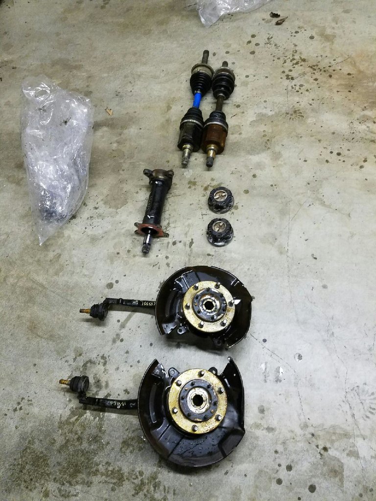

    Since owning the taco I had been fighting 4wd issues. The front ADD actuator was giving me nothing but trouble. I tore it apart and cleaned/ checked the connections and it still had issues. Broke down and bought a new OEM one and the problem persisted. Figured it might be in the wiring somewhere but I was done screwing with it. In the theme of keeping things simple I opted to scrap all the auto hub garbage. I like things simple and to work when they are supposed to. I was able to source everything I needed from a 97 Tacoma with factory manual hubs (hubs, spindles, axles, non add diff tube). I know the cv's are weaker on manual hubs but I have no plans for a front locker or tires bigger than 33" so it shouldn't be much of a problem.
    Spent some time cleaning up the hubs
    Tearing it all apart
    Garbage
    All buttoned back up.

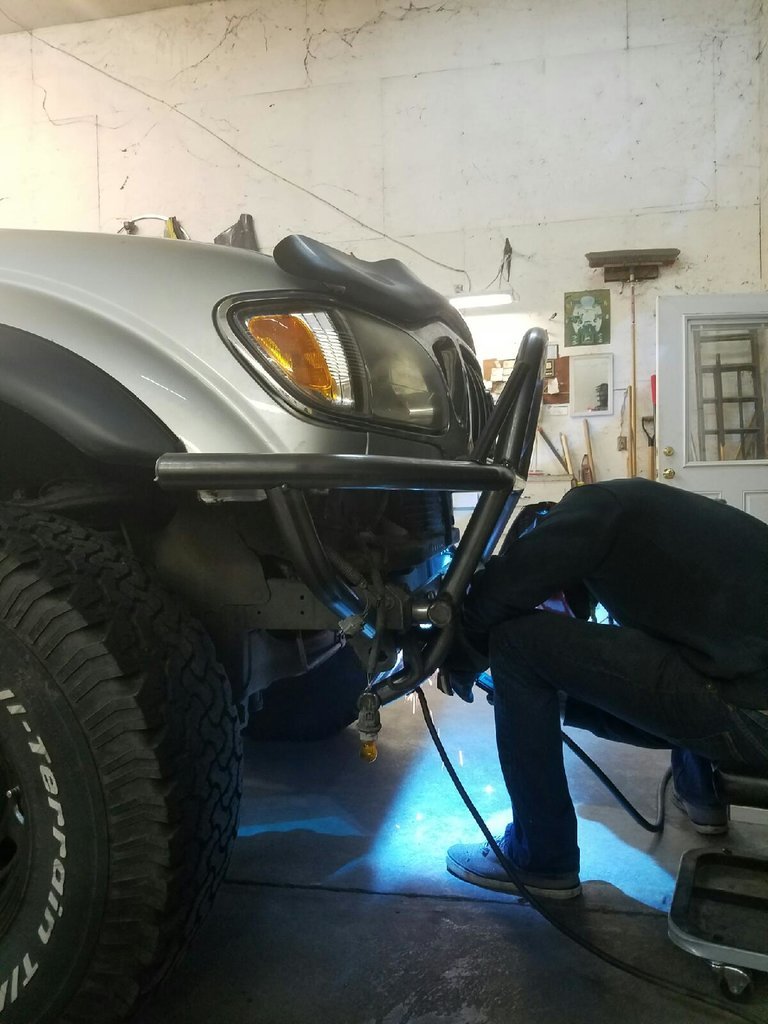

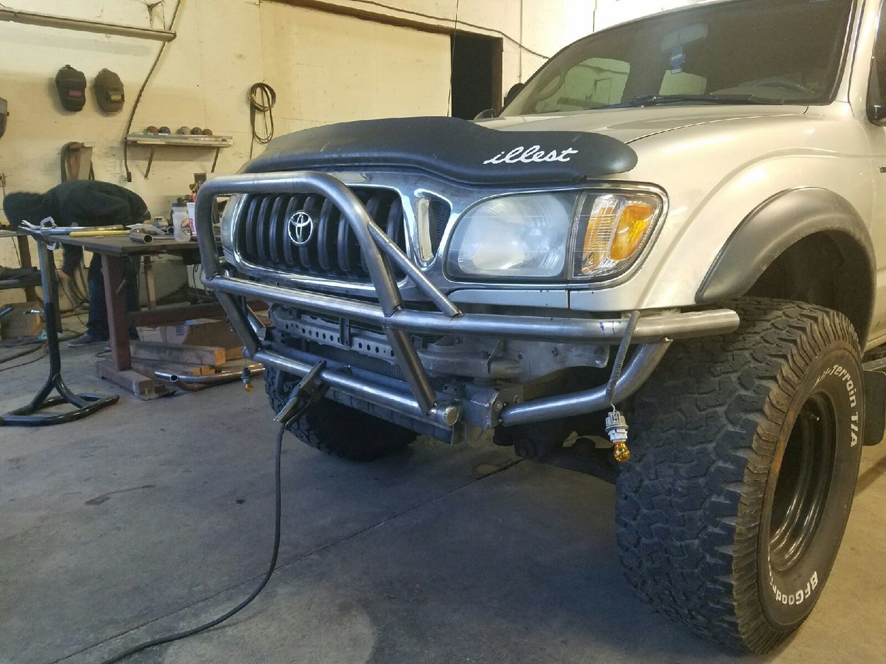

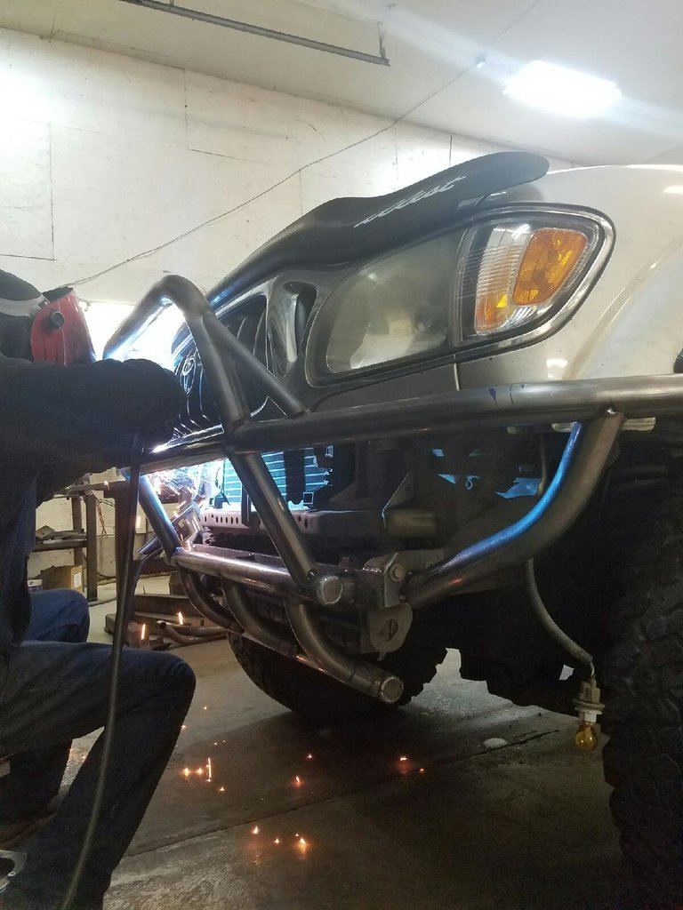

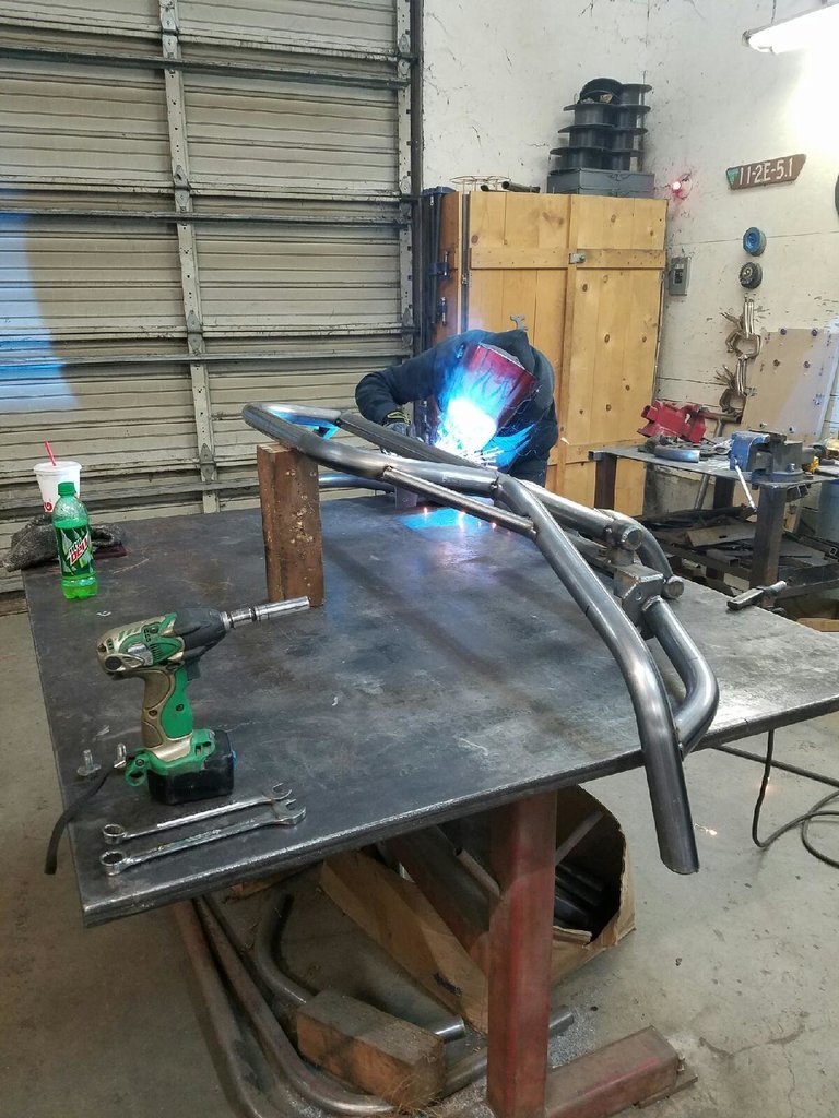

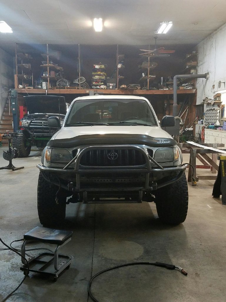

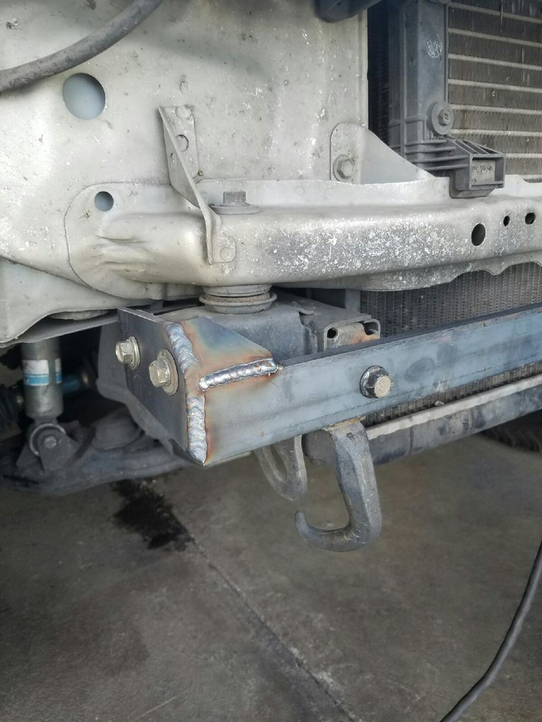

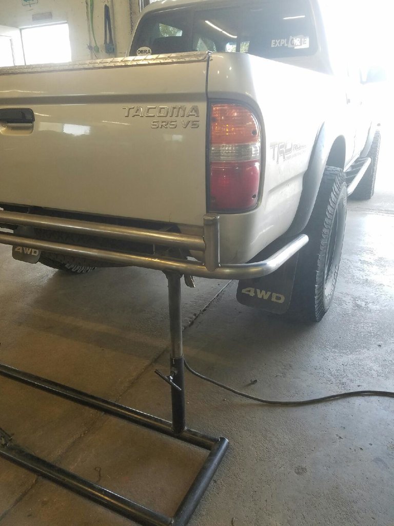

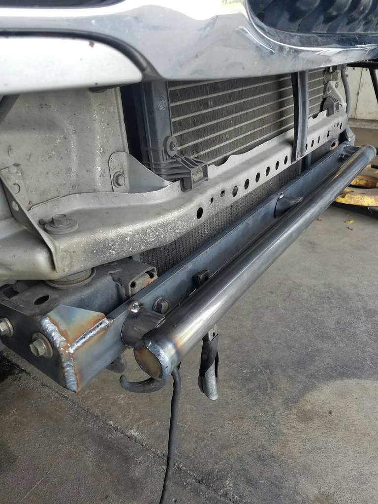

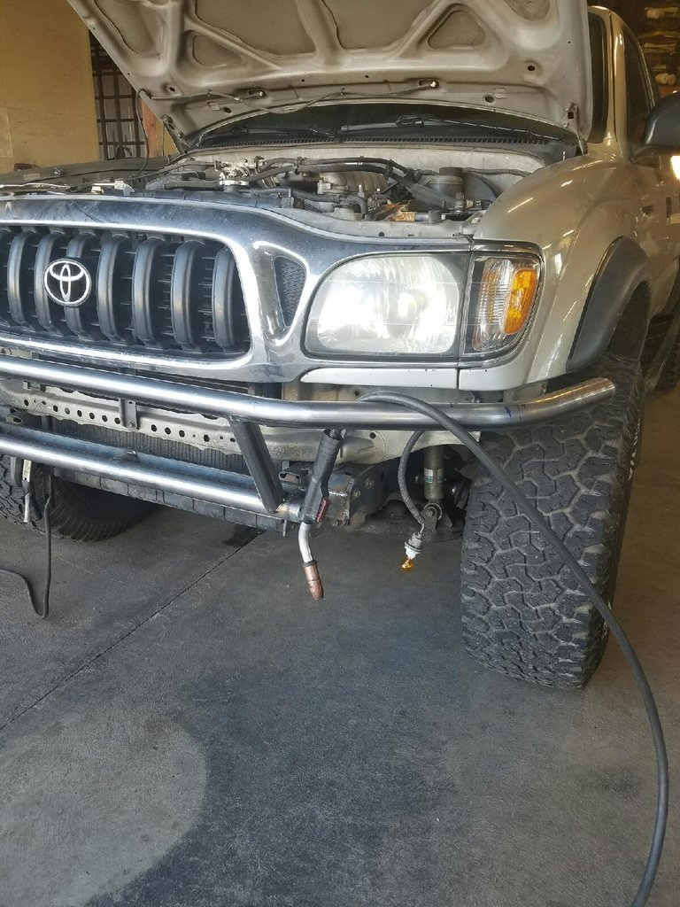

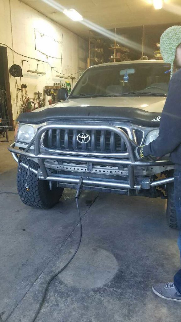

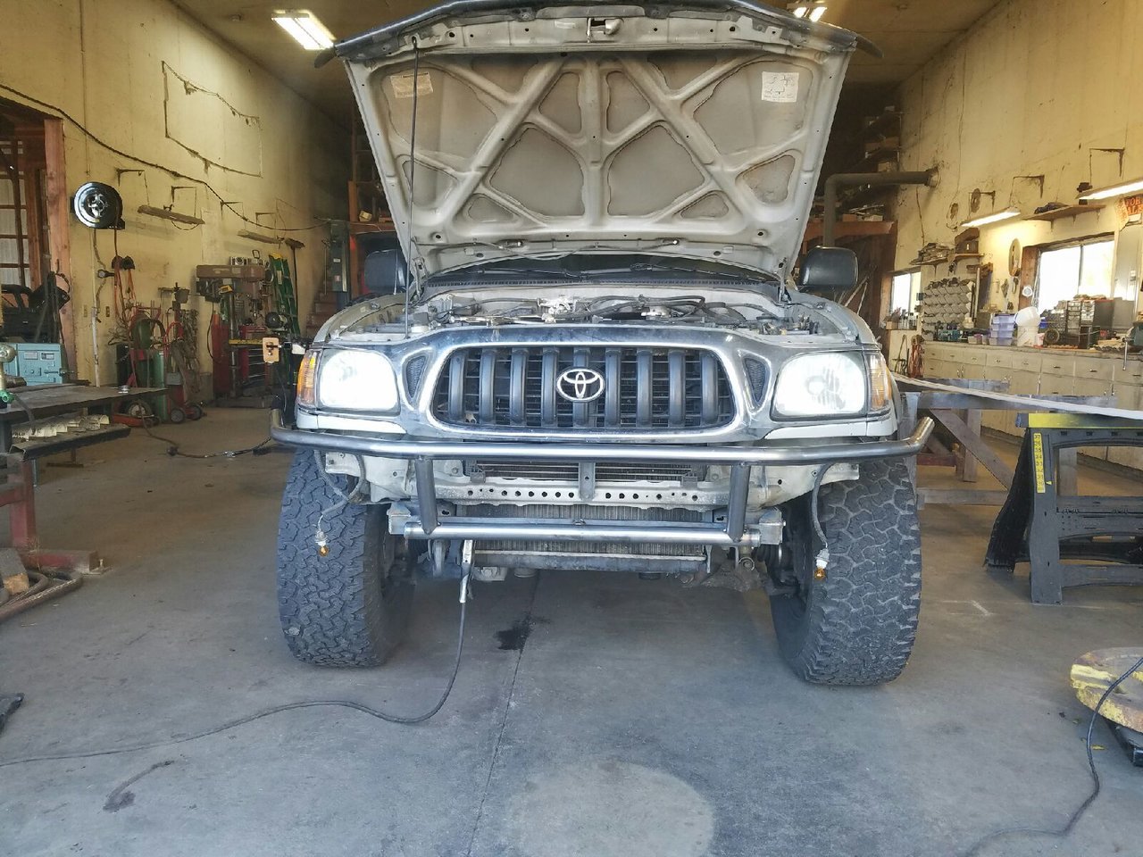

    Next on the list was bumpers. My buddy has a tube bender so I headed over to his shop to see what we could come up with.
    Benzdriver81 likes this.

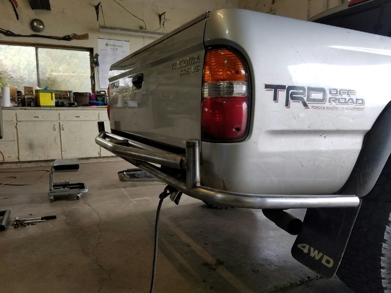

    2022 DCSB TRD-OR

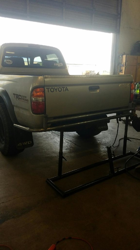

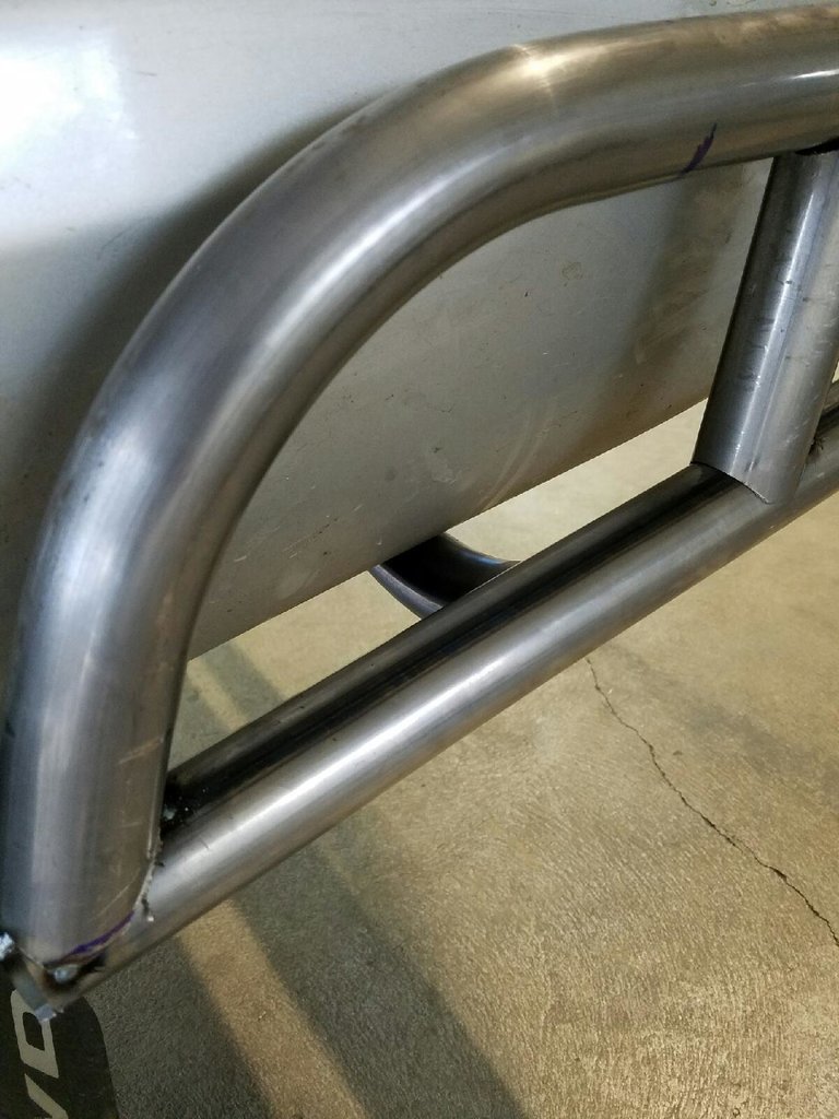

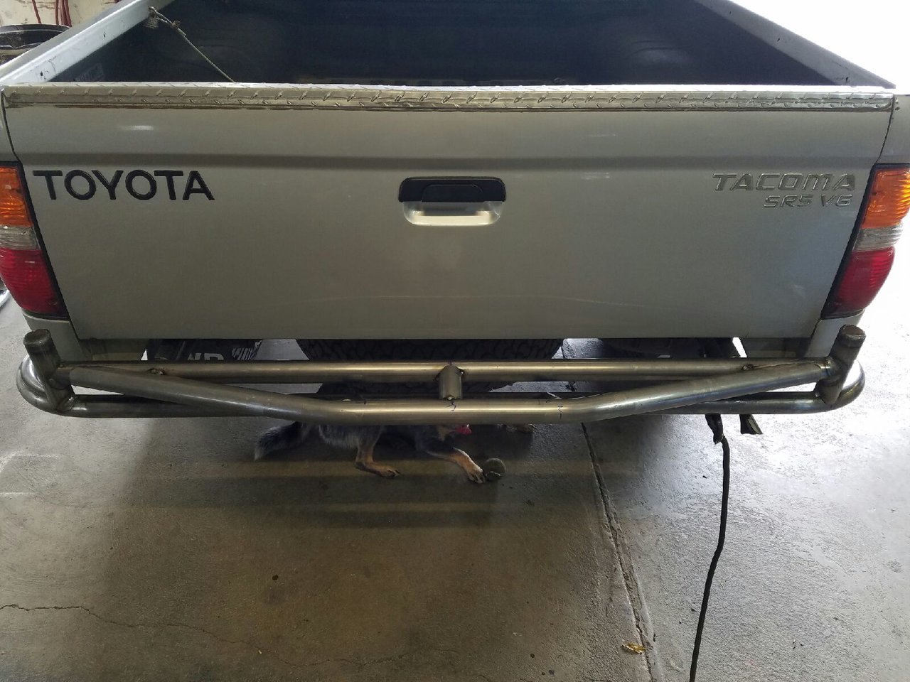

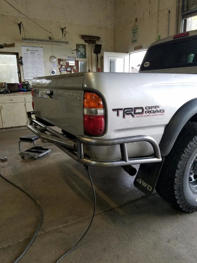

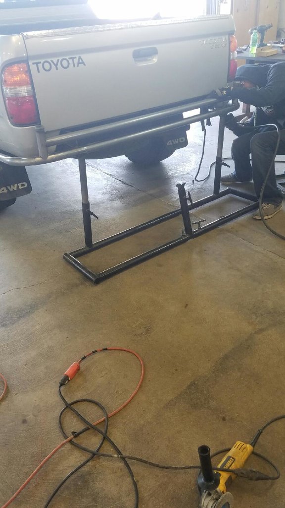

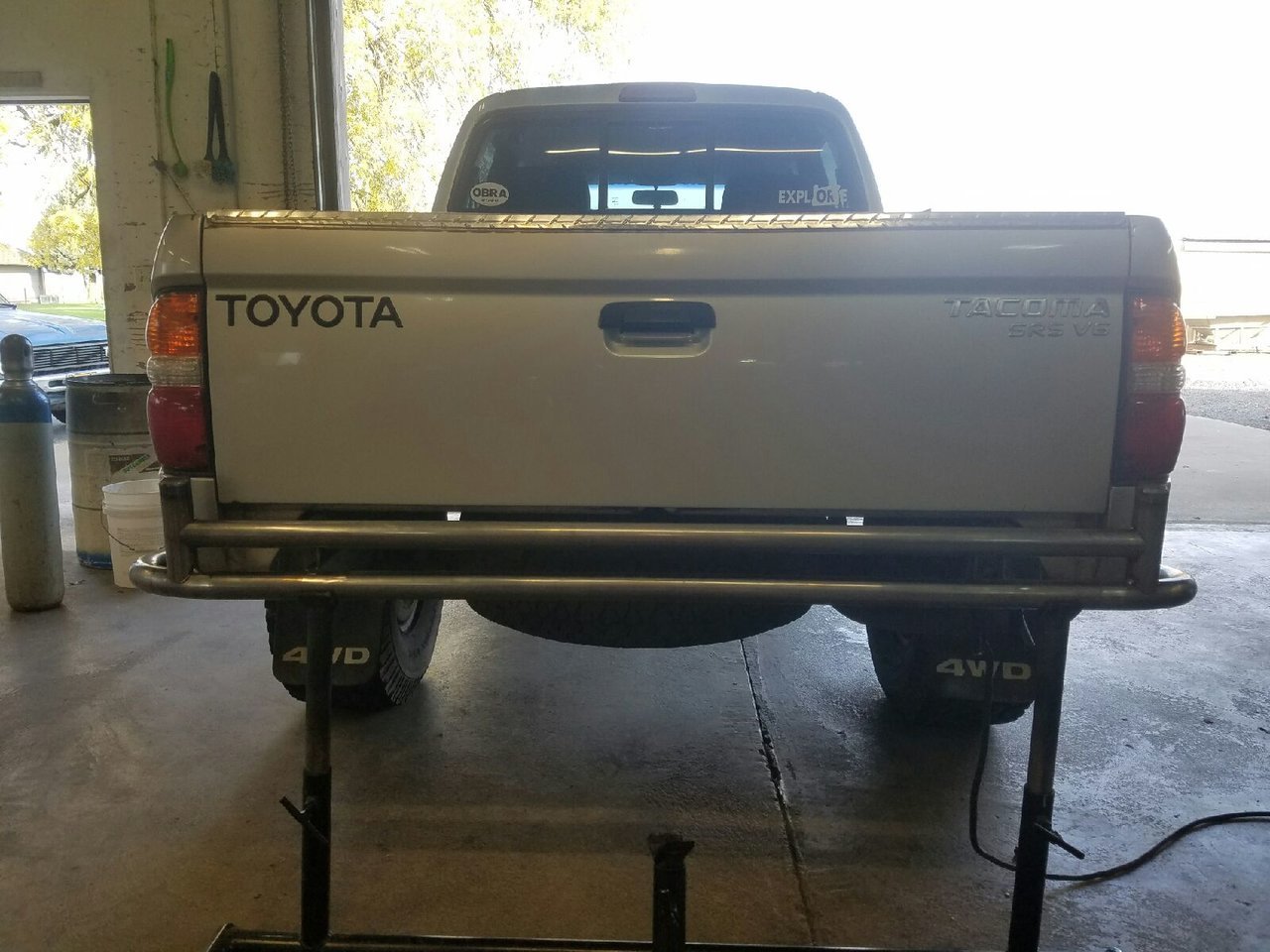

    And the rear

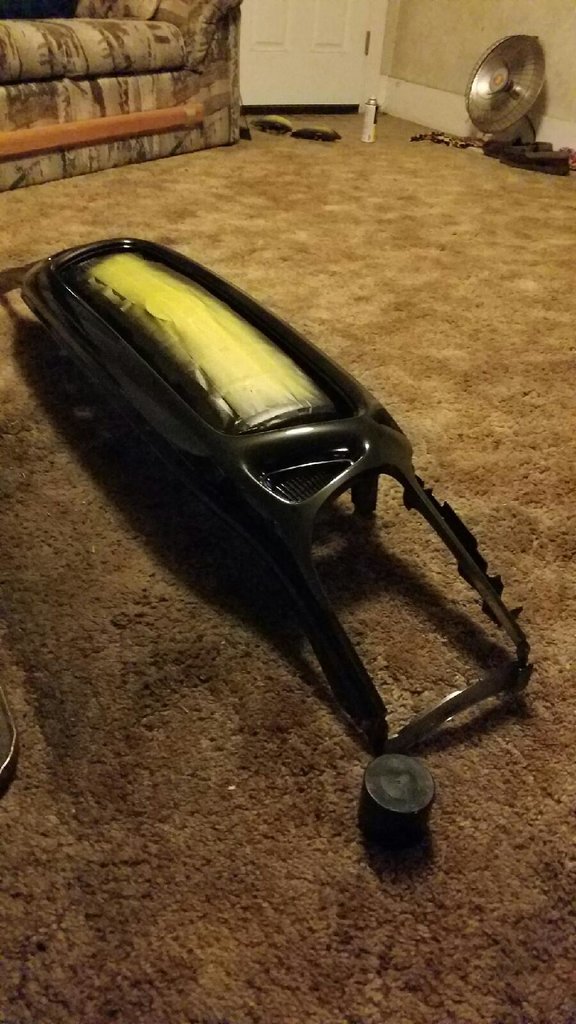

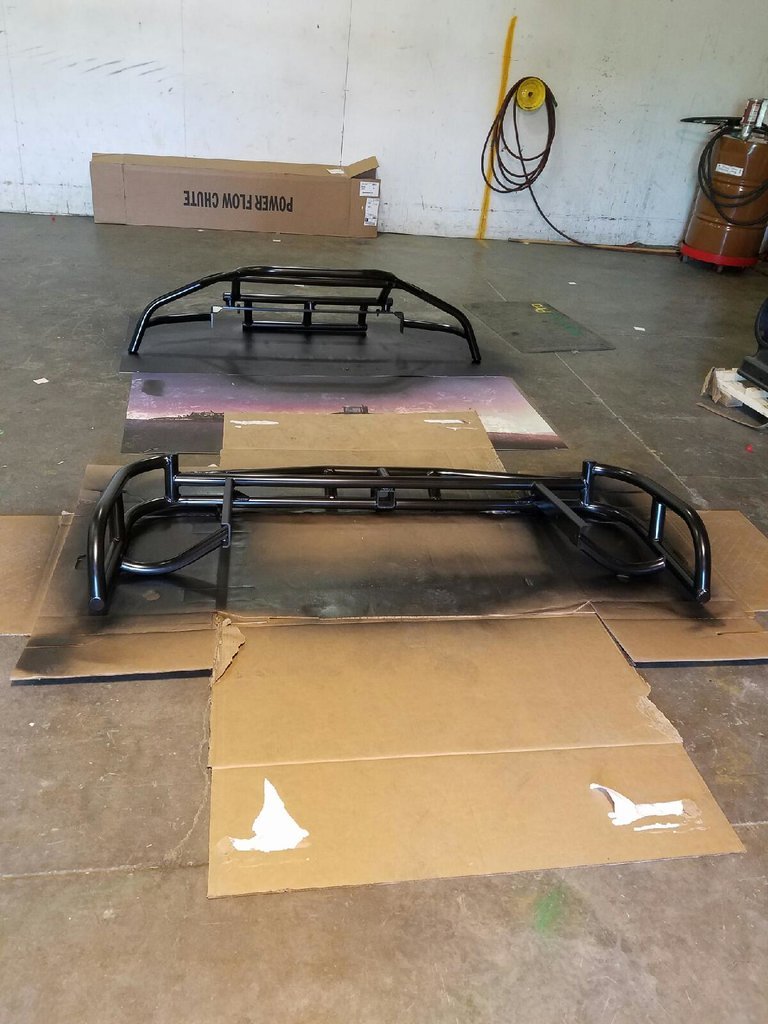

    Paint!
    Did the grill at the same time

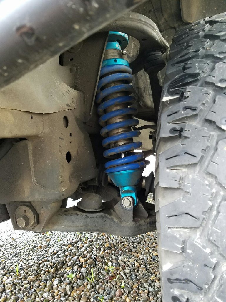

    Worked out a sweet deal for some kings! And added dakars to the rear.
    Before:
    After:
    Dirty kings..
    Then went out exploring that weekend to break everything in

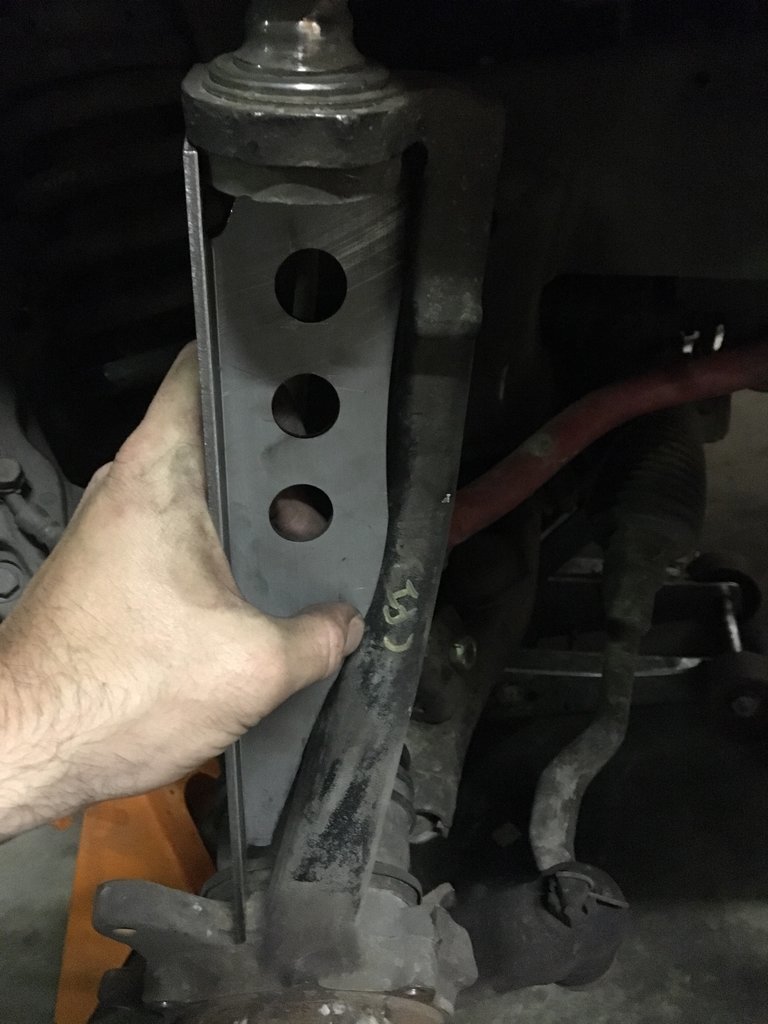

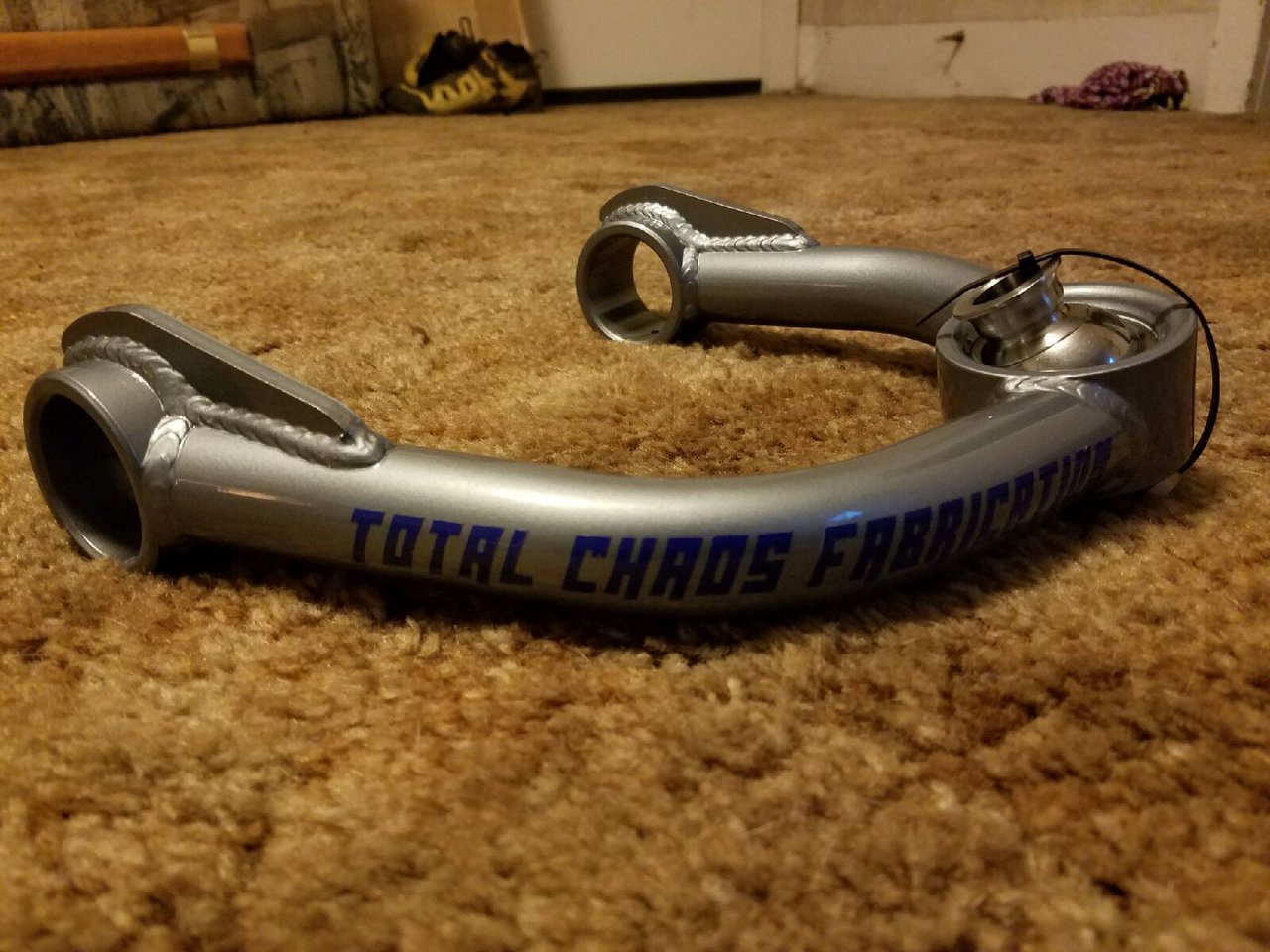

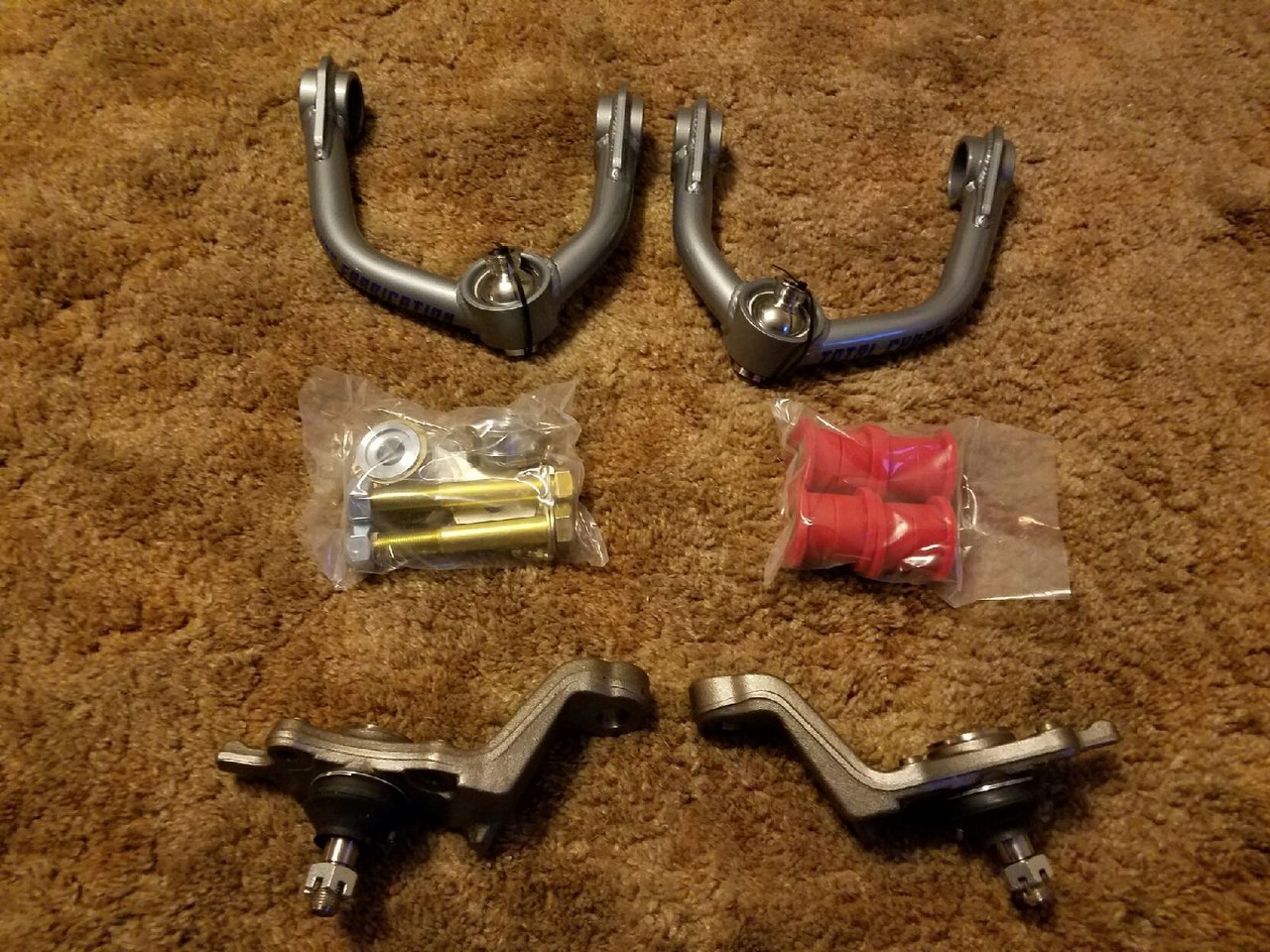

    Chaos fab UCA's, new lower ball joints and spindle gussets installed

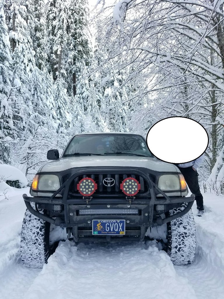

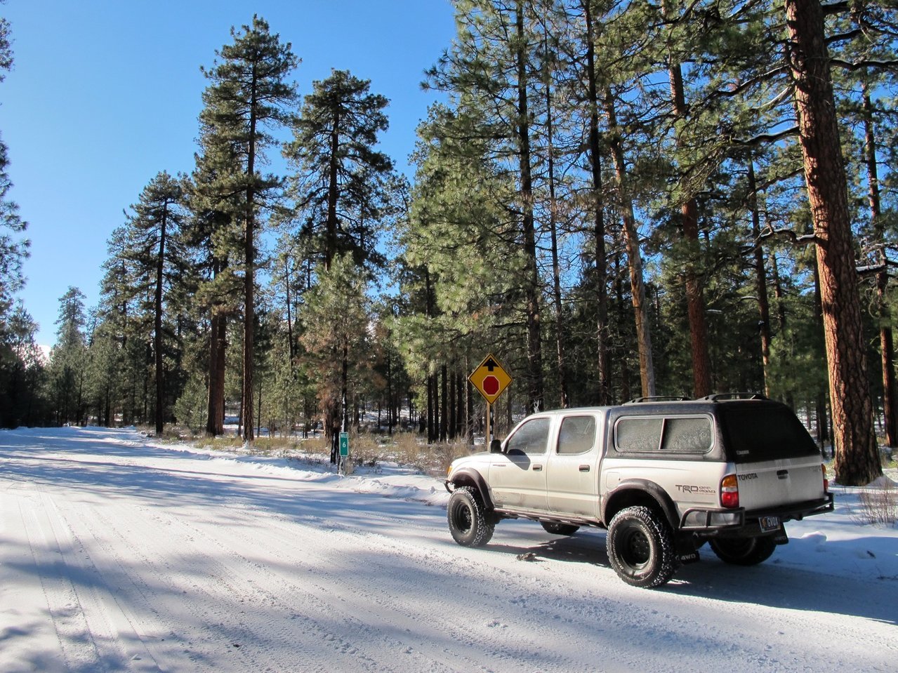

    Pic of the canopy added

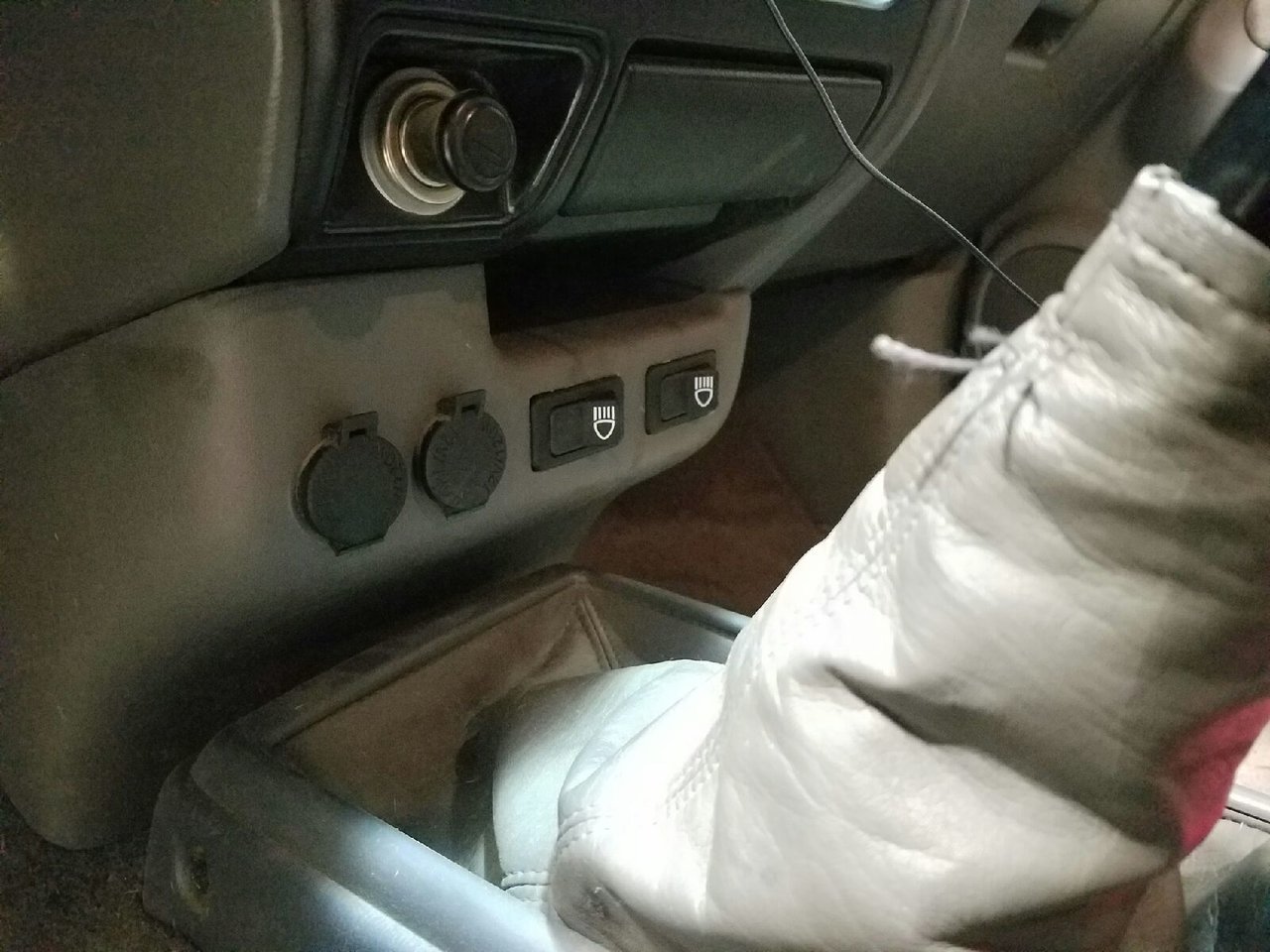

    More snow and added red ebay lights....
    Light switch location

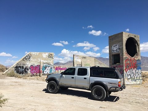

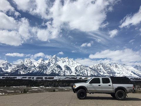

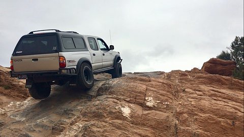

    April of this year I got married. We spent two weeks covering 7 states (OR-CA-NV-AZ-UT-ID-WY) and 3,000 miles driving around the west. Random pics from the trip:
    BYJOSHCOOK and Benzdriver81 like this.

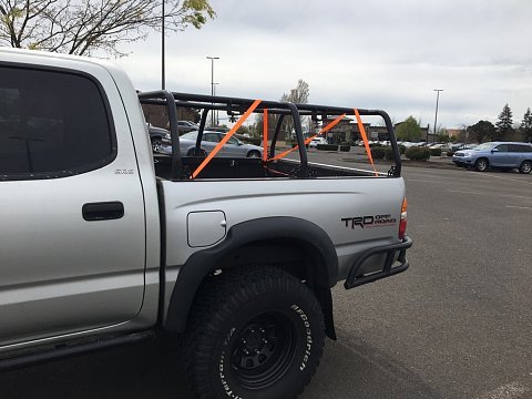

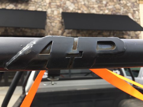

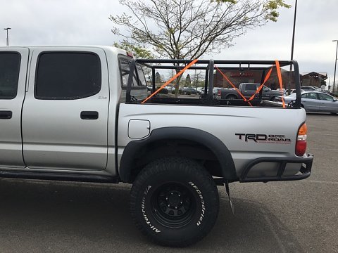

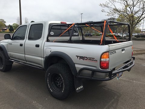

    We quickly decided on the honeymoon that the canopy wasn't working for us and we needed to change out our setup. It seemed like everything I needed kept being buried at the front and I would have to crawl in or unload half the truck to get what I needed. I found an All Pro bed rack on Craigslist when we returned and quickly snatched it up and sold the canopy. It was the exact height I was wanting. The bro looking spider web gussets have since grown on me. I really wanted to chop them off when I got it :rofl:
