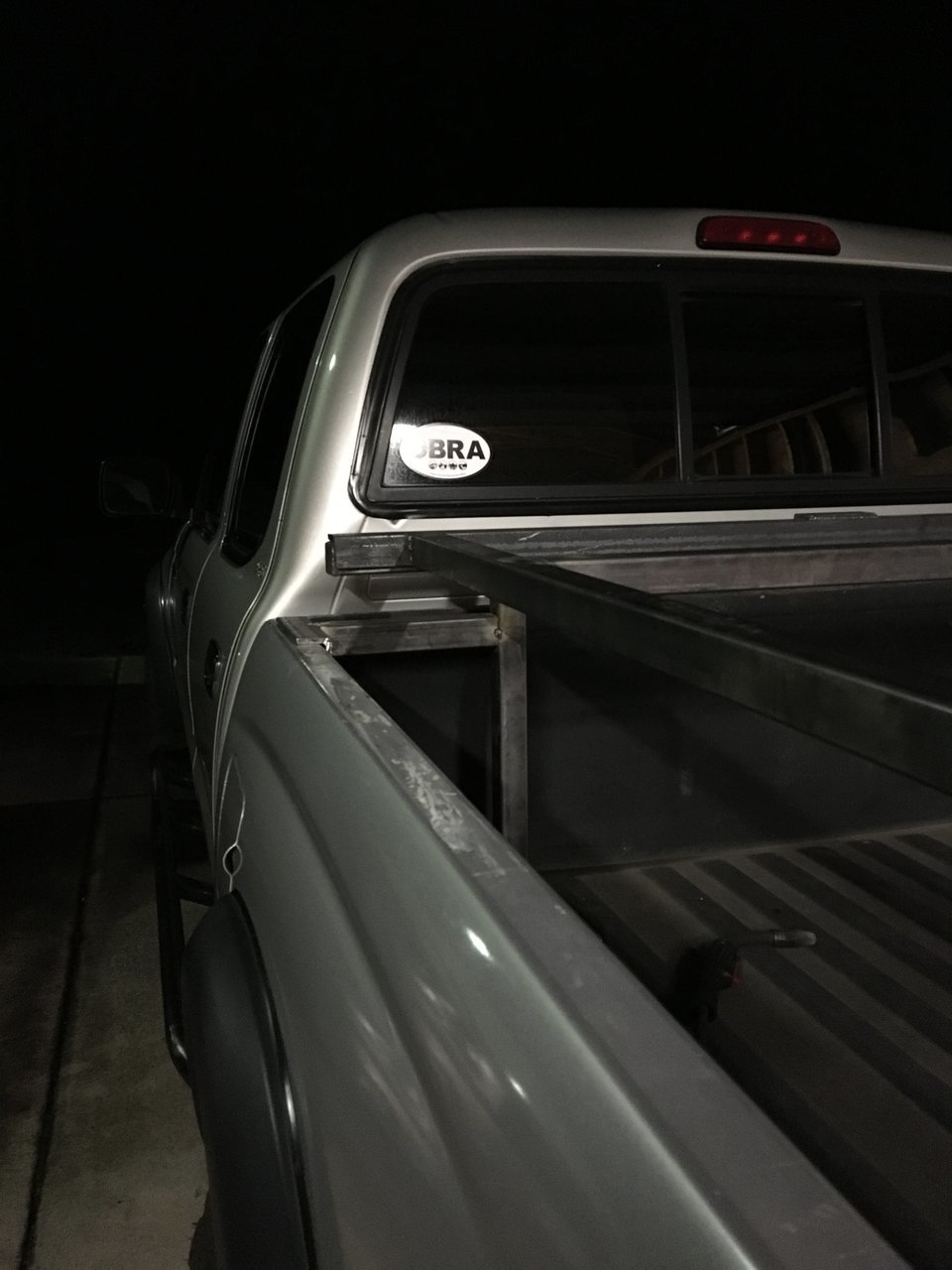

  2. Jul 25, 2017 at 10:38 AM

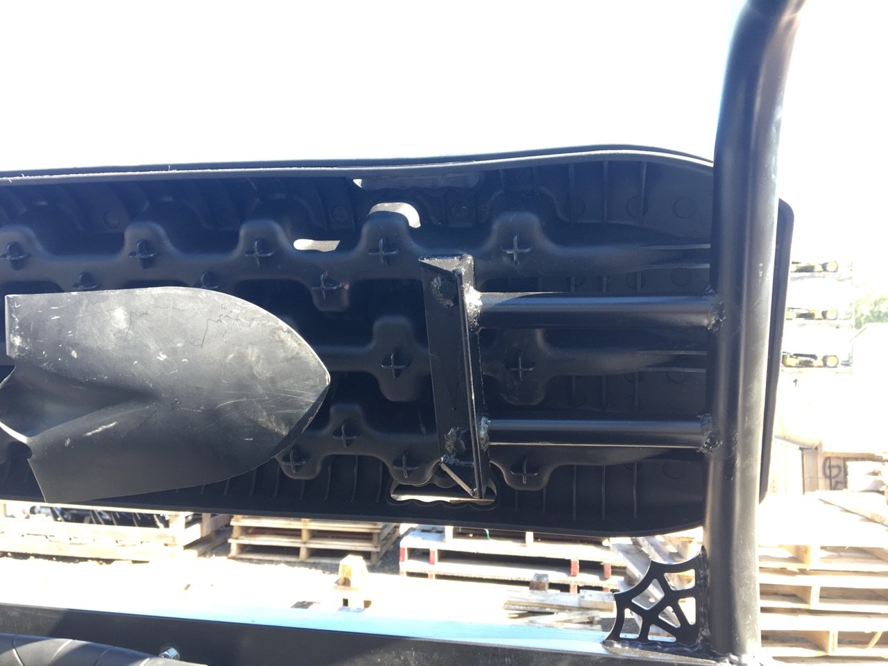

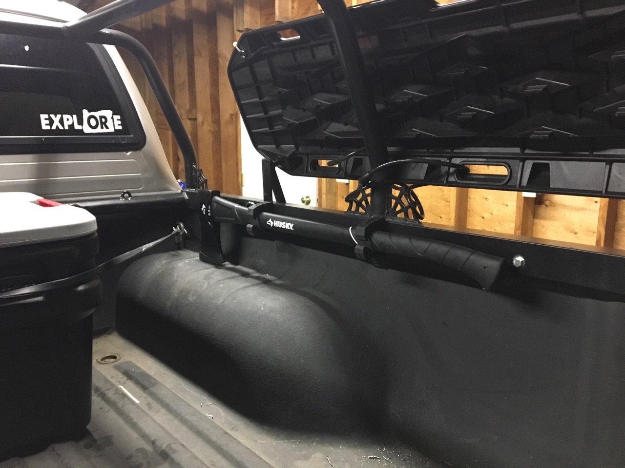

    2022 DCSB TRD-OR

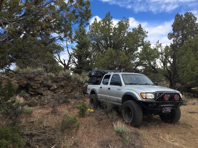

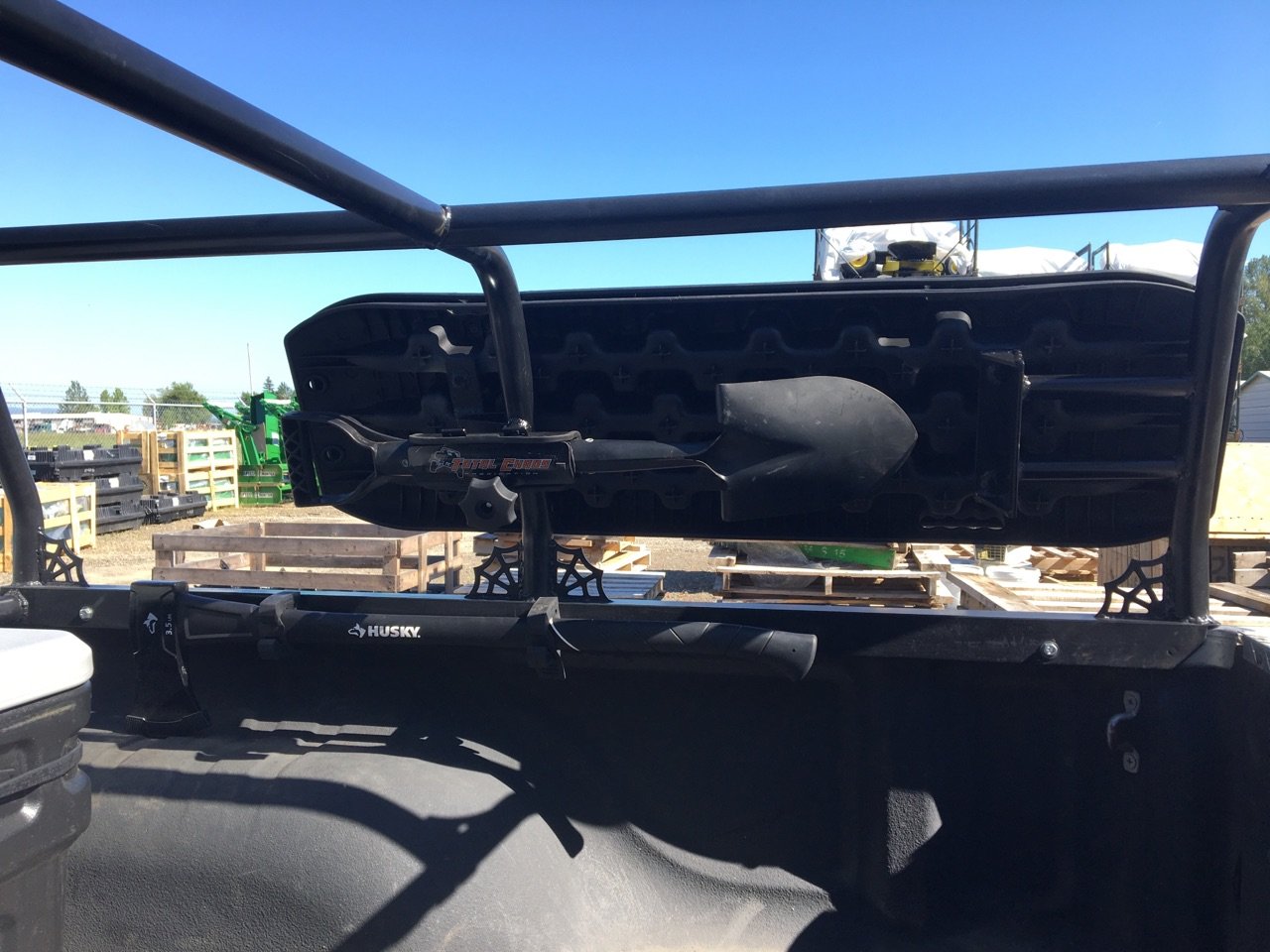

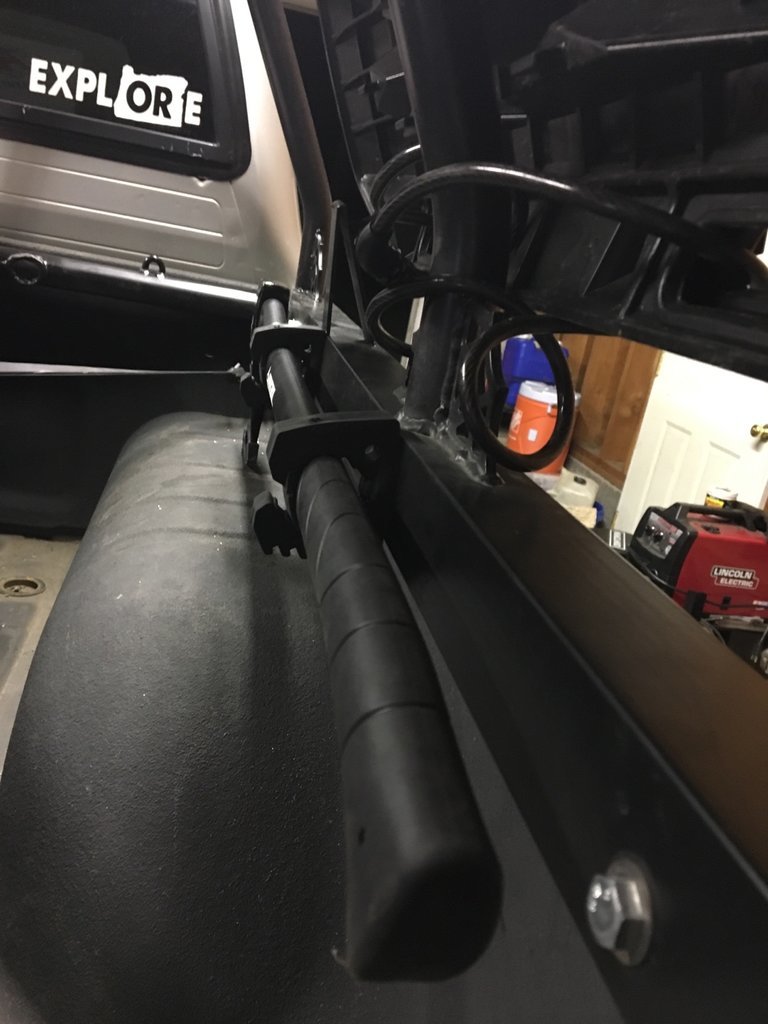

    Drove over the mountain to visit CVT and talk to them about tents.
    Came back with an awning while we continued to save for the RTT

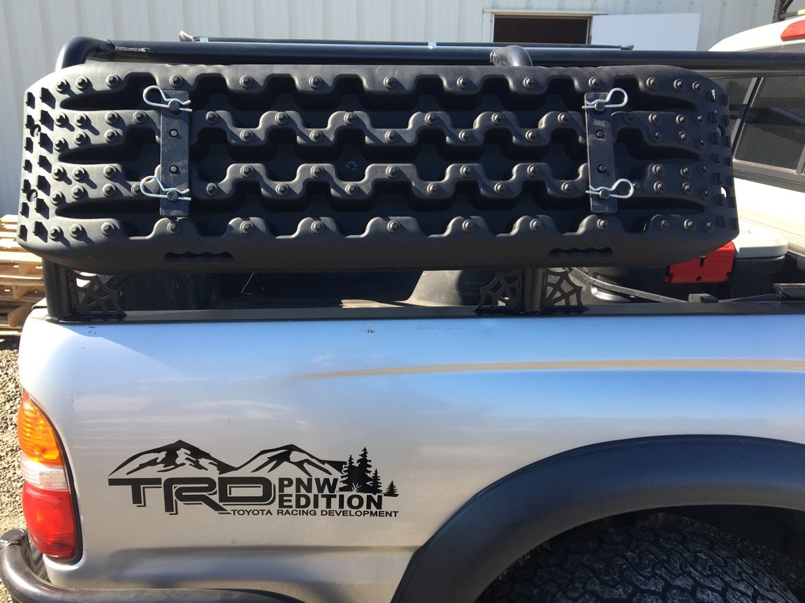

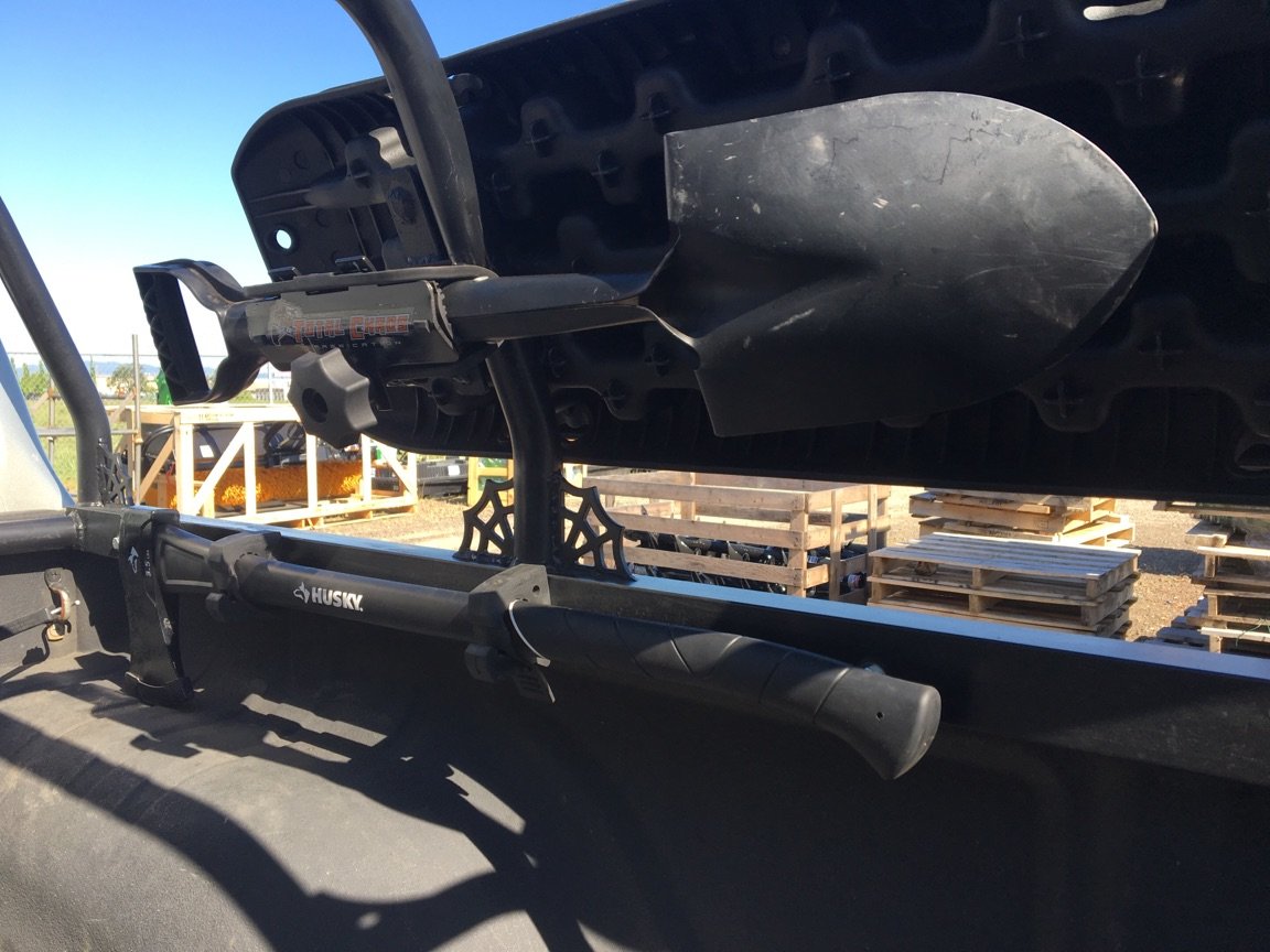

    Also got some more work done on the bed rack. Trac board and shovel mount and axe mount done.

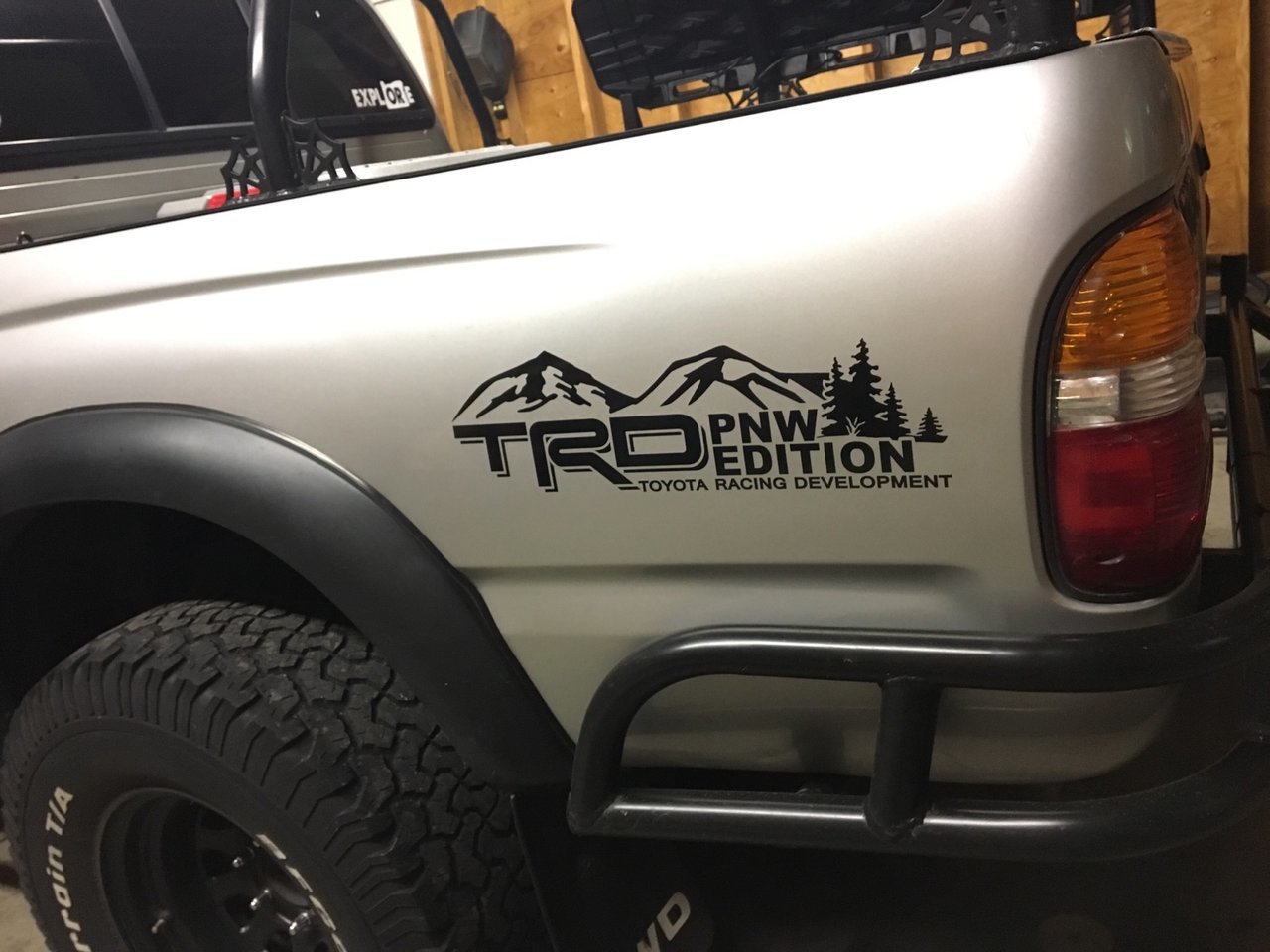

    +PNW Edition Decals!!!

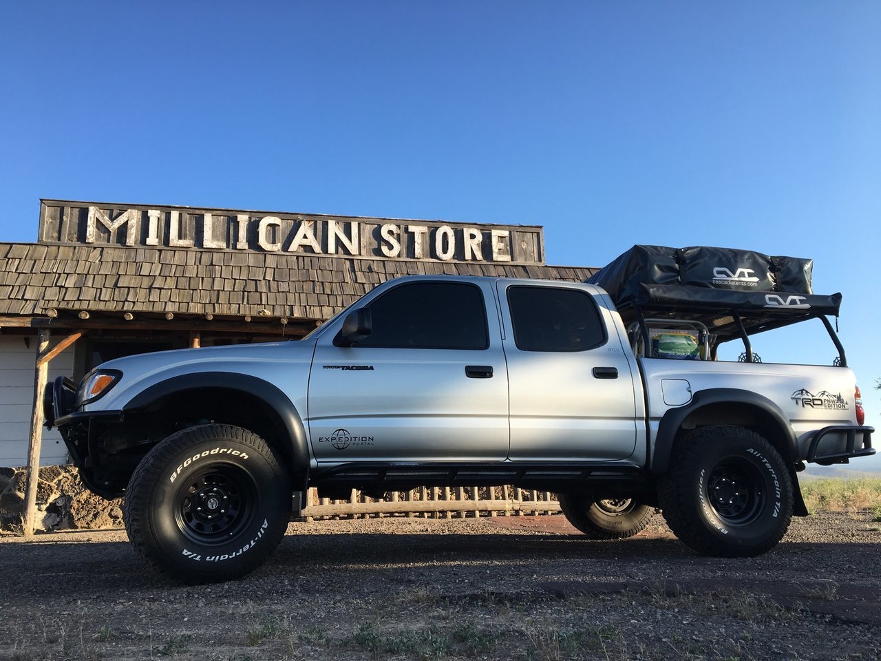

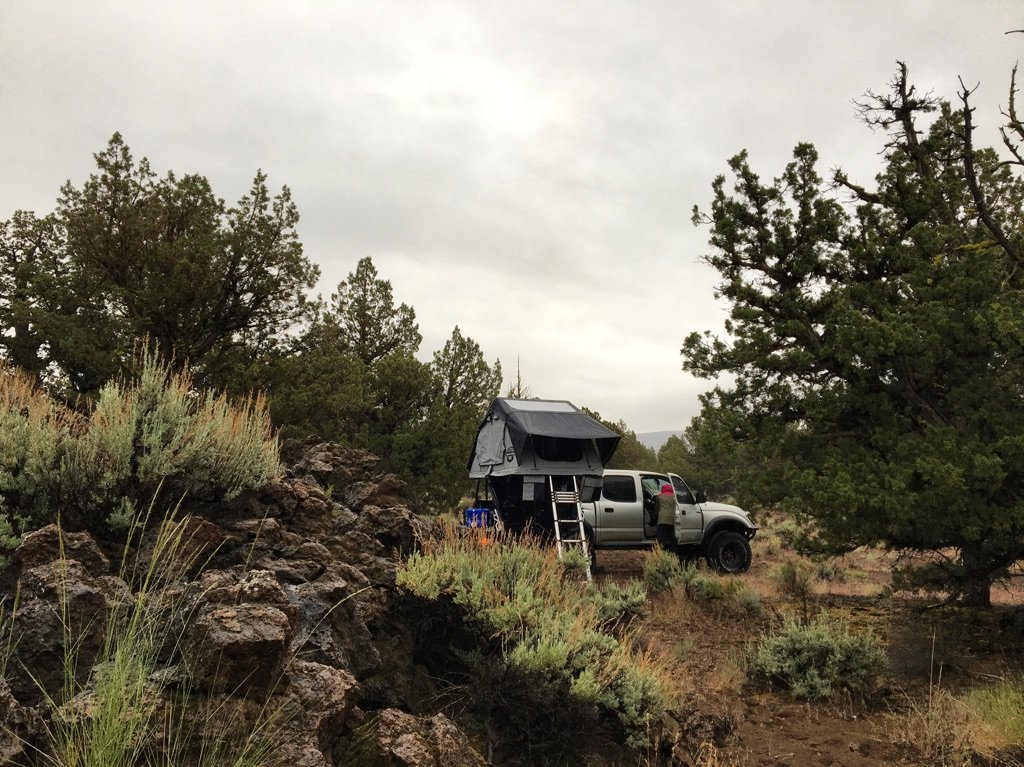

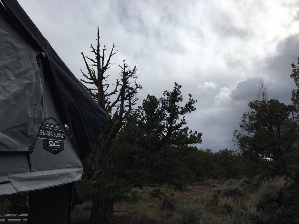

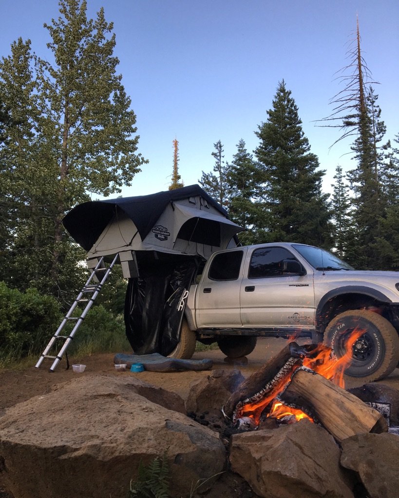

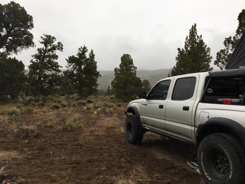

    The next trip over the mountains was to pick up the RTT :broccoli: We went with a Mt Shasta Standard Stargazer Summit in grey. Dealing with Bobby and his team was an excellent experience. They took the time to answer all of our questions and make sure we got exactly what we wanted. Also being a TW member gets you %15 off :thumbsup: Took it out into the desert that night to camp before heading back home. Got hit with some rain and stayed perfectly dry inside the new digs.

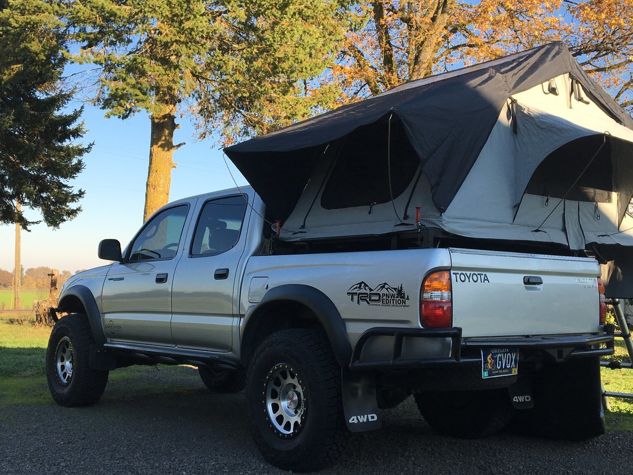

  4. Jul 25, 2017 at 10:52 AM
    #24
    nw_chris
    nw_chris [OP] Outside Everyday
    Aug 12, 2016
    #194416
    350
    Albany, OR
    2022 DCSB TRD-OR

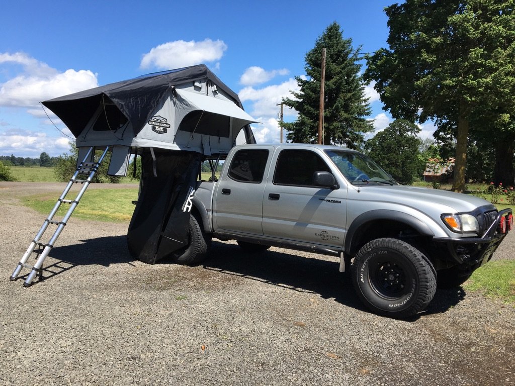

    Aired it out the next day at home and took pictures with a little better lighting.

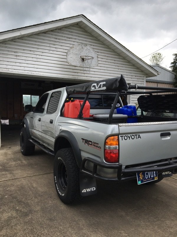

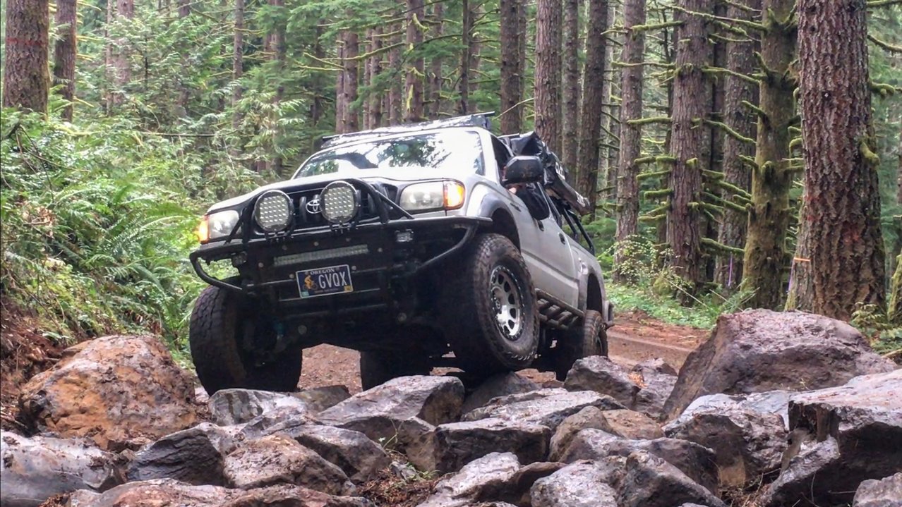

    Swapped out the little 7in lights for some of these 160w 9in monsters :cool:

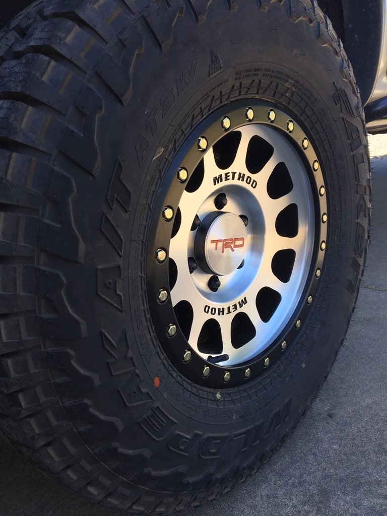

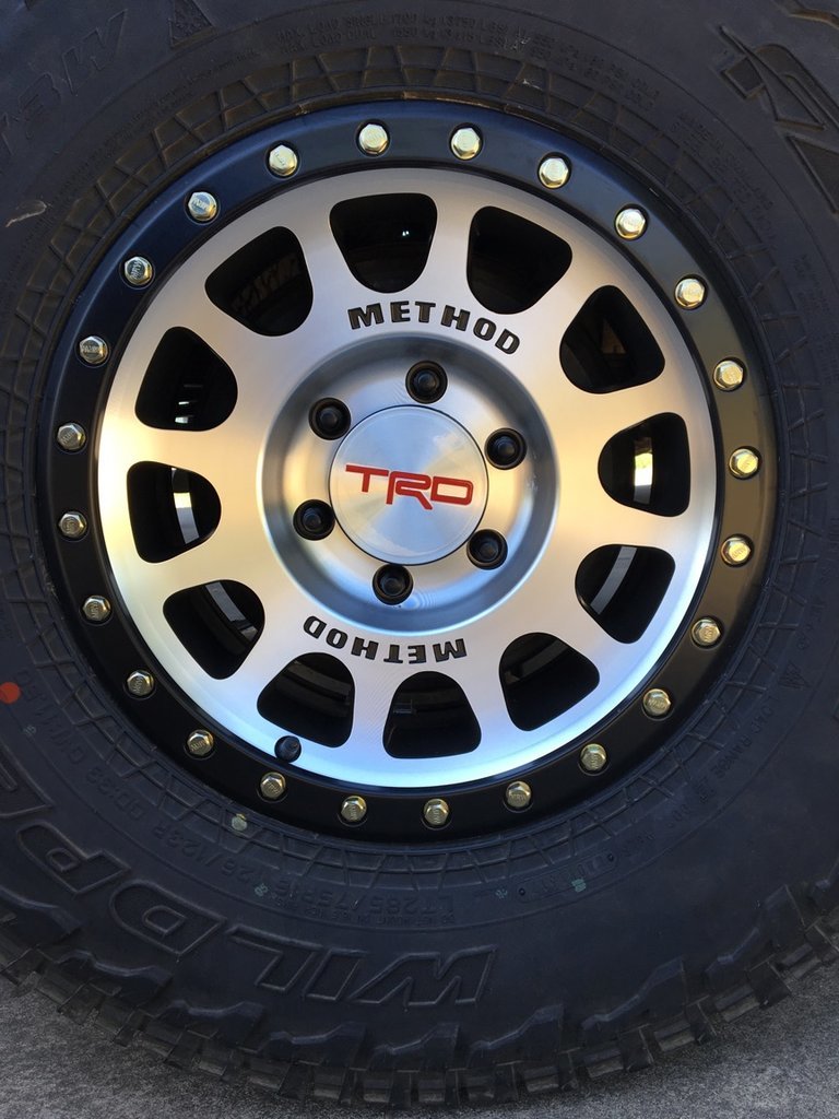

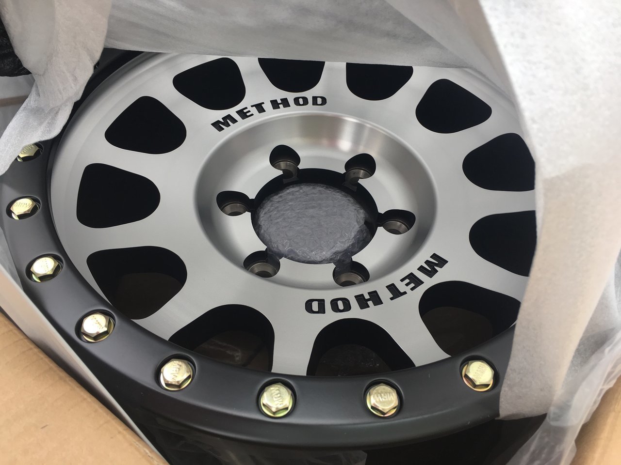

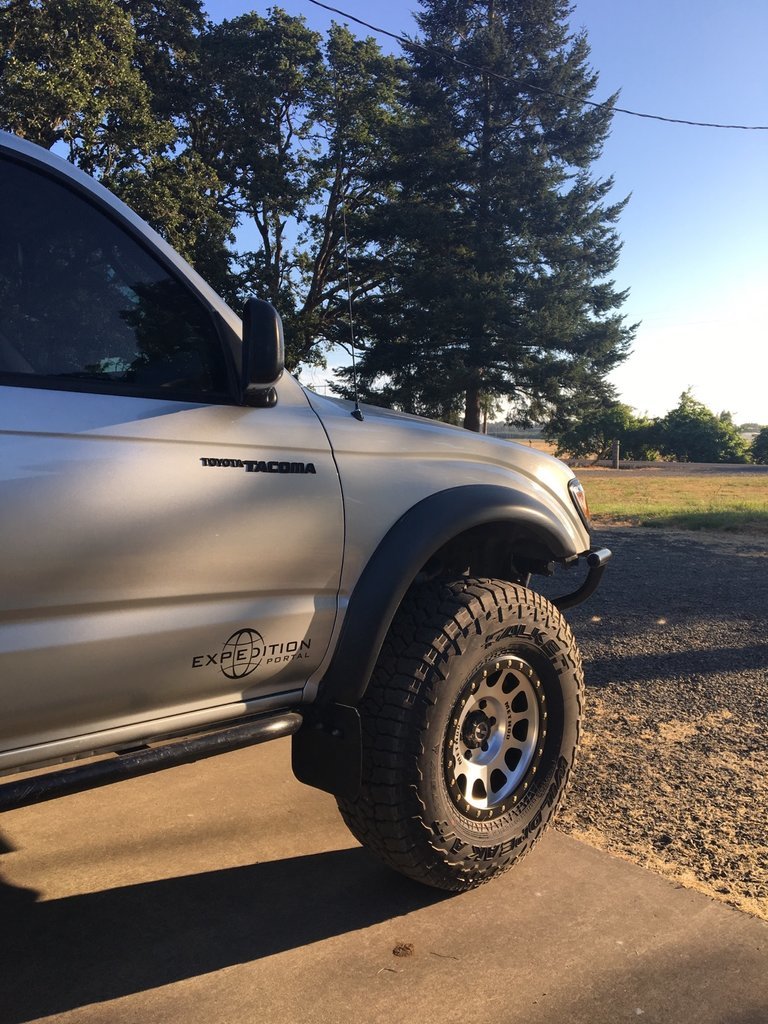

    New wheels!
    Got them mounted up with 285/75/r16 Falken Wildpeak at3w's

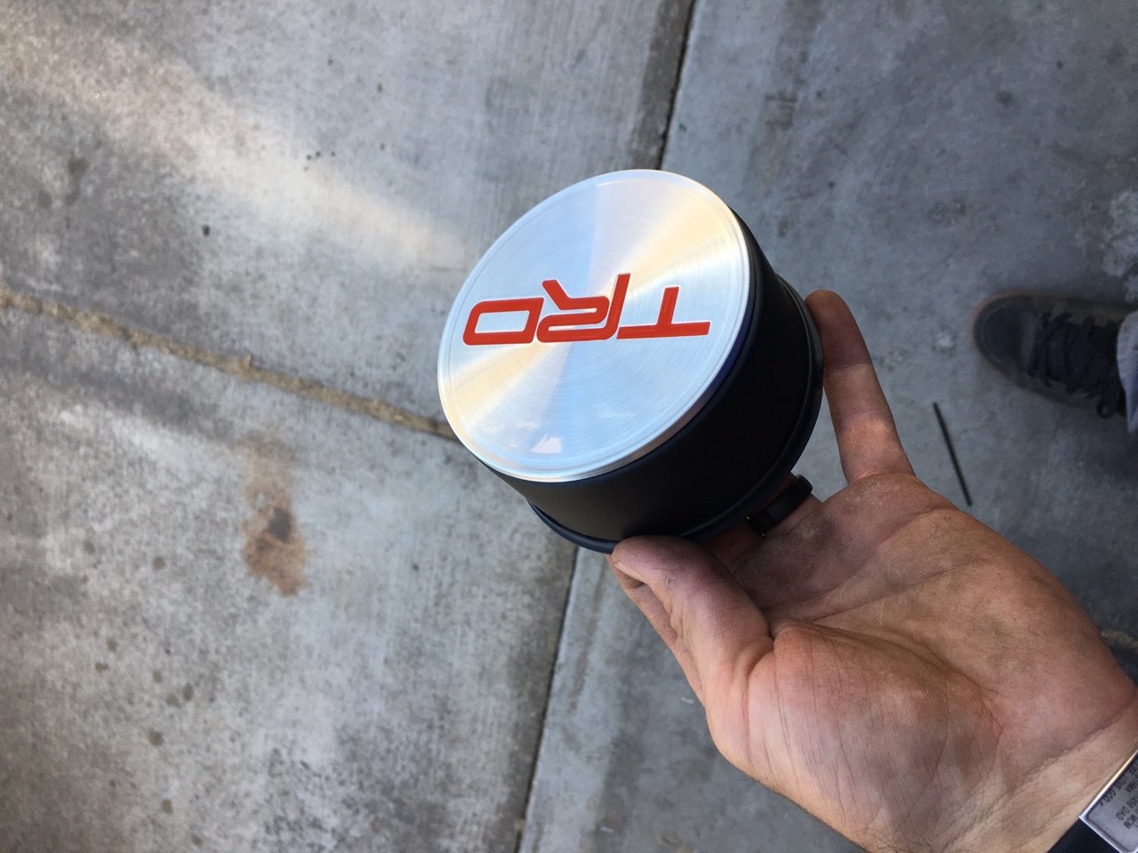

  9. Jul 28, 2017 at 2:16 PM
    #29
    nw_chris
    Aug 12, 2016
    #194416
    350
    Albany, OR
    2022 DCSB TRD-OR

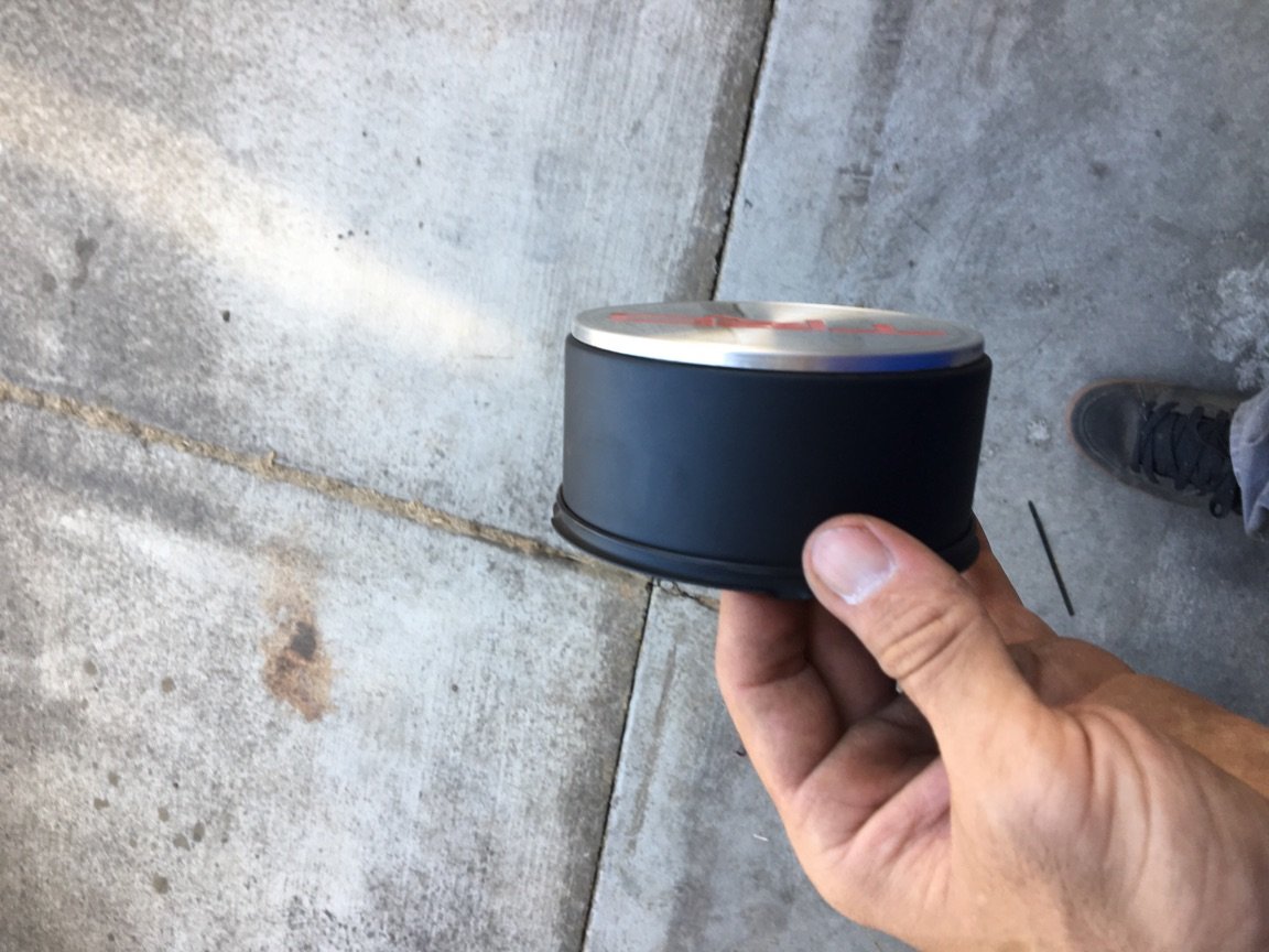

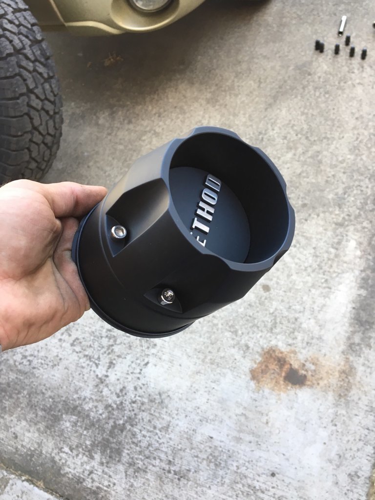

    The method center caps that came with the wheels were just foul looking. So I chopped them apart and fitted in OEM TRD caps :cool:

    #30
    Benzdriver81
    Benzdriver81 Making it fool-proof will just make a better fool
    Aug 1, 2016
    #193495
    6,092
    Kevin
    PNW
    05 DCLB Sport
    Subb'd!!!
    nw_chris[OP] likes this.
  11. Jul 28, 2017 at 2:42 PM
    #31
    Benzdriver81
    Aug 1, 2016
    #193495
    6,092
    Kevin
    PNW
    05 DCLB Sport
    Clever, I like it!

    04 Double cab
    I have noticed lots of aftermarket suppliers for wheels. Are these a true beadlock? It would save gobs of time and money to find some aluminum bead locks!
    Sliders are a great investment btw!
  13. Jul 31, 2017 at 10:54 PM
    #33
    nw_chris
    Aug 12, 2016
    #194416
    350
    Albany, OR
    2022 DCSB TRD-OR
    No sir. They are just a faux beadlock rim

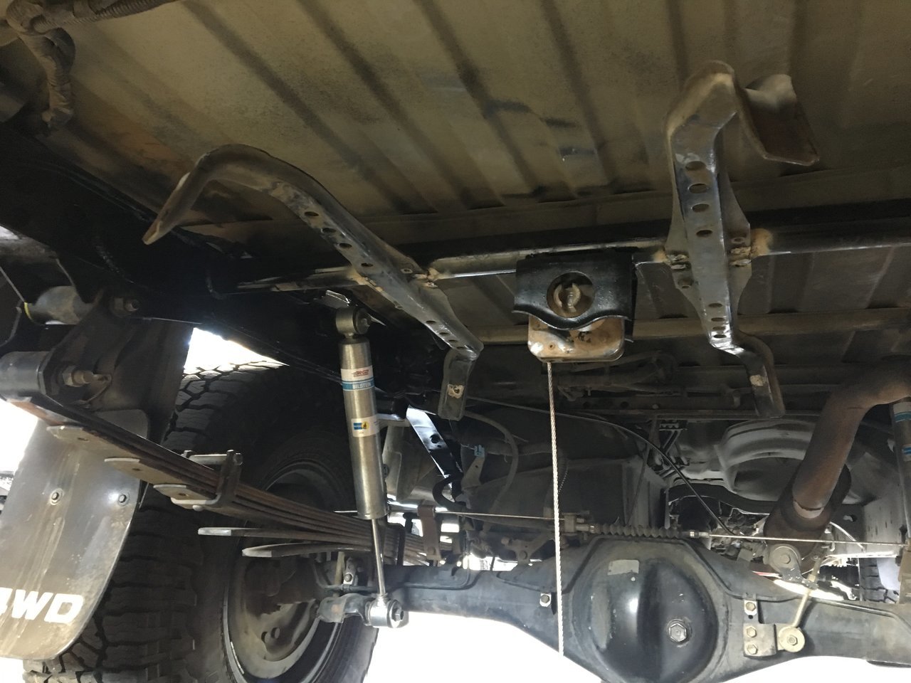

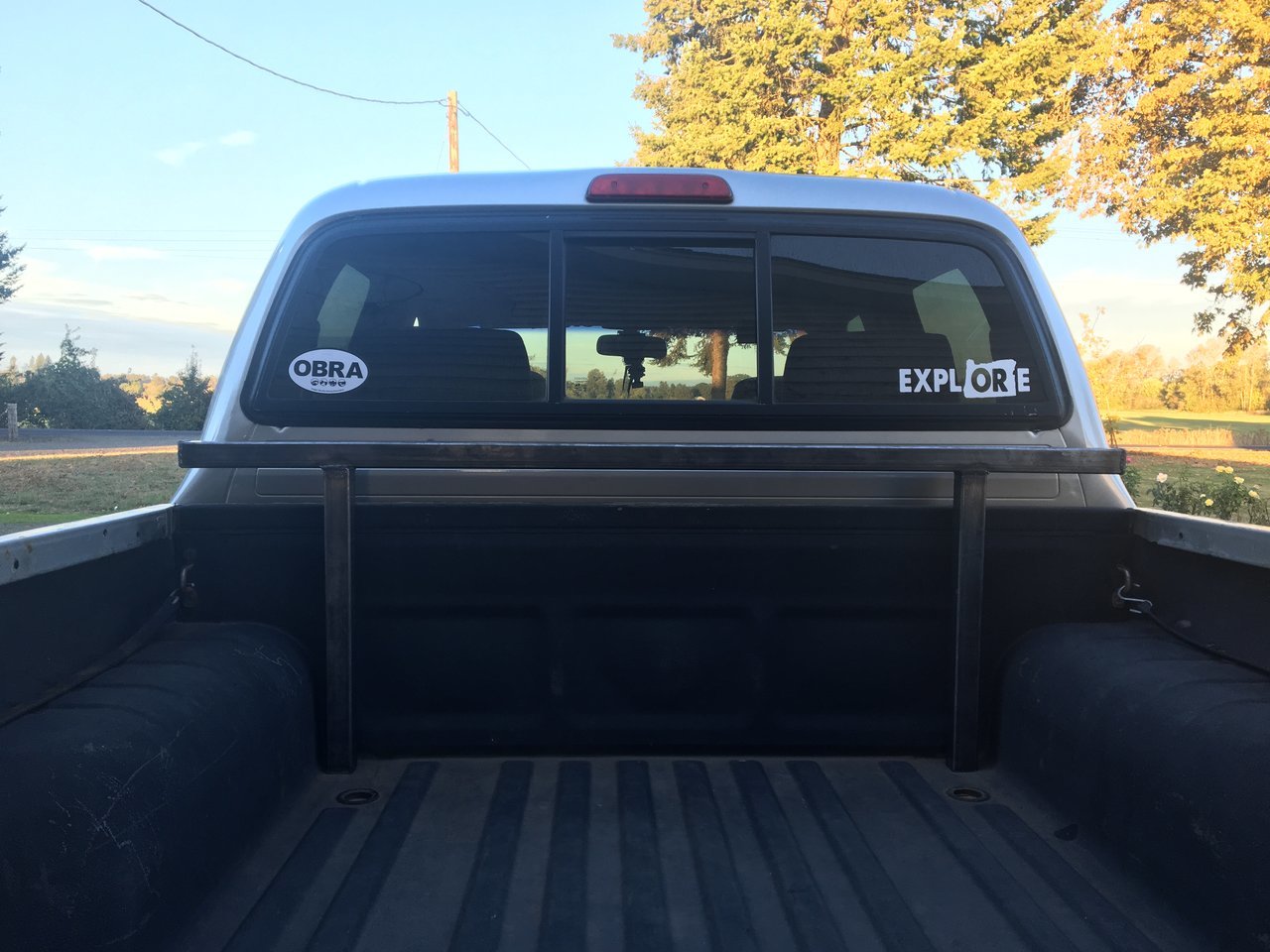

    Finally got around to boxing in the rear frame. With the RTT and bike rack off the back I was getting some notable bed/frame flex and this definitely seemed to help.
    Mocked up
    Cross bar added in and I cut and welded the factory spare parts back in. I didn’t want a swingout with the bike rack on the back and a dcsb has such limited bed space this seemed like the most reasonable option.

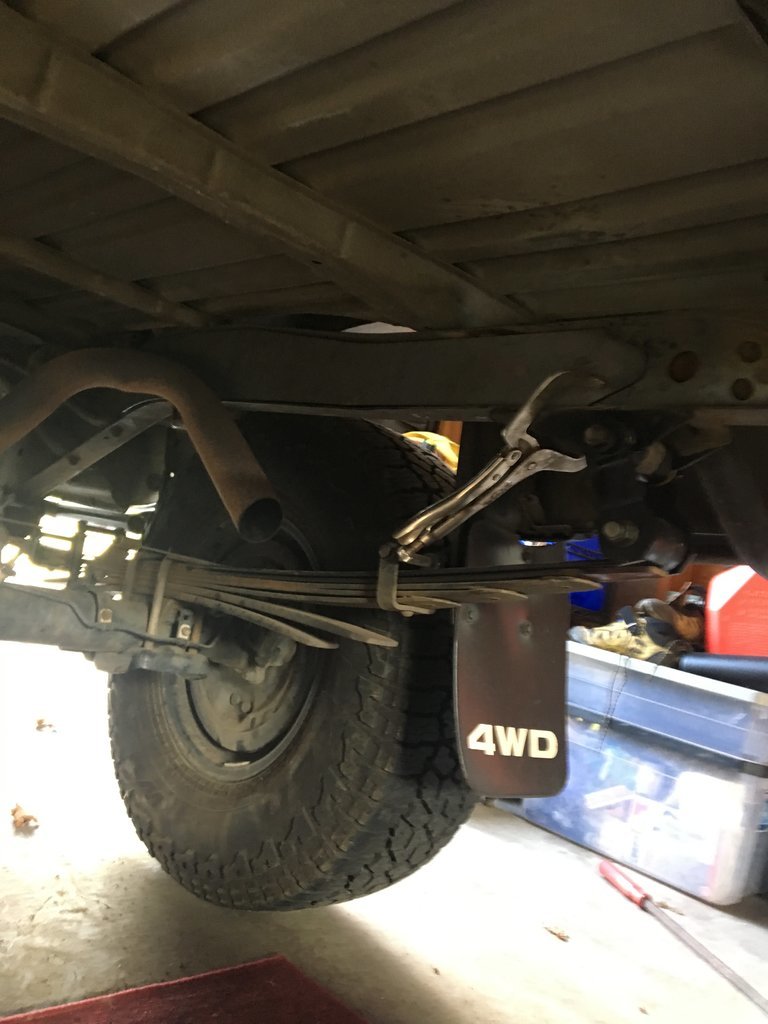

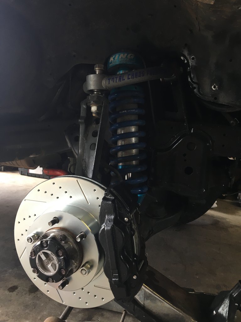

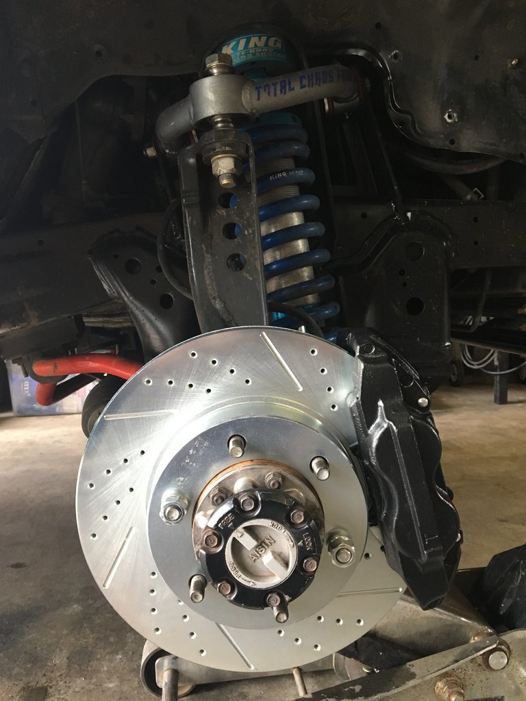

    Did the 13WL Tundra upgrade. Stops really well, pedal feel is still a bit soft though. Going to run it a couple hundred more miles and rebleed em.
    (And yes it was on jack stands I just leave the jack under for extra precaution)

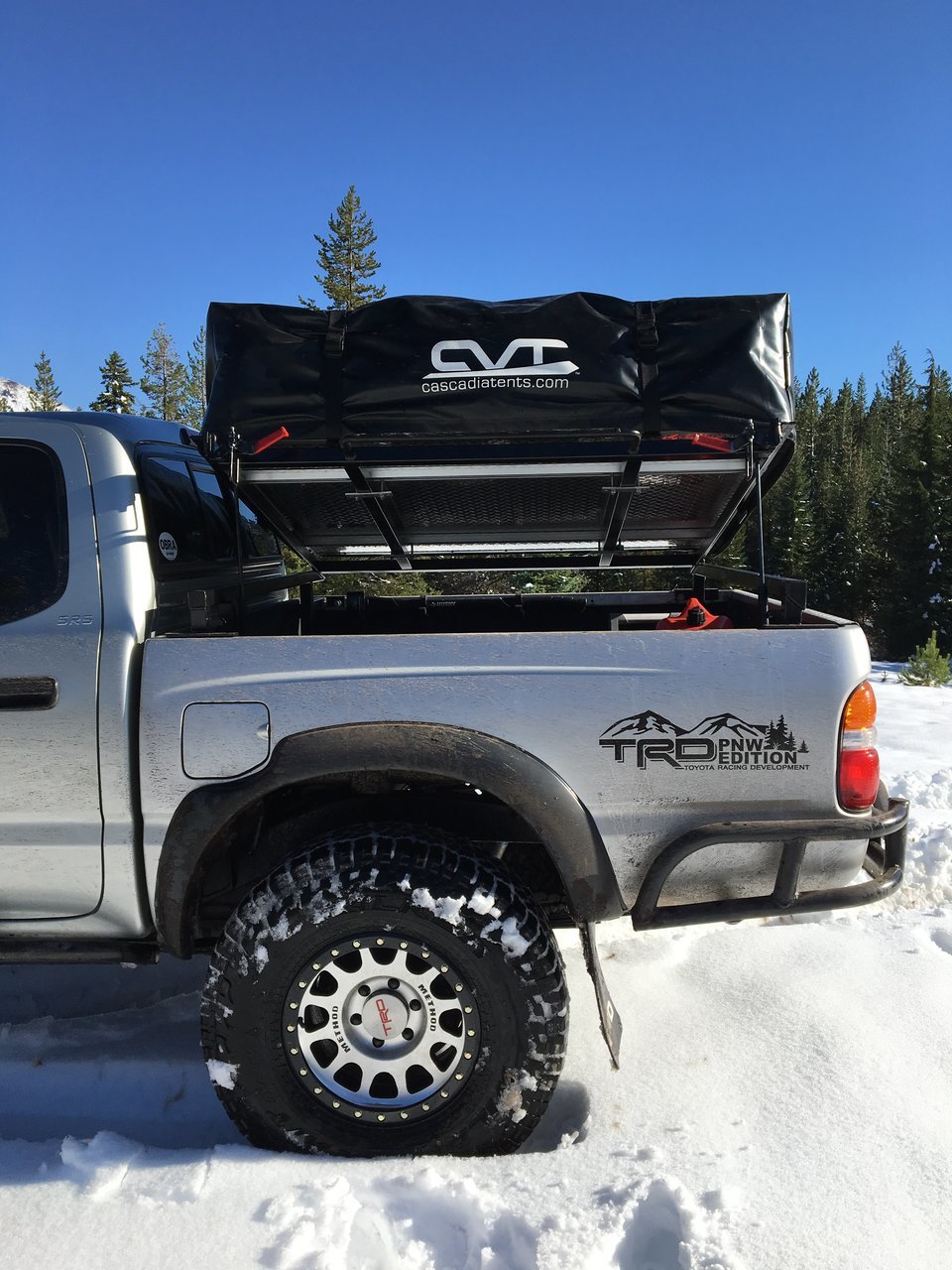

  17. Oct 30, 2017 at 8:03 PM
    #37
    nw_chris
    Aug 12, 2016
    #194416
    350
    Albany, OR

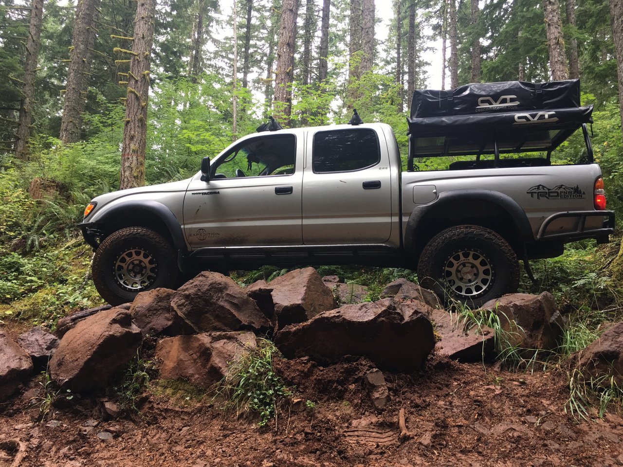

    2022 DCSB TRD-OR

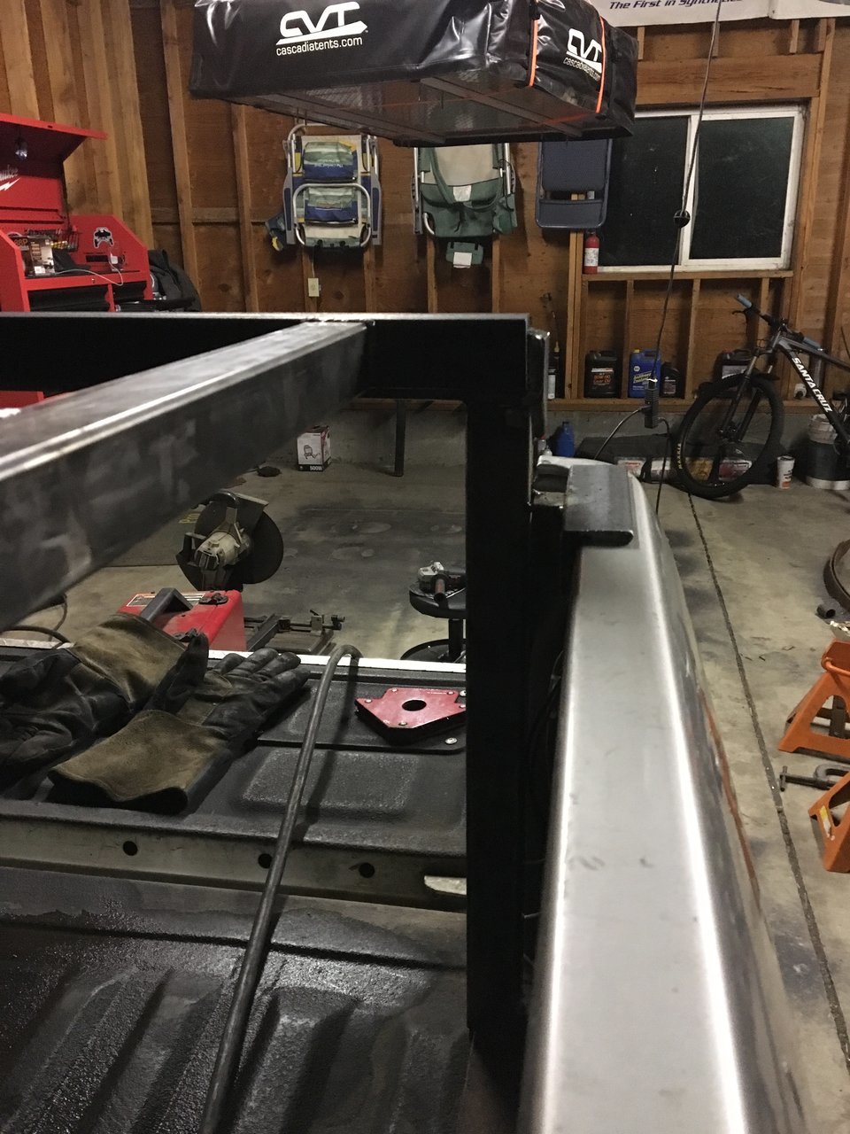

    Decided it was time for a new bed rack for the RTT. The goal was to get the tent down lower to increase mpg on the highway and COG while on the trails while still offering access to the bed. I pulled ideas from @Blackdawg ‘s rack on frank. I had to come up with some creative gas strut mounting since the double cab bed has the wheel well in the front right in the way. For height I wanted to keep the tent below the cab while still being able to fit all of my gear below. This is what I came up with.
    Legs
    Tent base frame
    Added some bed rail mounts to brace everything and achieve some ridgity
    Finished product! W/ 100 lb struts and 2000 lb locking latches with greasable hinges.
