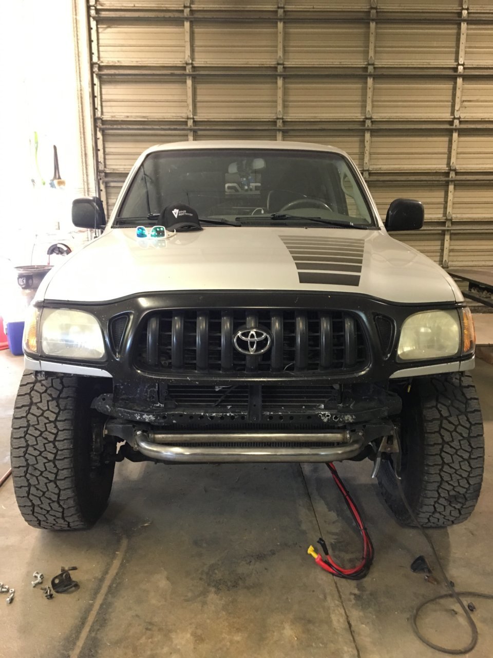

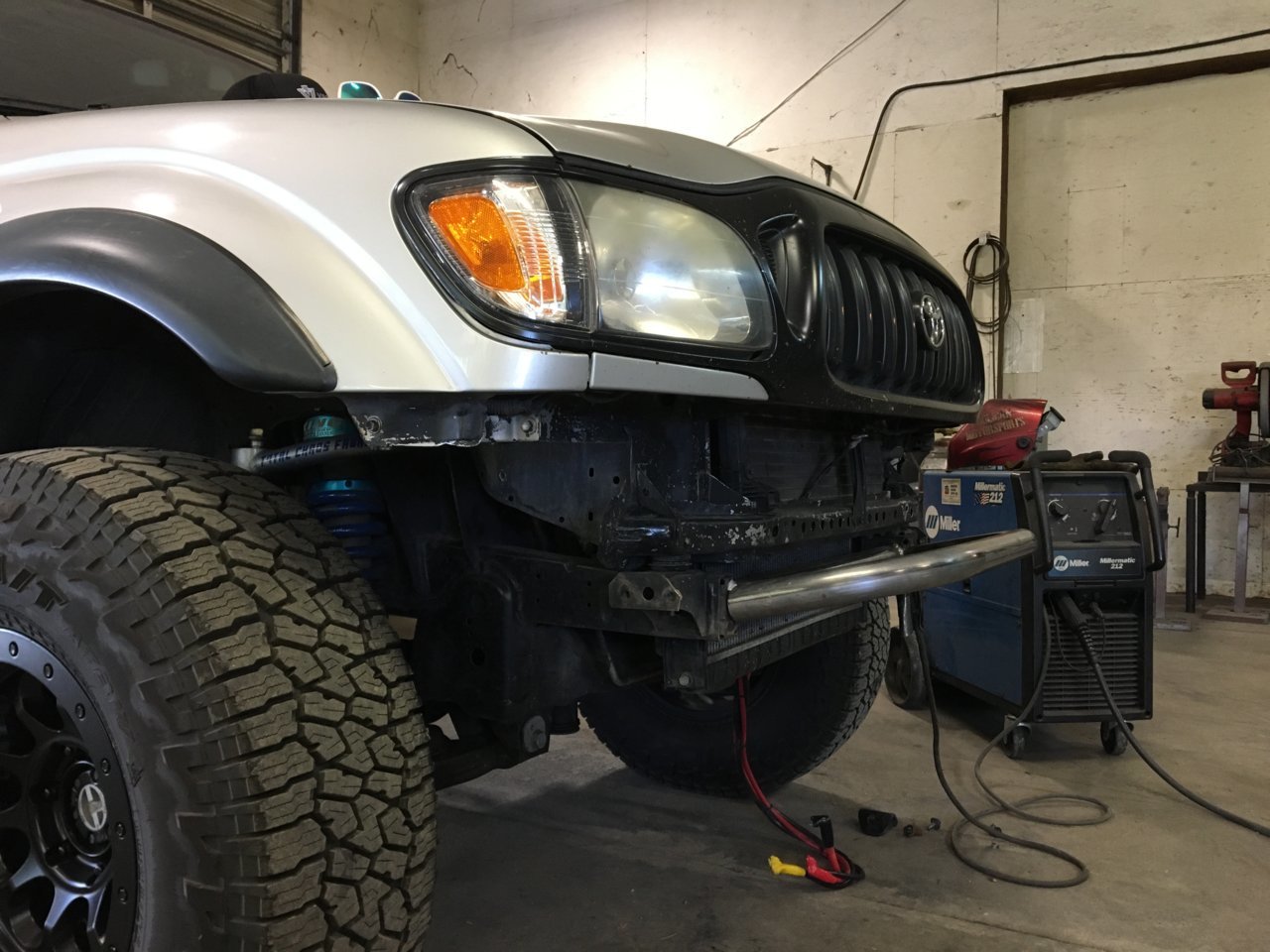

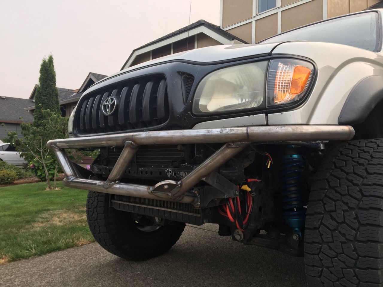

    After rigging the bumper to fit the winch I decided I was unhappy with it (first world problems). Then after seeing how clean and simple @Spoonman ’s front bumper was I knew it was time for a change. Posted up mine on Craigslist and after it sold started on a new one.
    Before

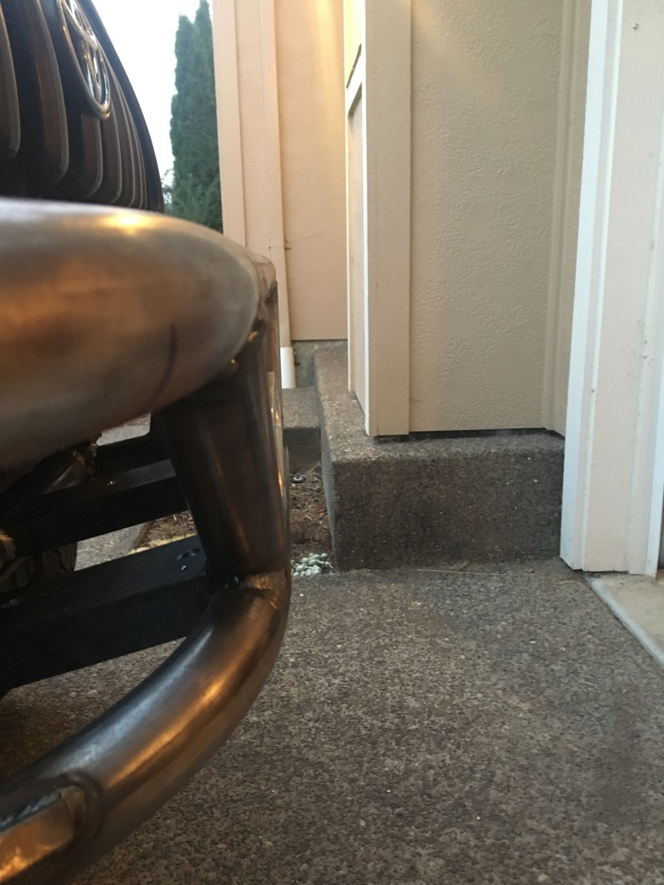

    The goal with the new bumper was to be designed around the winch, add recovery points, higher clearance angles, less bulk and better lighting (big lights didn’t produce near the power of a simple bro bar).

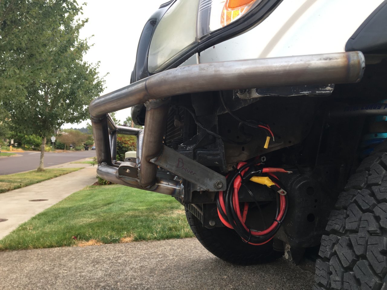

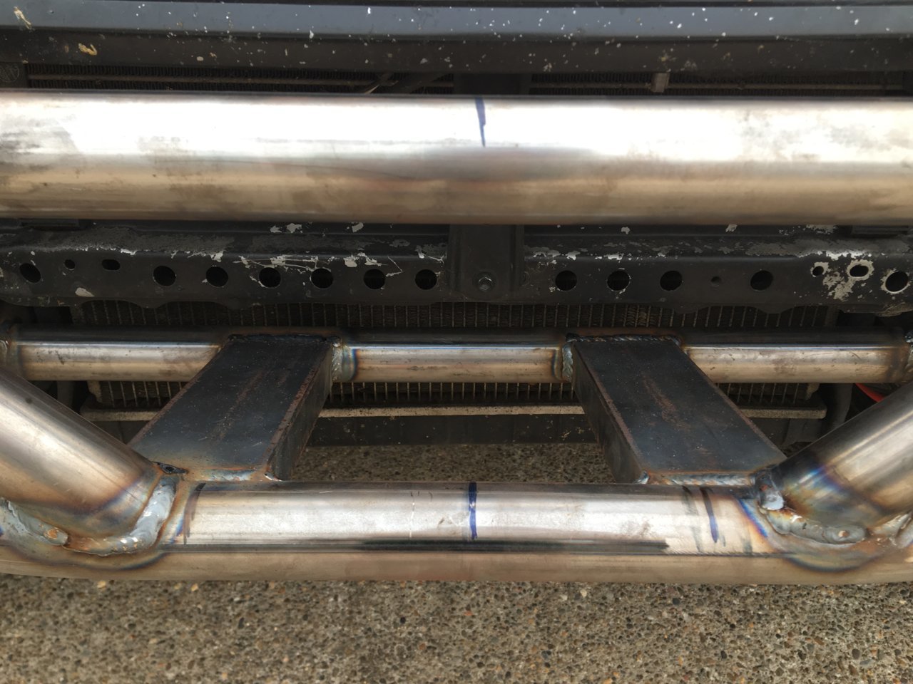

    Started by boxing in the front of the frame and adding the main base hoop. My buddy with the bender came up with the idea of angling it up for better approach angles and a cleaner transition line into a front skid.
    Next was actual dedicated winch mounts made out of C channel which will also help box in the main hoop for strength.
    Added side braces to the body mounts for strength.
    Bla bla bla bumper
    High and tight
    Recovery points

    Drop bracket lift and booger welds
    So you just welded the tube straight to the frame? I guess if you ever want to change it it's a matter of chopping it off?
  4. Aug 14, 2018 at 10:16 AM
    #84
    nw_chris
    nw_chris [OP] Outside Everyday
    Aug 12, 2016
    #194416
    350
    Albany, OR
    2022 DCSB TRD-OR
    Yea I wanted the front of the frame boxed in. Might be all in my head but seemed like a weak point.
    I only ever took the last bumper off once and that was to sell it. Figured it would be simpler and super solid to hard mount the bumper. If it ever has to come off for some reason I’ll just have to grab the torch instead of wrenches. Bright side is no one is stealing it haha

    It most definitely is a weak point, I've seen the frame rail bend when someone was using the stock recovery hook (including my old frame). Looks good dude. :thumbsup:

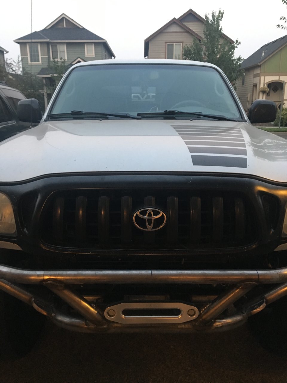

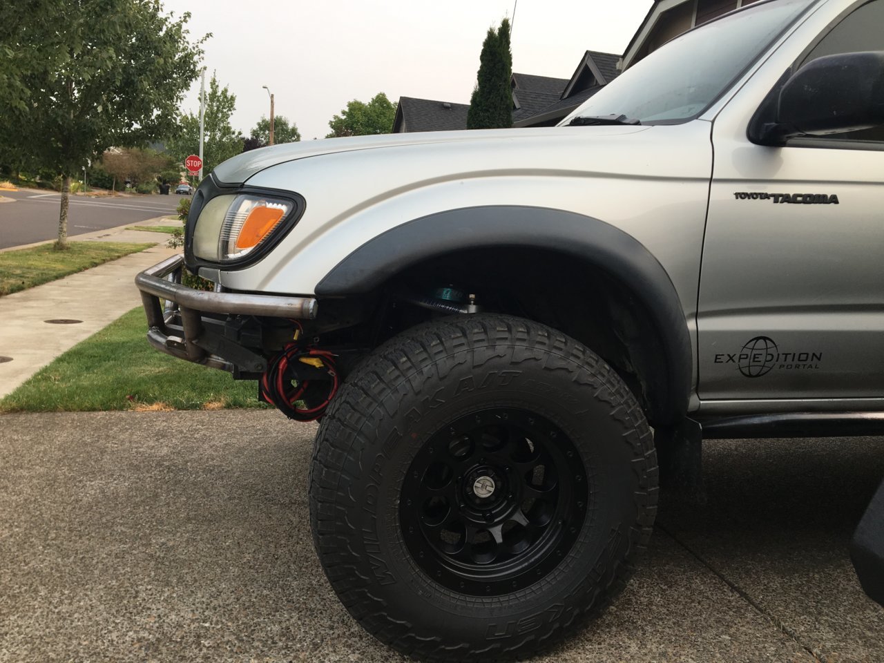

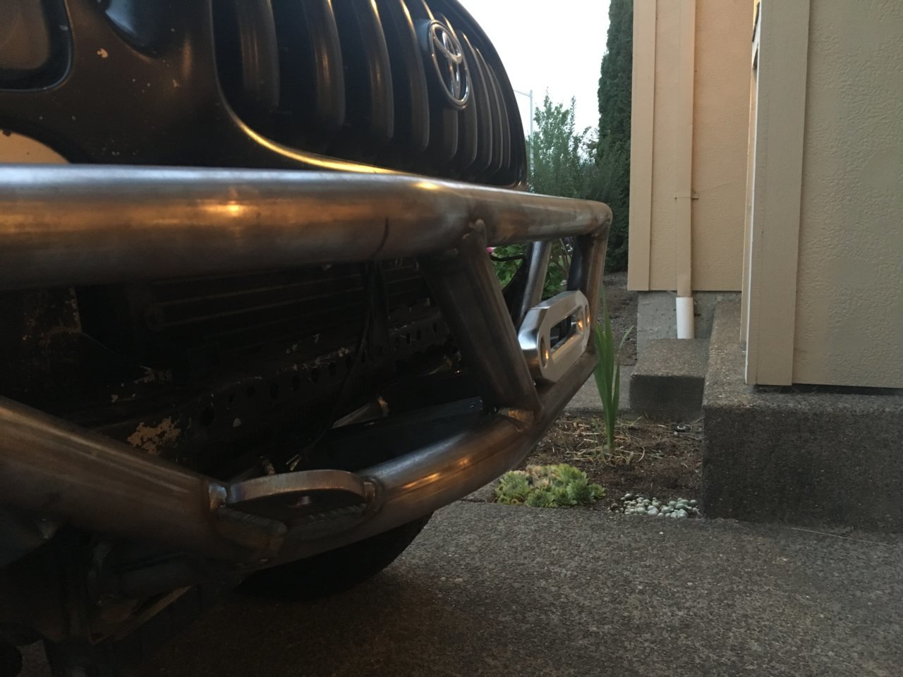

    Minor progress today but hey it still counts for something ha! Got the holes drilled for the winch mount and cut up some brackets for the fairlead.
    Keeping with the new theme, high and tight. Fits like butter.
    Just need to make light mounts tomorrow and then paint. Can’t wait to get it done because it feels like a step back to where I already was. Failed the do it once do it right moto. But then again there is always room for improvement..

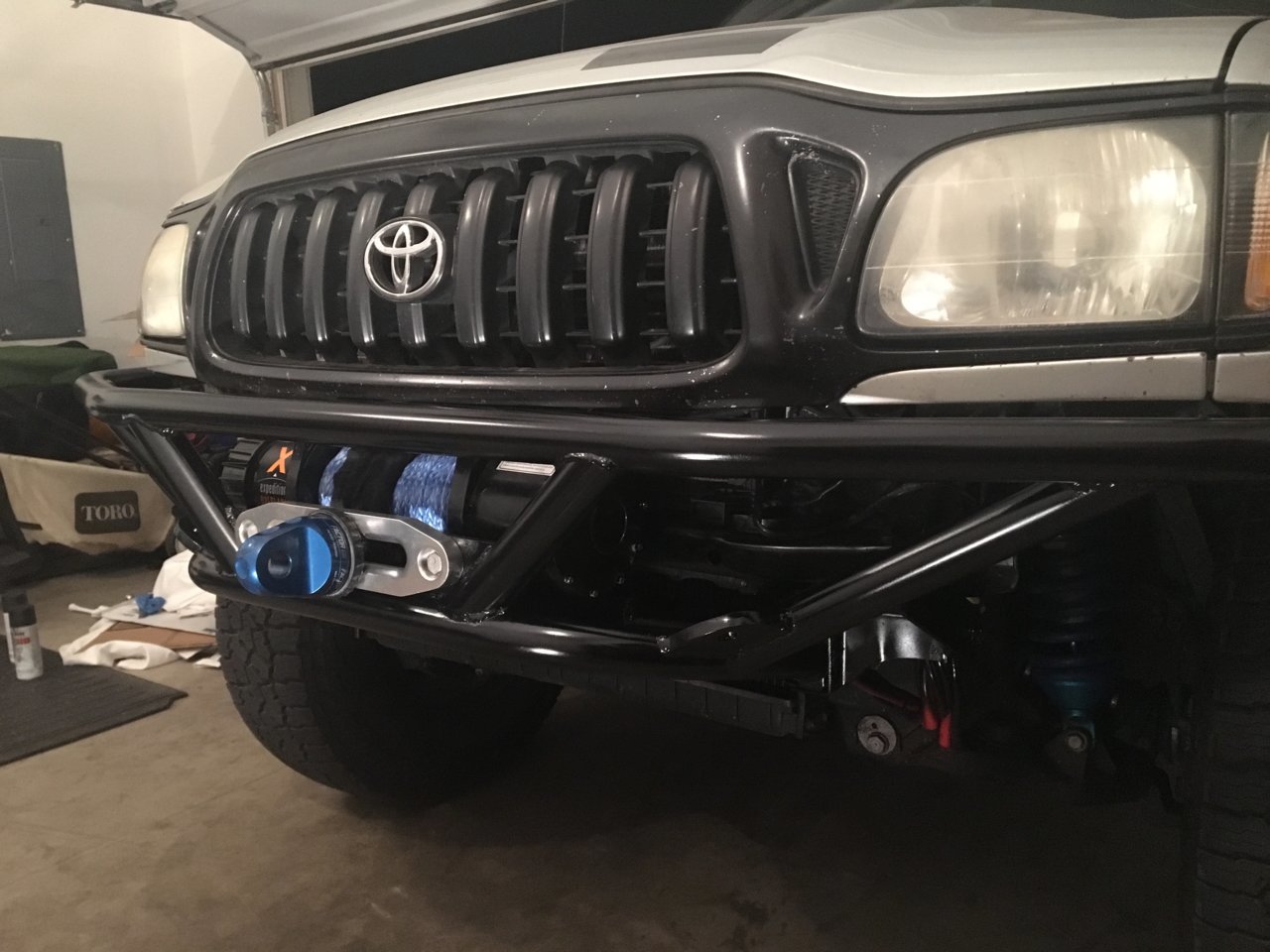

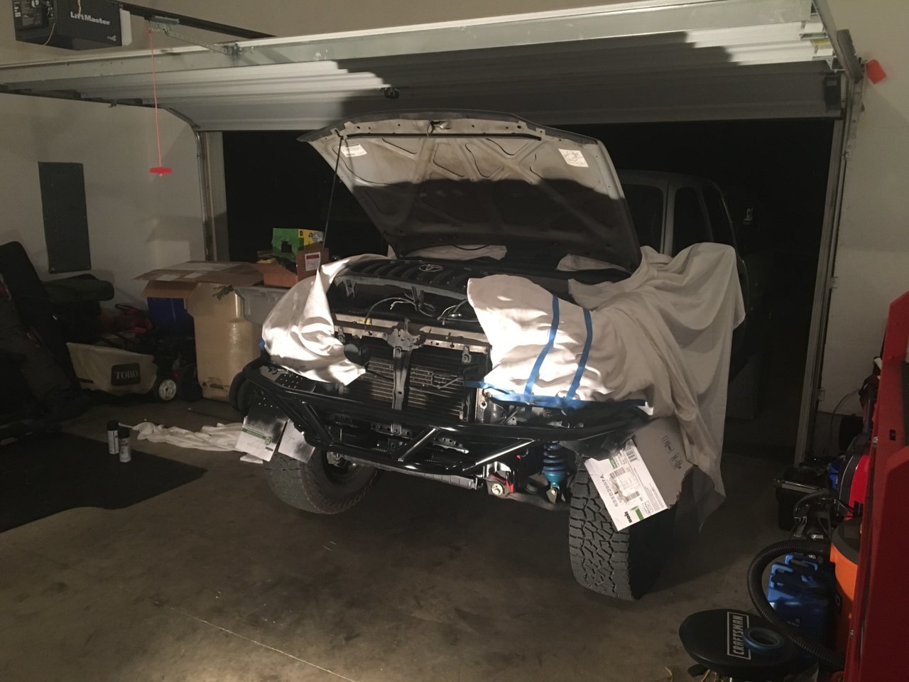

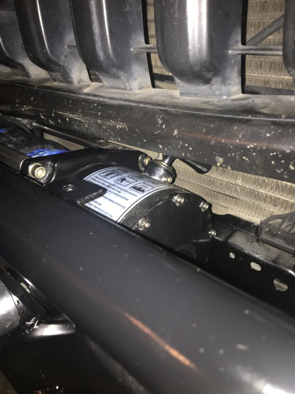

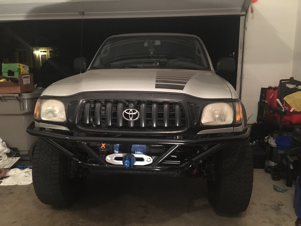

    First off sorry for the dark garage pics...
    Tonight’s progress, tabs for lights made and welded on (should be here by the weekend). Taped off, covered and painted!

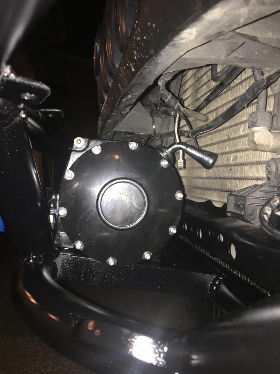

    Winch and fairlead installed.
    Had to re-clock the winch to clear the front bars. Reverse clock clears the radiator and the grill so I didn’t have to chop it up! The lever looks insanely tight in the pictures but there is actually more clearance than there appears.
    I’ll get some better shots during the day after the lights come in and I get them mounted up.

    I clocked rearward for the same issue. I kinda love how tucked it is. So low profile clocked rearwards. Dude the bumper came out great with the winch in and painted. Super clean work. How do you plan on mounting a skid now? Or do you plan on adding a skid at all?

    I want to get a 4cyl radiator so it doesn’t hang down so low. After that I planned on making my own skid. Figured it would be easy enough to just weld some mounting tabs on and bolt it up. With the radiator out of the way it theoretically will be simple to make. Should have a way better entry angle being able to tuck it up too.

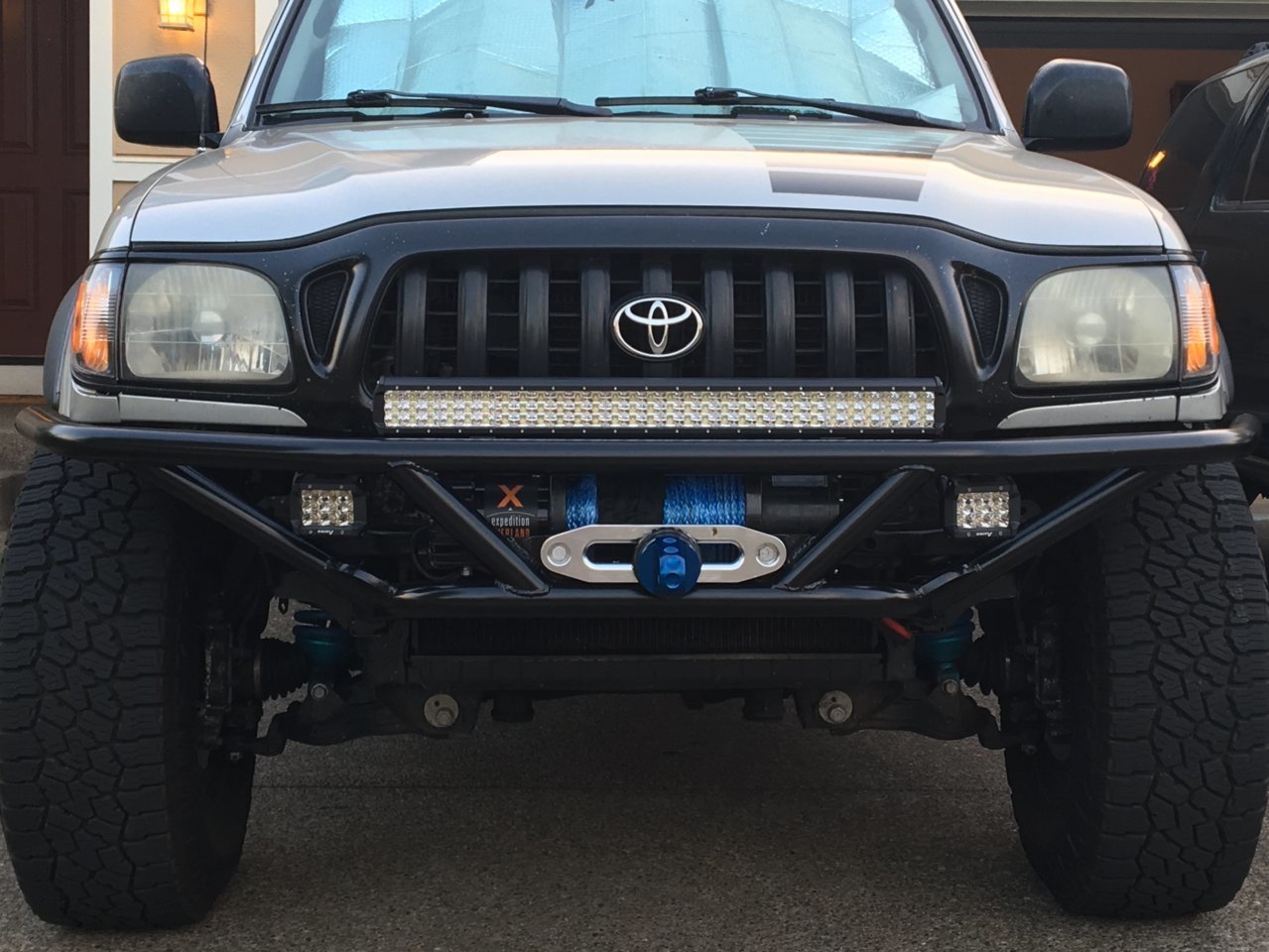

    Got the lights on and everything is wired up. Definitely brighter than the old setup.
