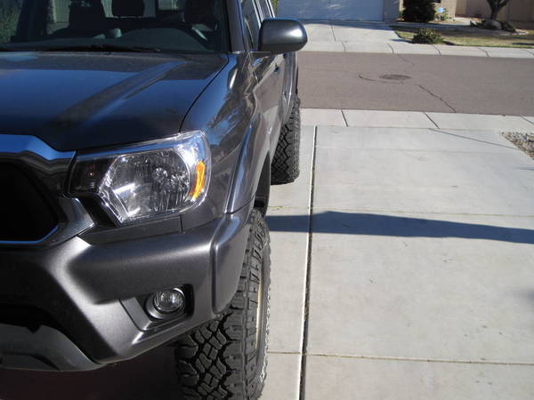

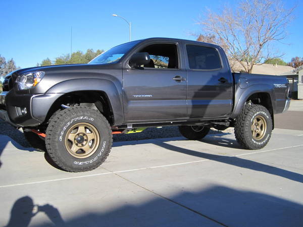

    After few debates I decided that the perfect offset for a Tacoma is +0mm.
    That being said, I ordered a set of Stealth Custom Series rims. So far there's no need for BMC. Enjoy the pictures:
  12. Feb 27, 2013 at 10:28 PM
    #32
    SCSPerformance
    SCSPerformance Stealth Custom Series™ Vendor
    May 25, 2011
    #57195
    5,935
    Vin
    Bay Area, CA
    2005 Tacoma
    Camburg LT kit DMZ SUA kit SCS wheels Destroyer Gray
    That looks great Big G! You should receive the darker grey decal by tomorrow. I think they will match the truck a little bit better.
    If you get a chance, take of the rear wheels and shoot a couple coats of semi-gloss black on the rear hubs. It will make a nice improvement;).
    Don't hesitate to contact me if you need anything else.

    Looks good man. How much trimming was done?

    As right now, none. For every day driving I'm good. I might have to do some for OFFroading. That's why I was trying to find the perffect Offset.

    Hey Vin! I took your advice and this is how it looks.

    That definitely looks a lot better! Nice work.
