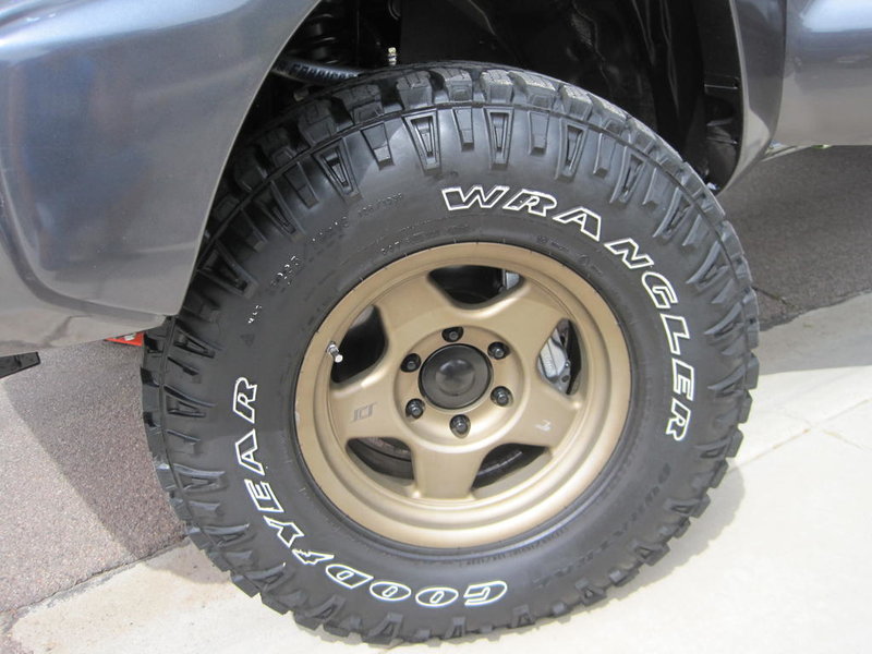

    Can we have a pic showing how much clearance on uca after new wheels?

    As right now I don't have a better picture, but I'll try to post one ASAP.
    4.5" backspace it clears the UCA very nice, almost a inch( 3/4" if I'm not wrong)
