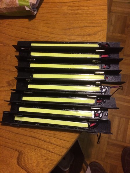

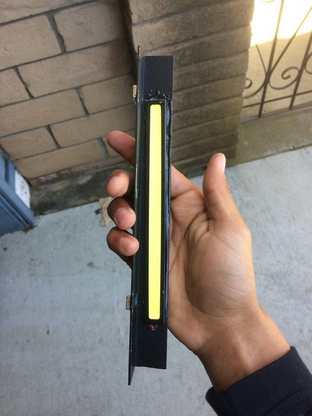

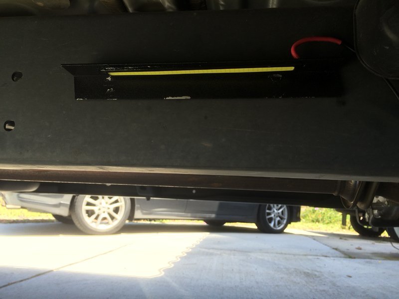

    So this weekends project was making rock lights to install on my truck for a cheap price and one where I can easily remove one if it goes bad or anything. I am not taking credit for this as I have seen @Base Camp and some one whose name is blanking me.
    What is needed:
    Lights : these are RioRand 2-piece lights http://www.amazon.com/RioRand-Waterproof-Aluminum-Daylight-Vehicles/dp/B00C1YI2XA
    I have 8 in this picture and am working on another 8.
    Rare earth magnets: I found some cheap ones on eBay but not sure if they are the best
    Aluminum angle 1 inch and 48 inch long X2
    Lastly you need a two part epoxy hardener which I used the heavy duty stuff.
    This is a super easy project, cheap, and replaceable. for added strength you could probably bolt them to the frame or use double sided tape and the magnets.
    IMG_7973.jpg IMG_7974.jpg IMG_7976.jpg IMG_7985.jpg IMG_7978.jpg IMG_7981.jpg
    As you can seat easy to do and you can put them any where. I plan on using 14 or so with 4 for wheel wells, 8 on the frame 4 on the outside and 4 on the inside, and then based on the remaining lights I have ill use them to add more light to the front bumper or the rear. Hopefully this helps anyone who wants to build cheap rock lights. If you want to see pics of them installed Ill have them wired up next weekend.

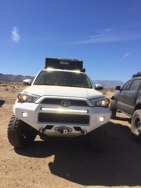

    Here we see Mrs. Satin Pelfrey in her sexy 4runner decked out with extended travel kings, Goosegear drawer system and frontrunner rack which holds the CVT Mt. Shasta. Oh and can't forget the front bumper with Bajalights. I personally love how the front bumper matched the cars lines and provides a good amount of airflow without any obstruction.

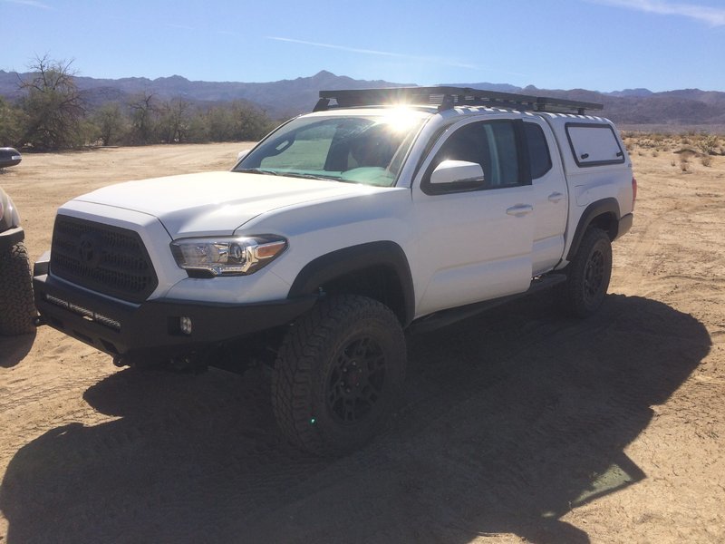

    From here we would follow down through some sandy curves till we met S2 which would take us to the trail head and a little fun in the sand. Of course we had to all do donuts and make a mini sandstorm. Here I took a moment to take a picture of @Brosefff 2016 LT taco which has to be one of the few 16's I actually enjoyed seeing.

    Nice job @Pirhett . Cant wait to see the night shots...
    Also to give credit I believe @SMKYTXN did the original. @Bsheriff11 and I think @geekhouse23 have done it also. I found that on some of the magnets the epoxy failed over time. I tried gorilla glue and that seemed to do the trick.

    Thanks man I wasn't sure who the OG of the idea was. Yeah I think I'll throw some double sided too just to be safe.

    Oh smart idea! I think Ill try this out and I used the heavy duty epoxy so maybe that will help along with some double sided tape. Thanks for coming up with this idea man and thanks for letting me use the idea!
