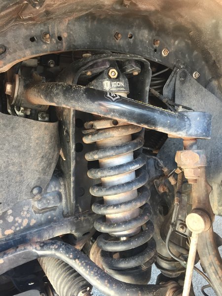

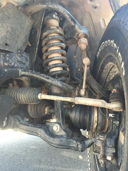

    hey guys, a buddy of mine was wheeling pretty hard and hit a dip and now when ever he drives its fine till he hits a bump then it makes a gnarly sound. I though maybe top hat or shock tower. Here are some pics any clue?image1.jpgimage2.jpg

    @Pirhett is the shock bolt and top hat still in one piece? Shock looks a little far up in there...

    Not sure how old those top hats are but at one time Icon had problems with them cracking in half.

    @nfs257 @Pirhett As far as I can tell poking me head around in the wheel well both appear to be fine. Haven't had the time yet to jack it up, plan to meet with my mechanic friend tomorrow and jack it up.
    The issue is mostly with hitting dips, makes a thud sound and you can almost feel it under your feet in the driver seat. I have grabbed and tried to shake or move pretty much anything you can get your hands on in the wheel well and everything is solid. No apparent breaks or shearing on anything visible.

    @mwvare I would pull the sway bar and see whats loose...

    @nfs257 Theyre on a 2013 Tacoma off-road and the icons cannot be more than 2 years old. The owner previous to me had them installed (I'm the second owner). Had it in moab a few weeks ago and everything was fine then.

    check the cam bolts they probably came a little loose
