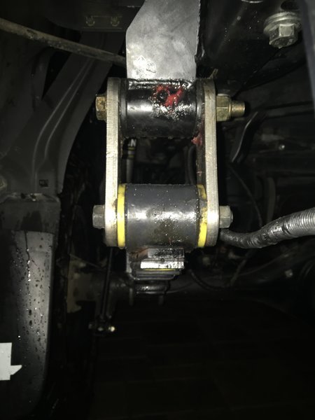

    Well heres the list
    Done:
    -remove fox shocks
    -remove factory and aal leafs
    Need to do:
    -Grind, punch, and drill stock shackles
    -Install new icon 2.5 rr
    -install archive garage shackle flips
    -Install dakars
    These rivets are a pain though so I only got half way through one side.
    deeezy likes this.
  8. Nov 28, 2016 at 7:48 AM
    #1128
    Pirhett
    Pirhett [OP] Instagram @pirhett_ship
    Jan 29, 2015
    #147498
    5,219
    Rhett
    San Diego
    2014 TRD Sport 4x4 DCLB MGM
    Stock...
    Well from Friday to Sunday morning I was able to tackle one side of the truck haha! Finally called up my buddy Dan who is opening an aamco in chula vista Dec.3, He came with his master technician which was over kill but definitely sped things up. Hour and a half later the other side was finished! I found out this morning that where the resi meets the shock body I have a very slow and small leak. Guess when they were rebuilt the seal wasn't replaced :(
    So now things to do:
    -Fix the shock this weekend hopefully
    -Cut the u bolts from my flip kit since there is about an inch and a half of threads showing.
    -Buy the 5 inch daystar bumpstop from 4wheel parts since I am currently bumpless
    Tips:
    -When drilling out the 8 rivets have the right tool! This meaning a corded drill because running back and forth with an 18v dying every 10 minutes doesnt help
    -Have a bit meant for drilling metal specifically with cutting oil
    -If the shackle looks inverted its not, it will correct itself once tires are on
    -Dont do it on the one weekend it rains in san diego
    Thanks to @zeekevin and @Tombiology70 for the jack stands and the grinder without those the job wouldnt have been possible :cheers:
    All in all I like the way it drives, much smoother and you can definitely feel it articulating. I did however gain about an 1.5 to 2 inch in the rear:benchpress:. Couldn't fit in the parking structure since my CVT RTT ladder sticks up higher than the rest I was unable to fit. Didnt take a whole lot of pics but I will post some of the ride height and all shortly!
    ChandlerDOOM likes this.

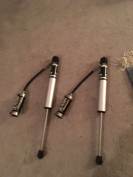

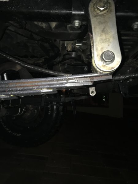

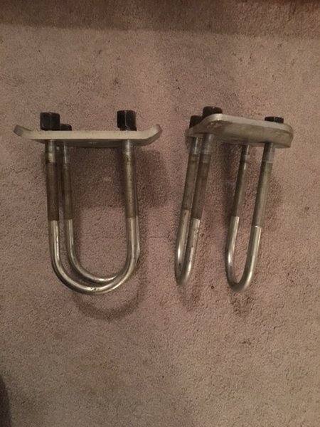

    Here is a pic of the reverse bro lean, beefy new u bolt flip kit, and the icons
