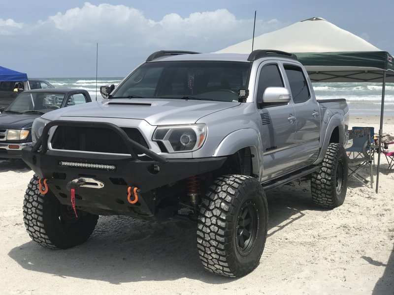

    time to update that first pic

    Well the front bumper on it right now weighs a metric ton.

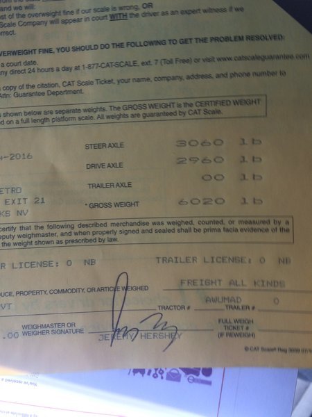

    This was before bed cargo slide, frame plating, rear shock relocation, propane tank, and camp table:

    Good lord! Thats a big bitch

    :eek: with tent?

    Any negatives to running over GVWR constantly?

    I want to weigh mine. I'm curious now. Where did you go to do this?

    IMO, yes. But I also didn't want to spend inordinate amount of time cycling to get the shackle positioned in the right spot and un-dovetail the frame. For my purposes and requirements, I get down just fine with factory geometry and it rides titties.
    Yes. And roof spares.
    Gas mileage and brake fade. Also one of the reasons I did the BBK.
    I got mine done at a local TA truck stop with certified CAT scales. It was 9 or 10 bucks and has different pads so you can get separate weights for the front and rear axles.
