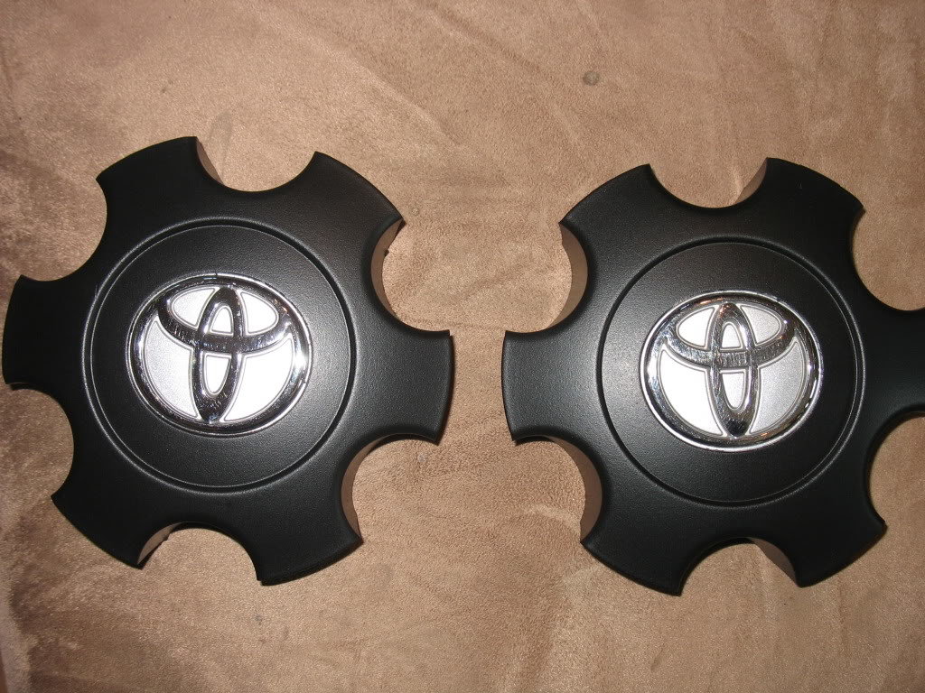

    anyone ever plasti dip the rim, but leave the toyota logo stock color??? and if so how could i do that easily?

    The best way I could think of doing that would be to pop off the center hub and go find the thinnest tape you could find. Put tape all on the tacoma emblem and then spray. just a thought

    Did my tundra C-Caps...made a round sticker and peeled it off very carefully using a toothpick to break the edge...logo itself would be really hard!

    I did 3 coats. I may try again this weekend. Maybe I was too rough with the peeling off process or just need to let it dry for a few hours.

    Dang those hubs looks really good

    No need for a link... You quite literally place cards (I used index cards when I painted my wheels) in between the rim and the tire. Just stick them in there, forming a cone of sorts to keep the excess spray away from the tire.

    I let mine sit for at least 2 hours before i went and peeled them.
