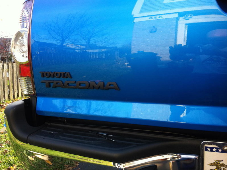

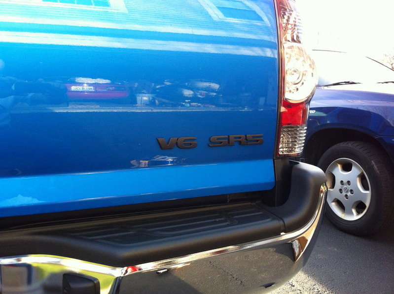

    Yes Bassman, planning to dip the fenders on speedway blue Taco, tomorrow if it's not too windy.
    So, I did some dipping today. Holy crap that's a scary thing, spraying what looks like black paint onto my brand new baby!
    I started small and did a couple emblems on the tailgate, I like the looks.
    It wasn't difficult but a bit more tedious than I thought. I started off with very light coats, maybe too light. Used a heat gun between coats, switching from emblems on left and right of tailgate about every 5-10 minutes between coats.
    All in all, I like it. Wife thinks it's stupid so, it must be cool. :p

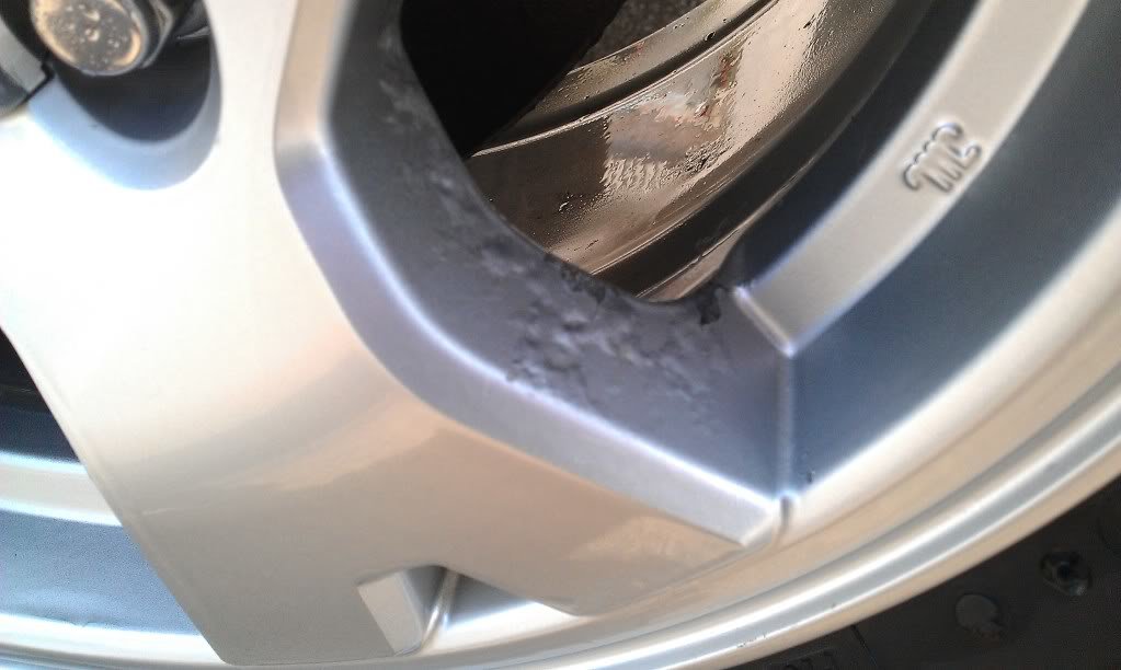

    Interested in dippin my stock wheels, but i've never used the stuff before. The paint on all 4 wheels is bubbling/chipping pretty bad and looks like doo doo. This picture is from about a year ago, and they have gotten relatively worse since then. Anybody out there plasti-dipped their bubbling wheels? What kind of prep work do you guys recommend to end up with the best results? Thanks

    's all pretty much the same process. if you want to sand that down or get rid of the bubbles do so BUT when you take the dip off, remanence will show. Take rims off (one by one is fine, I did it that way). Wash with soap and water, just get all the residue or as much of it off as you can, then dry off completely. Dip and water aren't friendly (they won't mix). First spray on a "primer" coat, meaning that you just get spots here and there so that the next coat has something to cling to. Second is getting spots you missed, third is an actual coat. Now the Fourth or Fifth coat (if you choose) are mainly for touch ups, missed a spot, etc. etc. Then let dry for maybe 30 min. minimum .... or get a hair dryer and braze it till it's dry. I like doing it on hot sunny days since the sun will heat up the rim nicely when letting cure (I left mine alone for a complete day, did also my badges and several other things and have washed it via cash wash slapper about 7/8 times already).

    Thanks, so if I decided to just dip it as is,would you think 4 or 5 coats will be be thick enough so that the bubbles don't show up under it? My reasoning is that if I do decide to take it off for whatever reason, I'd like my wheels to still be in descent shape, respectively speaking, not scuffed up from sanding...whatchu think

    since your rims have wear, I would concentrate on just the outside where people can see them. Not many people would go the full mile and fully inspect another persons rims like that normally anyhow so the "wear" won't matter. Just make sure you get it off the front as much as you can.
    I wouldn't do so may coats, the thicker this stuff is, the easier it is to take off ... although I did my front tacoma emblem with 5 coats, BUT again I left it to dry for a complete day (dip is still on it like I had done it the day before).
    I wouldn't worry about the overall look, dip is like a cover up of some sort, which I mean unless someone is REALLY into your rims (purchasing or something) then I would take off the bubbles and go the full mile of sanding/etc. the rim. I doubt anyone will notice the bumps when it's been dipped.
