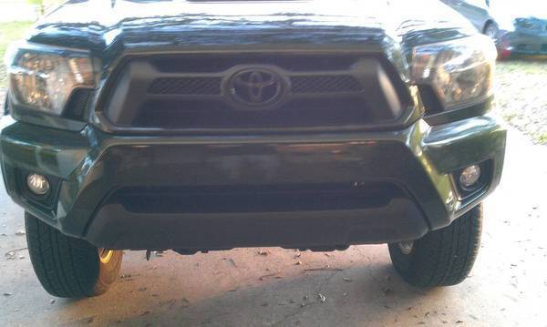

    Just did my lower valance & wheel center caps today.
    I think the valance looks better black.

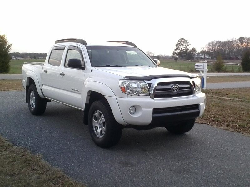

    0112131736a.jpgI joined the family today ...

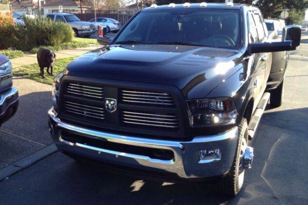

    My buddy dipped the outer grill on his Dodge today. Came out pretty well for taking <30 min.

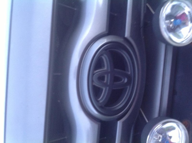

    Dipped my front grill emblem and badges today

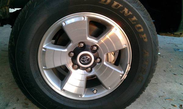

    Has anyone painted their wheels without removing them from their truck? I don't have a jack or torque wrench.
  9. Jan 13, 2013 at 5:00 PM
    #2989
    Eat Sleep Fish
    Eat Sleep Fish Member
    Jan 12, 2013
    #95020
    6
    Devon
    Texas
    2005 PreRunner
    Yeah people have, you need to cover your brakes and behind your wheels pretty good as well as clean your wheels really good then figure out how to mask them off while they are on. I know some have done it I forget what page it was though.

    you can always use your jack stand that came with truck...remove tire paint then put back on hand tightened then go to tire store to torque to spec

    no problem. i used this method and it works great!

    Hmm... That seems a lot easier! Last time I took each tire off one at a time and taped everything off including the tire! Does it really come off the tire that well?

    yeah it does. i didnt even mask off the tire. and it comes right off. and after awhile it will just come off the tire on its own and will blend in

    I just wiped some tire shine on the tire, carefully so not to allow tire shine on the rim. The tires shine allows the Plastidip to peal off with ease!
