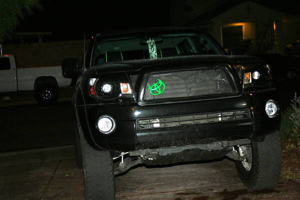

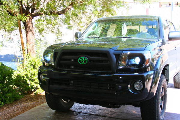

    [​IMG][​IMG]
    Here are a few from the past. For some reason the ones of my rear bumper won't load. The grill and bumper were chrome though since I have the TRD O/R. You can kinda see the rear bumper but you can fully see the grill and rims

    I used Rustoleum Fluorescent Green. This is actually from a few minutes ago. Changed out the mesh on my Satoshi and repostioned my devil horns.[​IMG]
    By the way, where at from AL? I grew up in Montgomery, lived there from 2 yrs to 21yrs then joined the military.
