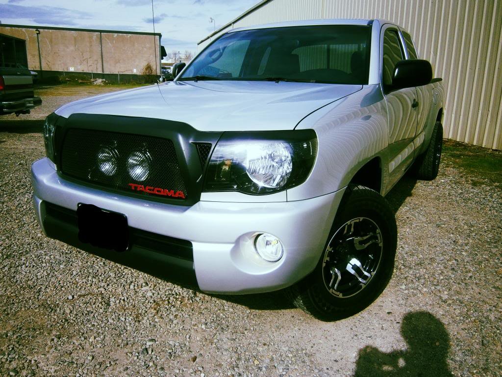

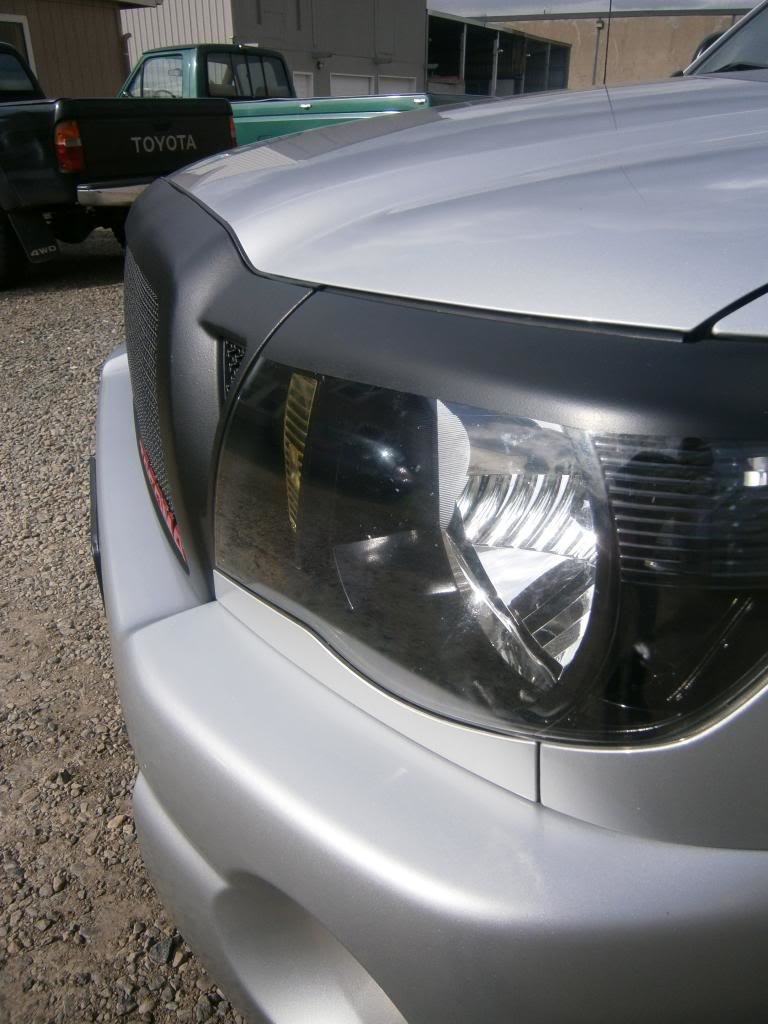

    0613f70a-8441-4941-8c10-dc69f1731279_zps_67ce779f4a17dcf37ab7a21d8aca08ea3a361fba.jpg
    1be215fa-a934-4e8c-9423-b8501ddcdc89_zps_9eddeecafc05dfdad2696b767a1fe7f03b798d4d.jpg
    Did some eyelids! Took a total of ten min!

    How is it holding up to the heat of headlights?

    Haven't had any problem! I had my lights on for about 3 hours last night with no problem.
    I have seen people doing their exhaust with it.. and it lasting!

    How'd you get the nice clean line on the lids?

    Painters tape

    It's tricky though. You either have to be quick and spray your coats fast and remove when it's still wet or let some time between coats and let it tack up and use a razor blade VERY CAREFULLY. I did the latter and they came out fine, no damage to the lens.

    I used electrical tape for the peel line. I peel it at almost a straight down angle to give it a sharp edge where peeling. As well as doing a quick 4-5 coats within 3 or 4 min, and peeling right away.
    I actually blew on them to help speed up the process.:cool:

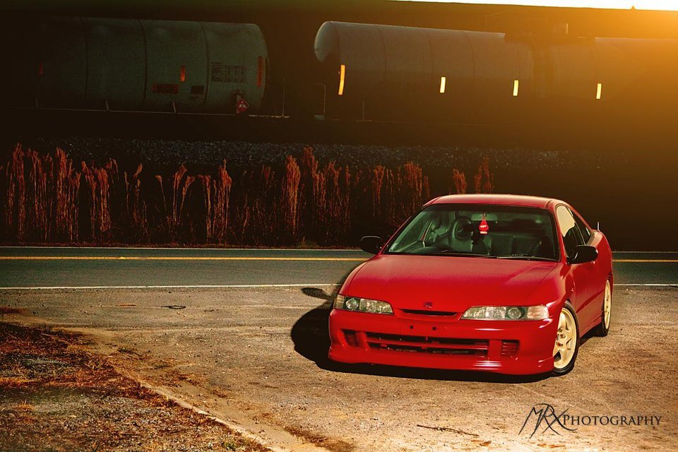

    Now this is Plasti-Dip done right!
    94 Acura Integra in Glossified Red! Wheels are done with Gold Metalizer over a White Base.
