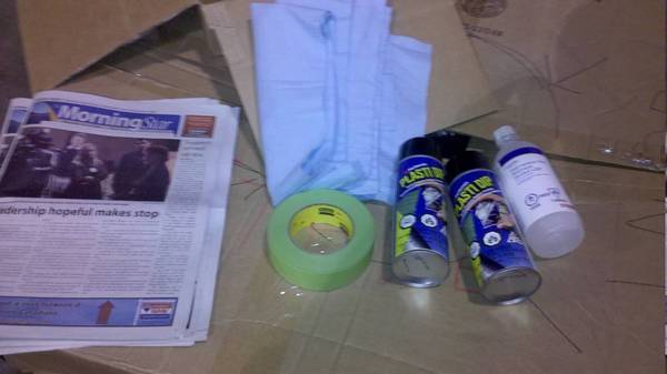

    Man this could not be any easier! There's a few threads on this but I will tell you the deal.. there are plenty of folks over thinking this process. First take a little rubbing alcohol and clean the emblems (just use a Q-tip) then dry with clean rag. Then, get some blue painters tape and some newspaper. Tape off the emblems while still on the truck... tape around them and leave about 1/8" around the edges. Then take the newspaper and tape and cover a 2' area or so around that to protect from over spray. Then spray a coat over the emblem. Don't worry about the paint that is showing between the letters and what not (we'll get to that in a sec). Then save a ton of time...after you spray a light coat...hit it from about 2' away (not to close) with your wife's hair dryer for about 15 seconds...then repeat the process till the whole area is done. remove the tape and newspaper let it dry a few more min with a little help from the hair dryer then take your fingernail and remove all of the excess around the emblem carefully. The gap between the truck and the emblem will cause a natural break in the plasti-dip and allow this to happen. After that, take a toothpick and very carefully remove the spaces in between the letters and in the holes. Then stand back and enjoy. Hope this helps.

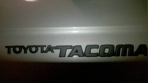

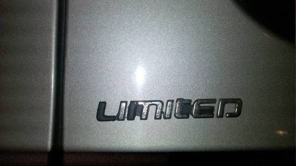

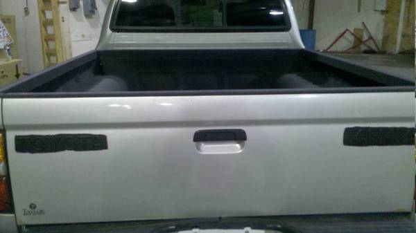

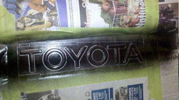

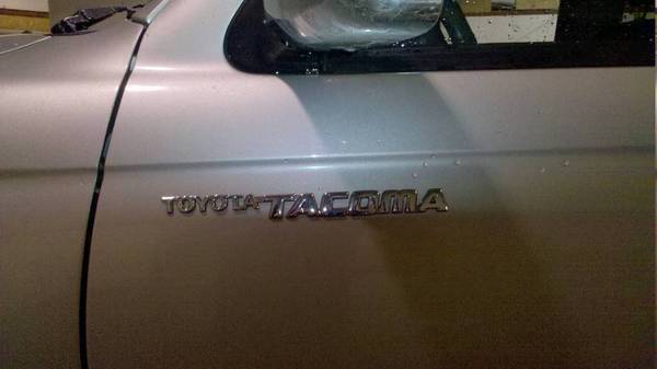

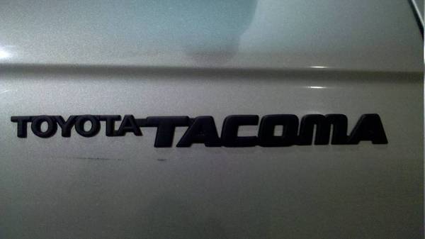

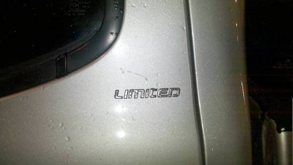

    Attempted to plasti dip emblems on my 2001 today. The side limited and tail gate badges had peeled some of the chrome already, which definitely didn't help. Just thought i'd share some pictures and thoughts.
    A few before shots

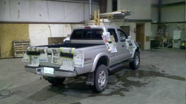

    During

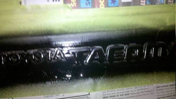

    First badges first coat, put too much and it went to the bottom forming a but of a drip
    First coat rear, put on a lot less..in fact in the end I feel not enough on the rear badge, even after 4 coats; just didnt get enough on there.
    Rear, 4 coats, 30 min between coats and light blow with heat gun for 30 seconds from 2.5 feet away. Peeled tape right after the last coat.

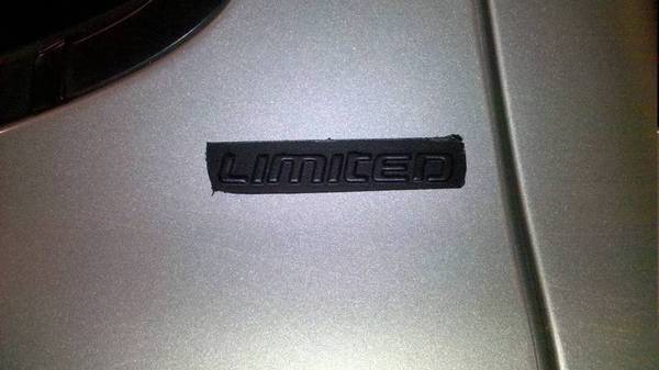

    Used a toothpick to trace around the badges before peeling, it was a mistake and i'll show why a little later. In this photo, this was the overspray first badge. The bottom drip sort of tightened up a little so it wasn't terribly bad. You can see at the top of the m why i shouldn't have traced with toothpick.

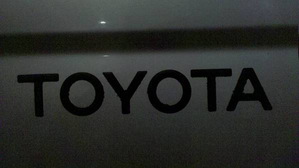

    My best badge and keeper: just peeled all around and came off perfectly, no toothpick. perfect amount of plasti dip.

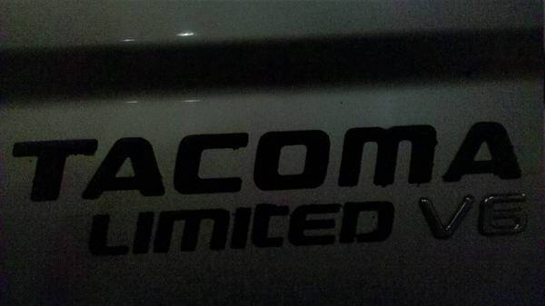

    Others:
    Conclusion:
    Proper badge spray can be achieved. But I didn't pull it off all around this time. I'll work at it to get them all like my passenger door.
