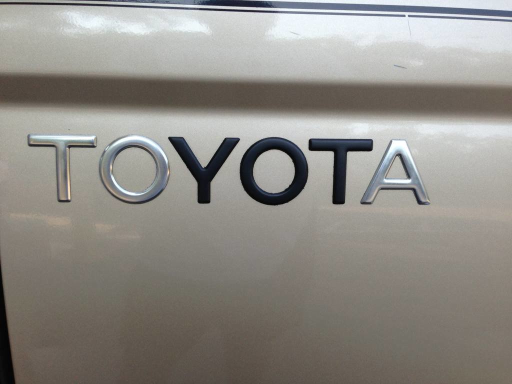

    Yeah no kidding, it dries crazy fast. But I'll go ahead and give it more time between each coat, just to let it set. I'll let the final coat set for like 30 minutes before peeling. Even though its not working I think this stuff is cool. I washed my truck yesterday and the 2 badges that are complete didn't peel or chip, they look awesome. Hopefully I can get the other badges to stick. I've been able to get a couple letters to stick. I'll try again this afternoon, hopefully all letters will be DERPified

    If it's not sticking maybe there is some grease or something on there. Try to use some degreaser when you clean them.

    Also, if you cleaned them really well (with alcohol and all that), but didn't dry them completely it wont hold.

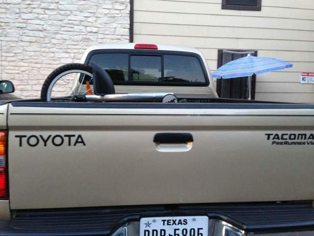

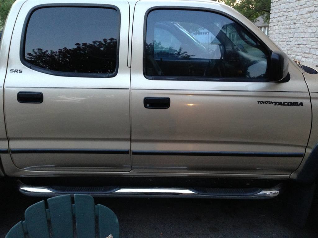

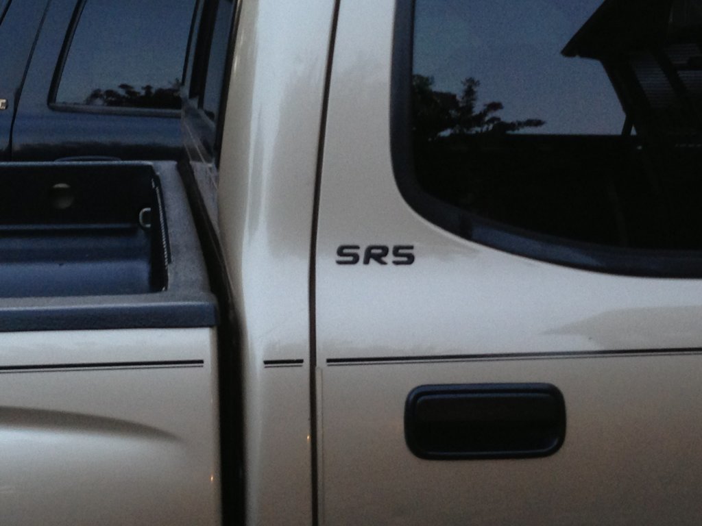

    Finally worked!!! I did 7 "light" coats, but one layer on top of the other added up to very good coverage. If the overspray around the badge is thick then it's gonna be hard to separate from the letters. I made sure not to lay it on too thick, plus I cleaned the areas very well this time. I'm gonna Dip my wheels next, but probably gonna take them off the truck first.ure4utyq_e0241d8c98ed3479eaa0aa226142a100c6033b6b.jpg

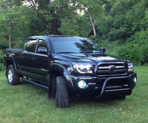

    Anyone ever spray over their fog lights with this stuff? Thinking about hitting my fogs with a light coat of black to dim them out a bit. I messed up and bought the HID 8000 and there brighter than shit. Just worried if I use this stuff its just gonna fall off with the heat.
    183607bc-5ea2-401a-9643-456cee107cb8_zps_8cc158850e4bdb8aa9d12f71f124d4b024247583.jpg

    I think they have a certain type of plasti dip for the head lights/ fog lights. I can't remember the name, but it is from plasti dip. Check www.dipyourcar.com
