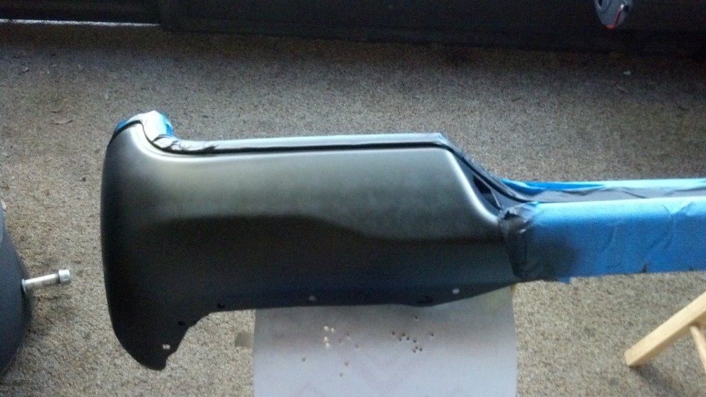

    I had about a half of a can left over and 2 full cans just in case. I started with a couple light coats just to get a good even base and then ended up doing about 10 coats total. I used a total of about 2 cans or a little less. If you do this, make sure to change your spray pattern from coat to coat. You will see what I mean when it is wet. I did one coat with long side to side sprays then up and down on the next, then diagonal etc.
    Here you can sort of see the horizontal lines. This was after about coat 3-4. That is when I started changing directions of the sprays to even it out.

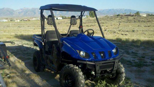

    If anyone is wondering about the longevity of this crap, it does pretty well. I derped the emblems on my truck about 2 years ago. They still look like they day I did them. The real test for me was my Rhino. I derped the entire thing about a month after I bought it, which was a year and a half ago. Around the bed it has started to peel off a little, but with everything I have drug in and out of there it has done a lot better than I thought it would. It still looks good on the hood too even with all the brush and trees that thing has been through. I was thinking about changing the color up, maybe a desert tan, if they make it, or a grey...
    As it started.
    This isn't a recent pic, but this is how it looks derped.
