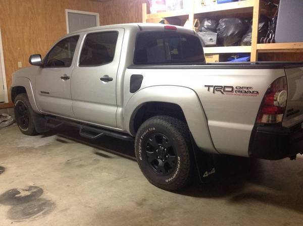

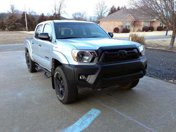

    Fog lights anytime w/key on Plasti dipped gas cover, grill, rear bumper and rims
    url=http://www.tacomaworld.com/gallery/showphoto.php/photo/380251/cat/500][​IMG][/url]
    I haven't had any issues on my bumpers or grill with peeling. Main thing I do is make sure they are wet and use dish soap and water on a microfiber towel to rub down. make sure its soaked. Also pressure washing has been fine too, but I rub down to make extra clean.

    Looks good man , I like the color matched bumper better but that just me
