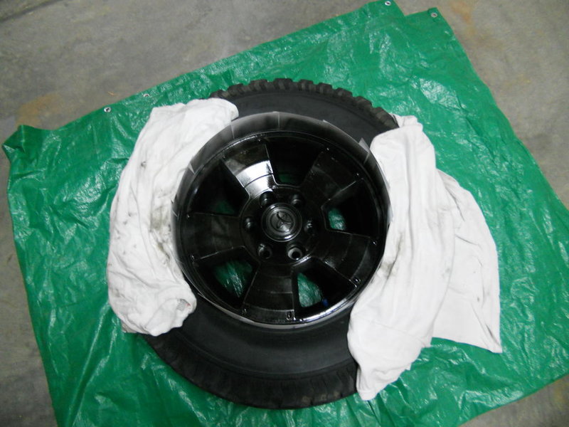

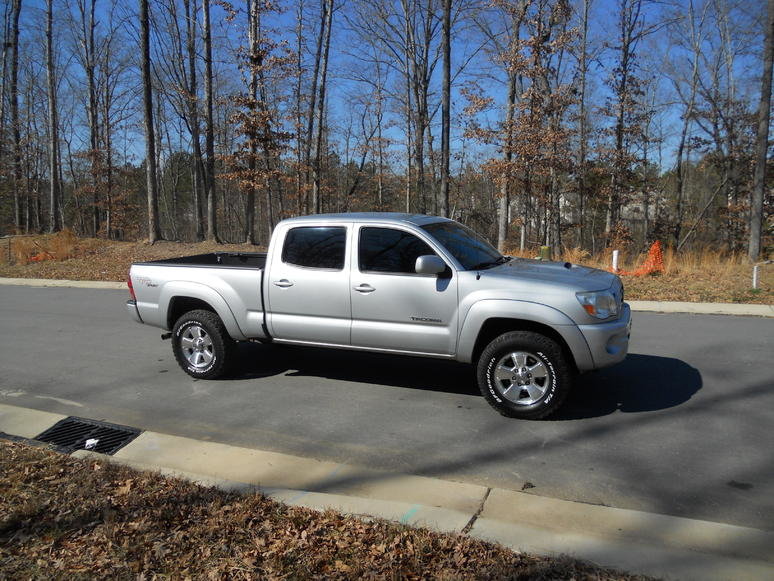

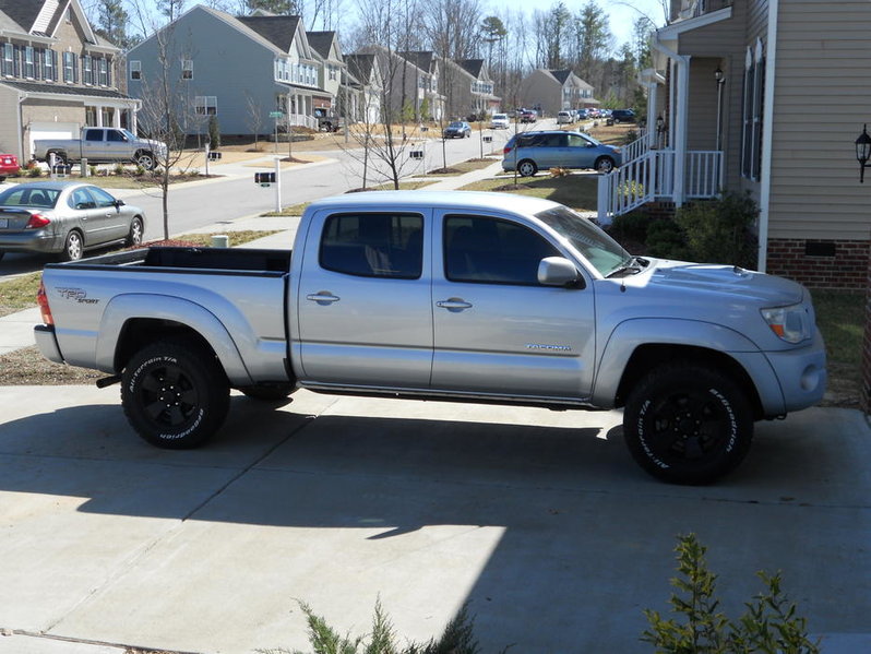

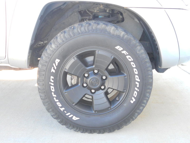

    plasti-dipped two wheels yesterday. going to give it a week and thorough wash to see how they hold up before i do all four. It took 1 whole can to do both wheels. About 5 light-medium coats each wheel, 30 minutes b/t coats. Even after 5 coats I saw a spot that that didn't get good coverage on the center cap and I was easily able to scrape it away with my fingernail after it had dried for 4 hours. On this spot I was able to see silver coming through so it really didn't have any paint on it all. I have now made sure there is very thick coverage on all spots of both wheels. I'll report back next weekend when I see how they hold up to a good handwashing.
