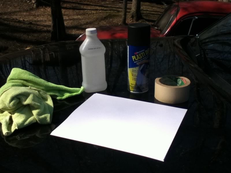

    Start! These are the utilities i used. Rags with Rubbing Alcohol to clean the surface where you are applying the Plasti Dip

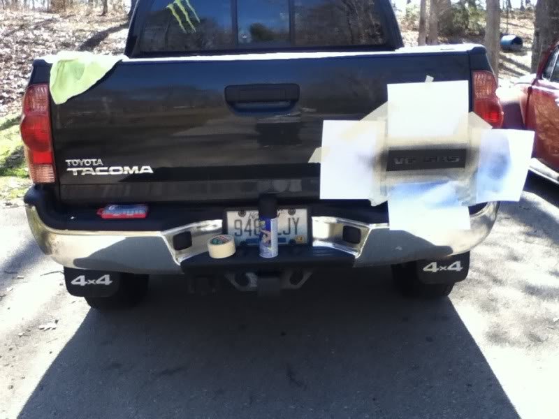

    Clean you area really good then tape around it with tape and paper/newspaper for overflow out of the can.. (Unless you are just a really steady aimer)

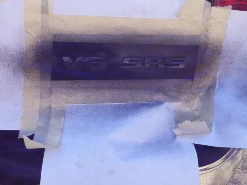

    After you have it taped off and ready for a coat apply a light coat of the Plasti Dip.
    * The dip will not cover the entire emblem like spray can on the first coat, simply add a little bit, then go back about every thirty minutes with another coat. Here is what it looks like after the first coat of it.*
    Simply follow the instructions on the can and hold the spray can 12"-16" away from the surface. Make sure you shake the can really well while applying to surface. Also allow around 30 minutes to dry between each coat!

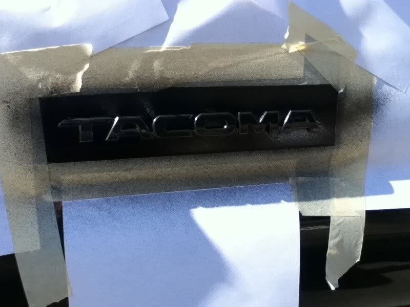

    Second Coat
    The dip is in the process of drying right now for the 3rd and final coats after that i will be posting some more pictures.!
