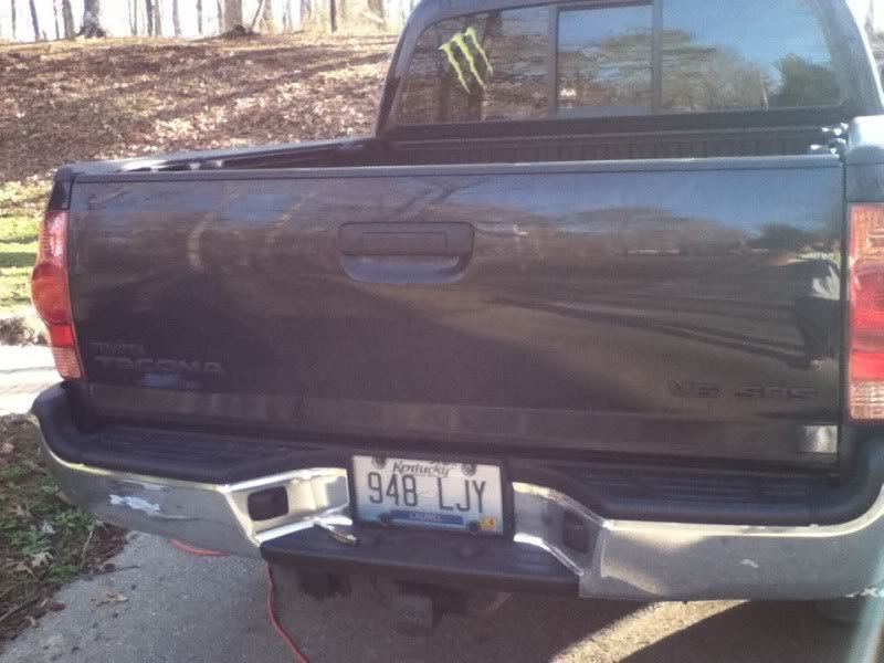

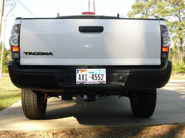

    FINISHED!!!

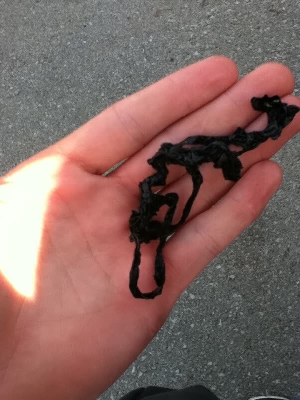

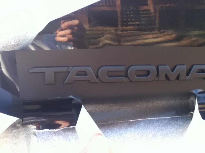

    First i have to say this stuff is really amazing. If it holds up as much or better than paint i have to say i probably wont use paint for anything like this ever again.
    1) I didn't have to remove anything and sand/primer.
    2) It peeled off of the badges so easy (as long as i took my time). Where the letters stick up a little higher, it would brake off perfect.
    Notes: When peeling it off be sure to take your time! The more time you take, the better you are going to be pleased with it after it is all said and done!
    *Also, after putting 4-5 light coats on it, make sure you put it equally all over where you don't have tapped off! This makes it easier to peel and easier to peel around the letters also!
    YESIRRR!!
    Still have to peel between the fine areas but more than pleased!!
    Hope i helped with the write up and if you all need it in order for a sticky or anything let me know and i'll shoot one up! Thanks and goodluck!

    How do you plan on removing the left overs in the small areas? Like inside of the O, A, and C.....

    going to take a toothpick and pick it up enough to grab it.. (got the C out when i was peeling it all off pretty easy, just 0 and A )Really easy to remove

    Thinking real hard about that and the grill!! Final product after removing the inside of the letters!!
