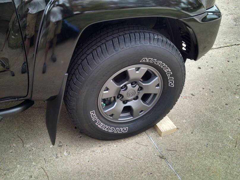

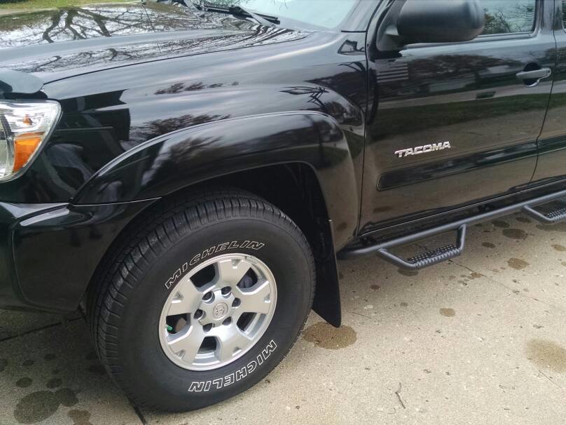

  14. Nov 6, 2015 at 6:44 AM
    #5434
    phreddyfoo
    phreddyfoo Well-Known Member
    Apr 20, 2015
    #153600
    176
    Indiana
    Before
    After anthracite gray.
    JimboAnz, Warputer and ChemDawg like this.

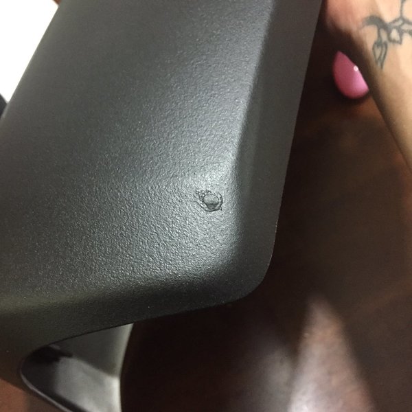

    2020SWDCSBTRDPROFTW
    Did up the valance off my 4Runner over the past 2 nights. Content with the results except for this spot. It was hidden or something...I don't know. I didn't see it until I sprayed my last coat. I had gotten a couple 'drips' from the nozzle that I got cleaned up, but missed this one. Probably just going to leave it, but if I were to try and fix, how would I go about it? I've read wet sanding with windex and 800 - 1000 grit sand paper. Can someone here confirm that works?

    I can't confirm that..but I can say naphtha thinner on damp a microfiber will dissolve it.
    Just be super easy and don't wet more than just the spot ur fixing. .

    I use dip coat on everything I plastidip.
    Plastidip leaves a rubbery feel.
    Dip coat makes it almost as smooth as paint.
    Then when u have to use naptha to fix a peel or a run it makes it easier.
