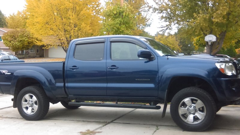

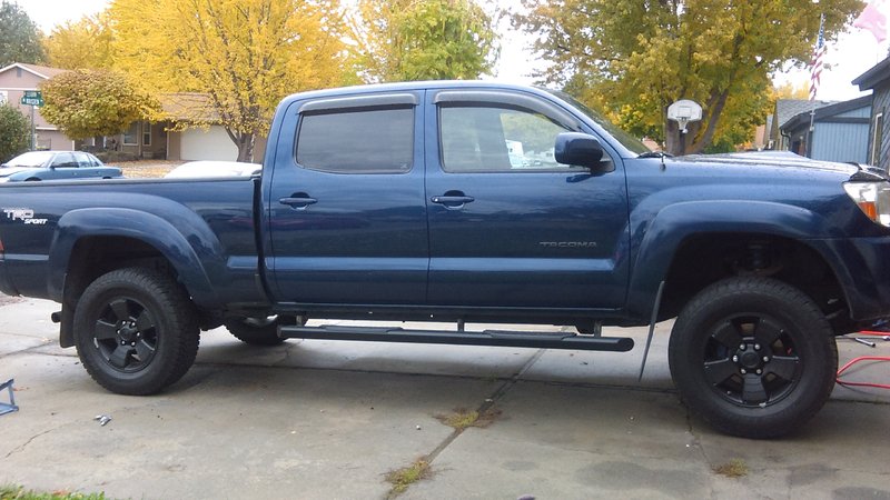

    For guys that dip their wheels do you take the wheel off or do it with it on? Any tips on doing wheels?
  8. Nov 24, 2015 at 7:45 AM
    #5448
    phreddyfoo
    phreddyfoo Well-Known Member
    Apr 20, 2015
    #153600
    176
    Indiana
    I took mine off. See reply 5533 for results.

    Nice dude, those came out clean. Only other thing I wasn't sure of, do you tape off the valve stem or what do you do to avoid that?

    I just sprayed it right on the valve stem. Used cheap temporary caps that I tossed when I was done, put the good ones back on.
    Definitely remove the wheels, dip the back side as well. It'll help protect the wheel from the elements and brake dust.

    I took mine off, but next time I will leave em on. The stuff is so forgiving. I was concerned with getting the dip on the lugnuts, not a concern it will just peel off. Also, I ran a razor knife with very very light pressure, around the wheel to tire lip, after every coat. The first time I dipped them, i did not do this, and the dip bridged this gap, and when I peeled it off the tire, it peeled a little off the metal lip as well.

    I taped the stems and covers. I also only sprayed the front of the wheel, no need to do the backside.

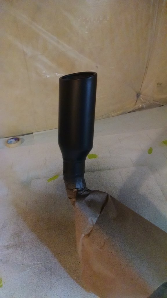

    Dipped my TRD exhaust tip today! It is mid twenties here today so I had to take it inside and dip it in my basement.
    In progress...
    Back on the truck!
    http://[URL=http://s257.photobucket.com/user/snow_man84088/media/Mobile%20Uploads/IMG_20151128_125533014_zpsvg418upc.jpg.html][ATTACH=full]1939826[/ATTACH][ATTACH=full]1939826[/ATTACH]
    [ATTACH=full]1939832[/ATTACH]
    Turned out pretty sweet I think!
