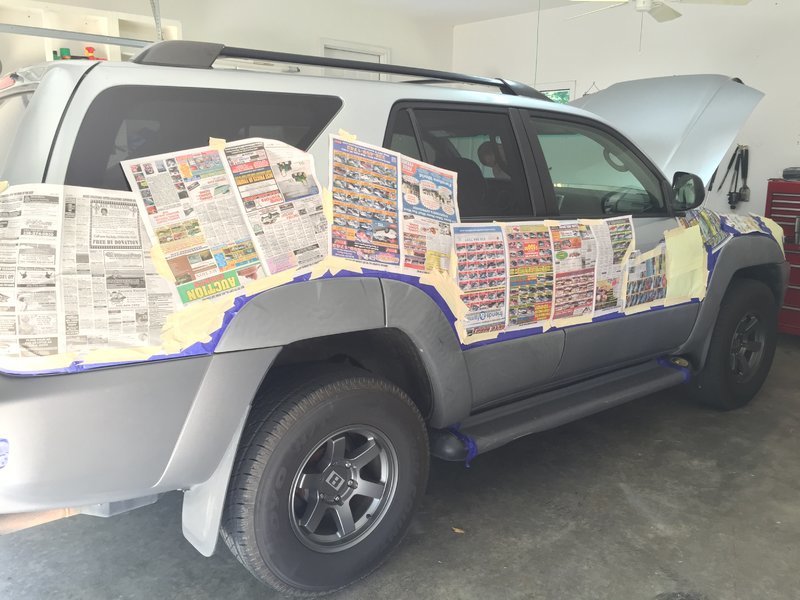

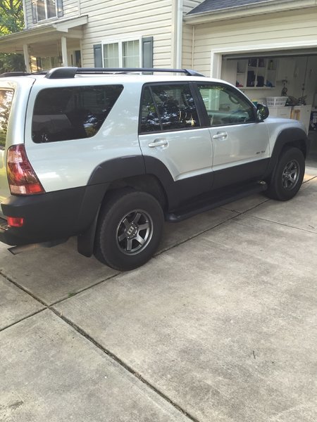

    Dipped the old faded 4Runner.
  14. Jul 8, 2016 at 5:54 AM
    #5574
    ThunderCookies
    ThunderCookies This is the Wait
    May 11, 2015
    #155046
    8,907
    Jon
    North Carolina
    06 Wolfpack Edition
    5100s at 2.5 setting up front 5100s with 2" AAL around back TC Uniball UCAs 285/70/17 Fierce Attitude M/T SCS Ray 10s 17” 14" Magnaflow w/3.5" Stainless Tip SOS aluminum armor front bumper SOS high clearance rear bumper Stealth grill light bar and pods 4" Westin Nerf Bars Weathertech in-channel visors Window tint Bed Mat Proven Ground Locking Roll-Up Tonneau Cover All-weather rubber floor mats Custom Wolfpack TRD Decal TOYOTA Vintage Tailgate Decal 4 Wheel Drive vintage decal Tailgate Anti-Theft Mod Bed Mat Anti-Theft Mod Sliding back glass Anti-Theft Mod Future Mods: Bedside bottle opener Bedside storage lock/key mod Bed pod lights
    Wow - I usually don't like black trim like that but that looks like a brand new car. Great Job :thumbsup:
    Mace587[QUOTED] likes this.

    #5576
    Mace587
    Mace587 Well-Known Member
    Jul 7, 2016
    #191408
    125
    North Carolina
    2016 DCSB TRD OR 4x4
    Thanks, made a huge difference on that old trim, and it's held up really well over the past couple months. Got an Xterra that I'm going to do the same to soon.
