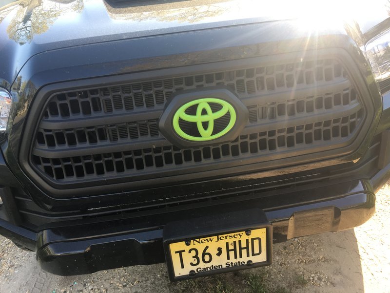

    Sprayed my lower center piece and grill surround today...... I had the grill insert sprayed white as well, but f'd it up when pulling tape off.

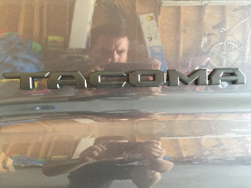

    So I tried my hand at plastidipping my emblems yesterday, and sadly- it was a disaster. After much research and YouTube watching, I picked up all the necessary items, cleaned the badge areas, taped, newspapered, etc.
    I felt my application was even and appeared smooth. The problem started after the 5th coat. (The first 4 were done in 15 min intervals). When I peeled off the tape, there was no plastidip peel to come along with it. It was like painting a wall, and all that was left behind was a clean line of plasti. It was smooth and actually sort of hard. I could not peel the plasti and the toothpick trick was useless. They just kept breaking. I eventually just used "goo gone" on all my applications and removed the plasti. I have no idea if the applications were too thin??IMG_3890.jpgIMG_3898.jpg

    Yep. That's what I'm saying. Just plain ol' Plastidip in a spray can.. After a bit more research, I realized that 1) I was not applying enough product to "rubberize" the coating. And 2) 30 degrees Celsius speeds the drying time on a thin coat.
    I'm happy to report I tried again today and the results were awesome. I barely even had to use the toothpick in between the "A's" and "O".

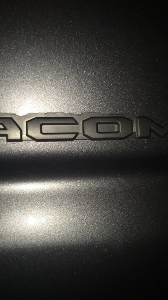

    Popped my plasti dip cherry. I'd give myself a B-
    A few small blemishes that only I would probably notice and I don't care enough to peel it off and redo. I'd rather just de-badge it.
