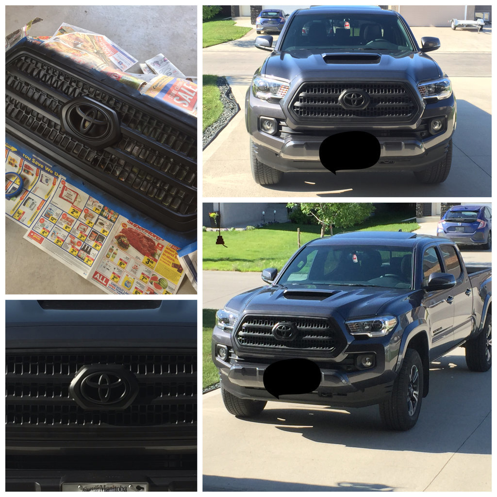

    I'm thinking I'm just going to go ahead and do the stock grill next..

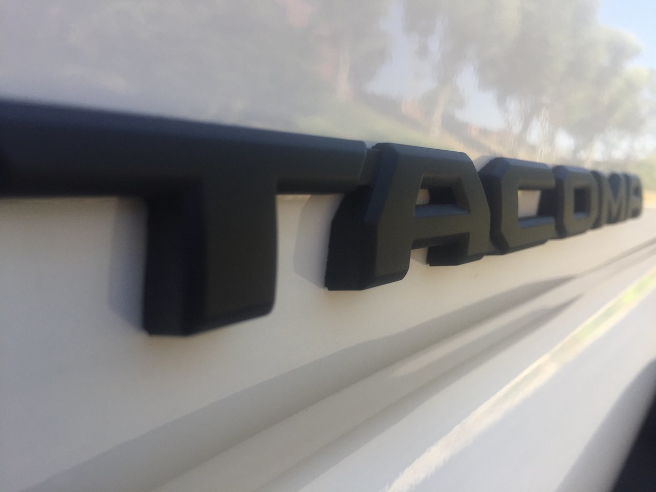

    Please give an explanation of how you were able to do the storm trooper in PD.

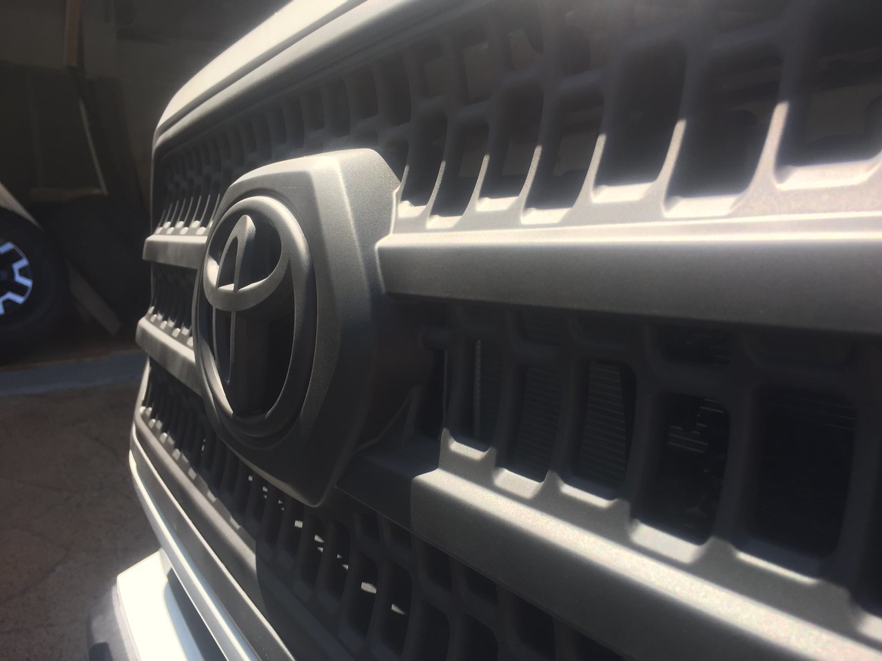

    For any one that is interested. I dipped my '16 but just picked up a 17' or 4x4 and was going to dip it out again. I came across Rustoleum Flexi Dip and decided to try it. Exact same concept but it gives a smoother finish. The plasti dip always had kind of an orange peel effect going on. The rustoleum has worse coverage so it takes more time but so far it looks nice.

    To avoid the orange peel texture... I set my cans of pd in hot water 5-10min before spraying.

    Tried so show the smooth finish of it. I didn't post with original comment because grill was still off the truck and I was applying it. Badges have been done for a day or so.

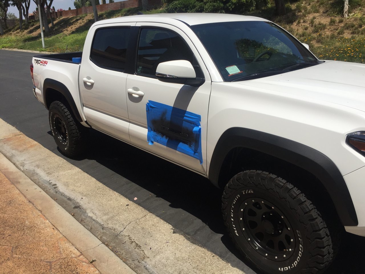

    When you do the door and tailgate emblems do you just leave them on and tape around them? I am a newbie to plasti dip but i'm stoked to try it out this week, however I want to avoid de-badging if I can.

    17' TRD Off-road 4x4
    Yep. Tape and leave about a 3 inch border of no tape around the emblems and peel off excess. Use a tooth pick to get the dip from inside the a, o and in the v6 circle.

    Well, had some time to kill on Monday, so here it is. Turned out awesome.

    T-Rex grill with black bezel. Blacked out all the badges and added the Tacoma on the tail gate. The windows have been tinted to the darkest law will allow.
