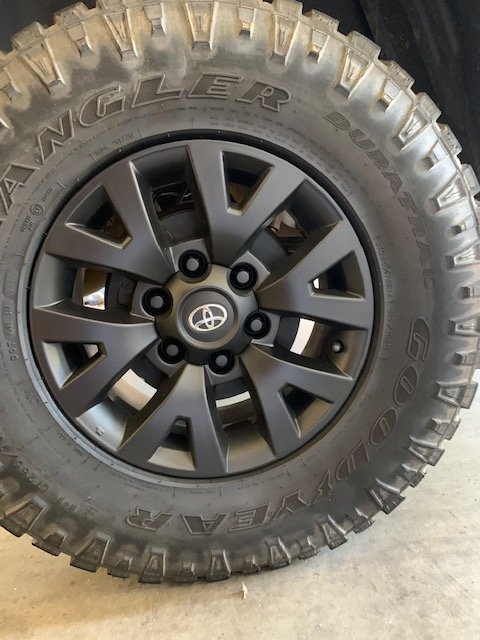

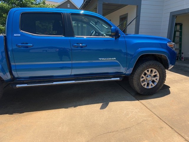

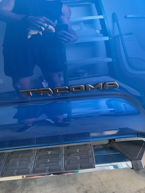

    Did some dipping today...bumper caps tomorrow and removing the running boards...

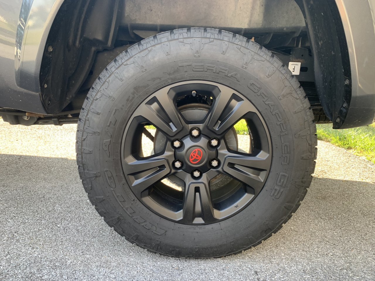

    I dipped my wheels and center cap emblems

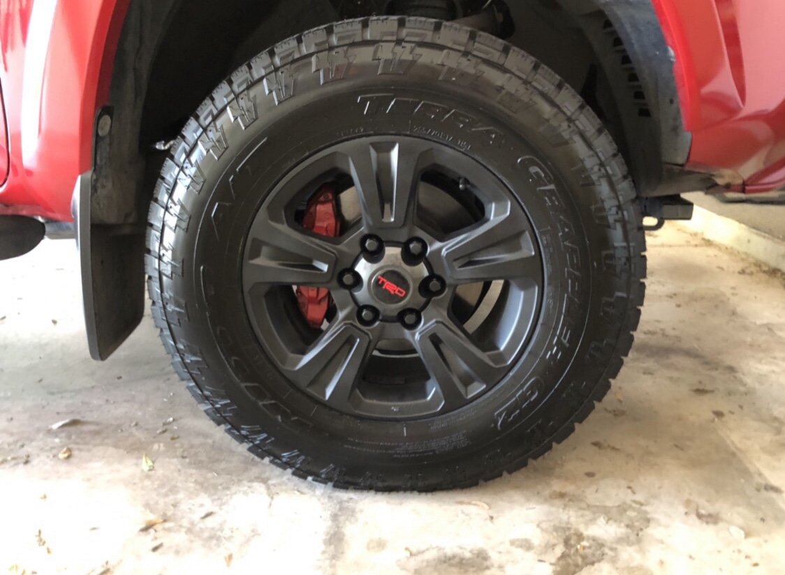

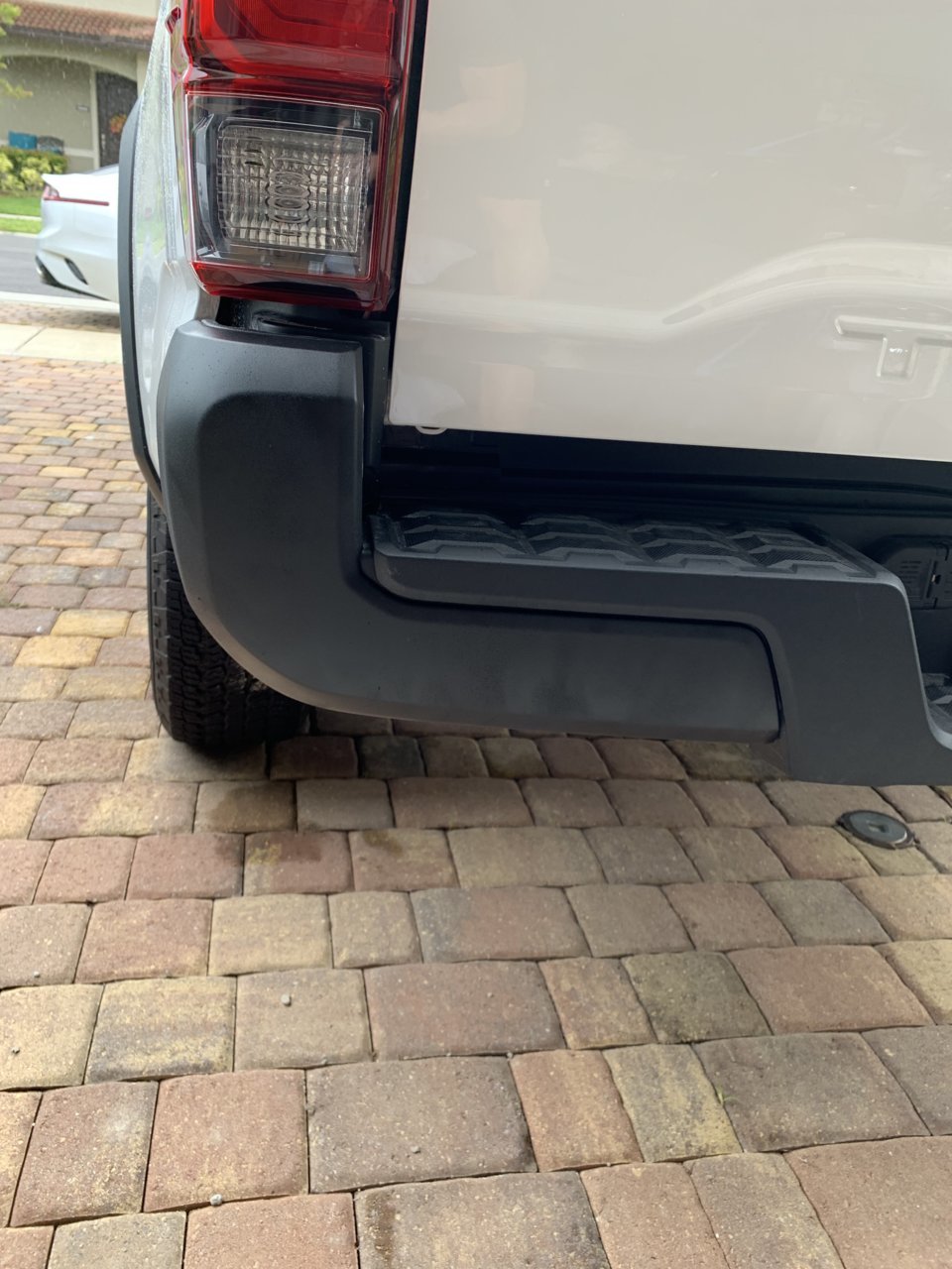

    Rushed it a little bit. Not sure if I like it quite yet

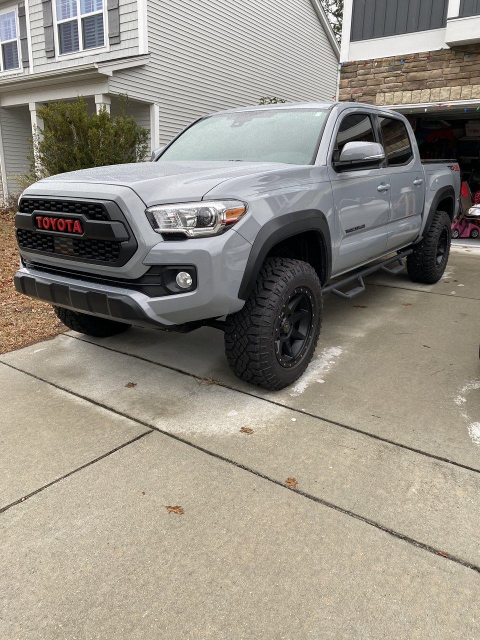

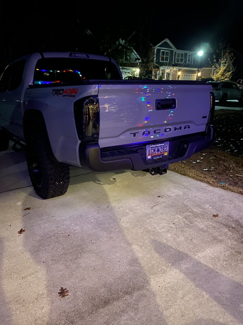

    Did the bumper caps black. Considering doing them gray to match the cement because I’m about to just some gray to do the emblem on the grill. Has anybody done the bumper caps grey?

    I like the red letters on the grill but I think cement will look better.

    For those who have done their emblems/badges, "The Peel and Reveal" .... have you noticed it pulling away from the actual letters?
    I just find it odd that it bonds to the letters, especially around the tops and side, but doesnt peel away when removing from inbetween and such.... it just seems to good to be true....
    Also, did you prep the badges with anything prior? Scuff them for better adhesion? Chrome etching?

    It doesn’t pull away off the letters because of the break between lettering and truck body. Just take it slow when peeling off. For the insides of letters, I used a toothpick to pick them out. Didn’t do anything to letters beforehand except make sure they aren’t dirty. It’s not too good to be true... it’s magic.

    You have to pop them off. I watched a couple of youtube videos in order to do it. Honestly if I had to do it over again I would've bought bumper caps to go over them. It wasn't easy and the clips that hold the actual bumper in place are fragile.

    Once you take the center cap out the little Toyota emblem can be popped out. Plasti dip like regular and pop it back in when you're done. One clip is a little wider than the other so it will only go in one way.

    I didn't cover the tire. It peels off easy enough. I sprayed the lugs
