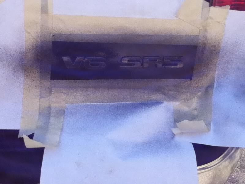

    Maybe you didn't put enough coats on? I but a total of 4 coats on mine and allowed each one of them about 30 min between coats to dry really could good before adding the next one.
    As far as the tape, i didn't tape my badges.. Simply tape a little square surrounding the badges for over spray and spray the entire area.. When you start peeling, the dip should peel right up next to the letters and then break off..
    Begin spray like this
    Will give you this
    Take your time peeling and you get this!
