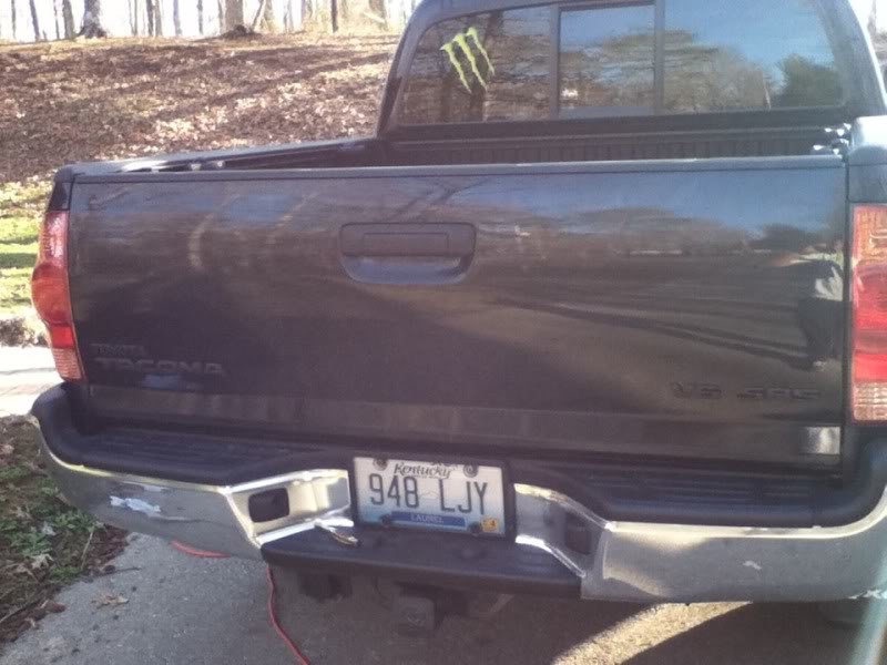

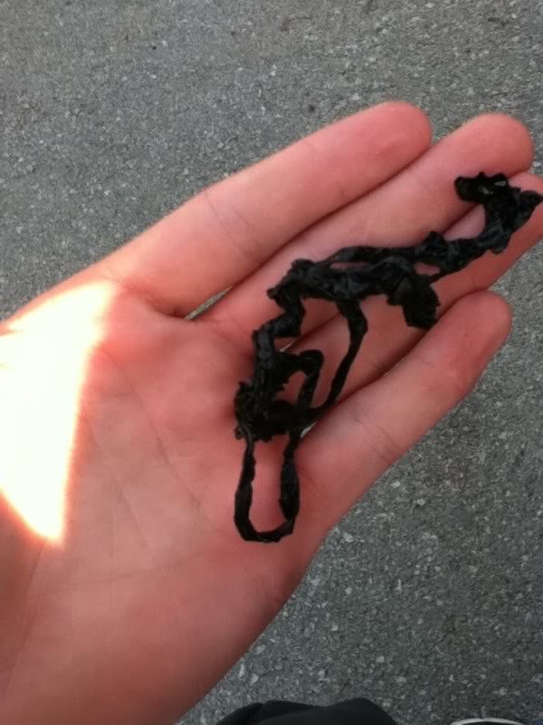

    Why not? I sprayed my chrome bumper and didn't tape off the plastic step. It held until I peeled it off.
    I experimented on the actual paint. Thinking of doing a Hood piece with it. But when you Peel the tape up, the paint comes with it. You guys spraying lower valance, are you scoring the tape line before peeling it up?

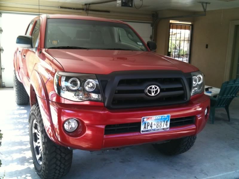

    Common Applications: interior, Grille, Badges, Rims, Bumpers, (anything chrome:D)

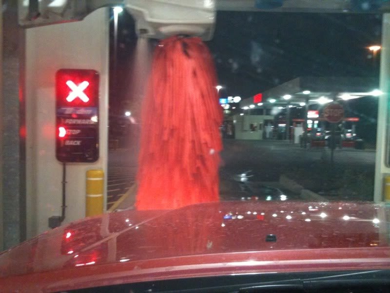

    Yes plastidip can survive high pressure washes and drive through car cleaners

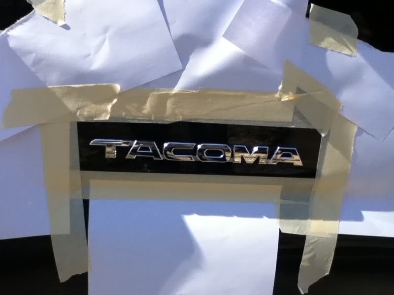

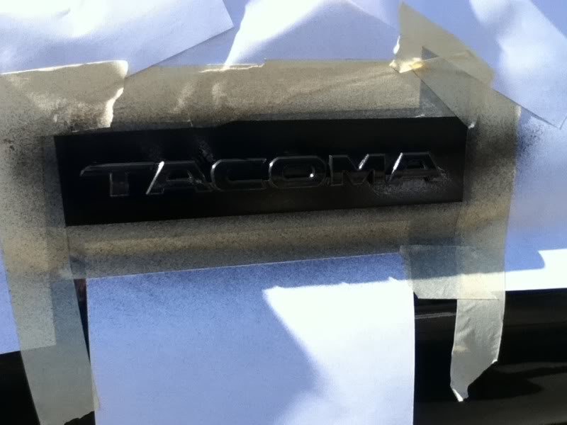

    pic and write up thanks to yfzdrag3 i hope he doesnt mind me using his info

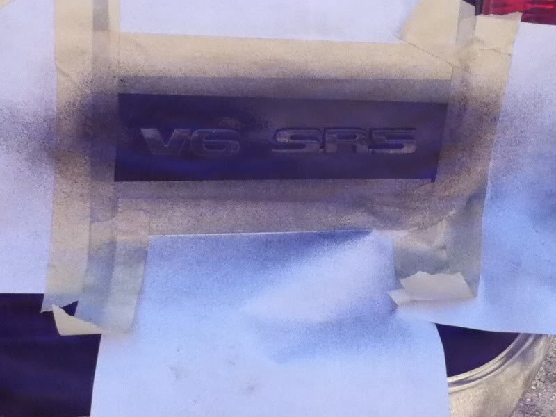

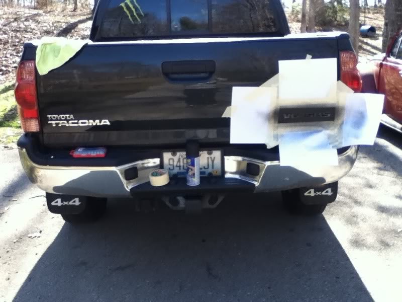

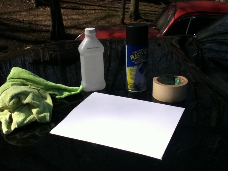

    Start! These are the utilities i used. Rags with Rubbing Alcohol to clean the surface where you are applying the Plasti Dip
    Clean you area really good then tape around it with tape and paper/newspaper for overflow out of the can.. (Unless you are just a really steady aimer)
    After you have it taped off and ready for a coat apply a light coat of the Plasti Dip.
    * The dip will not cover the entire emblem like spray can on the first coat, simply add a little bit, then go back about every thirty minutes with another coat. Here is what it looks like after the first coat of it.*
    Simply follow the instructions on the can and hold the spray can 12"-16" away from the surface. Make sure you shake the can really well while applying to surface. Also allow around 30 minutes to dry between each coat!
    Second Coat

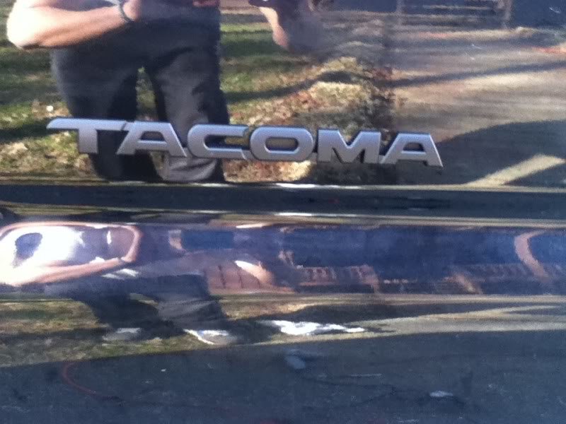

    First i have to say this stuff is really amazing. If it holds up as much or better than paint i have to say i probably wont use paint for anything like this ever again.
    1) I didn't have to remove anything and sand/primer.
    2) It peeled off of the badges so easy (as long as i took my time). Where the letters stick up a little higher, it would brake off perfect.
    Notes: When peeling it off be sure to take your time! The more time you take, the better you are going to be pleased with it after it is all said and done!
    *Also, after putting 4-5 light coats on it, make sure you put it equally all over where you don't have tapped off! This makes it easier to peel and easier to peel around the letters also!
    YESIRRR!!
    Still have to peel between the fine areas but more than pleased!!
    Hope i helped with the write up and if you all need it in order for a sticky or anything let me know and i'll shoot one up! Thanks and goodluck!

    pics of common applications
    rear bumper (jcrazy425)
    how to
    :http://www.tacomaworld.com/forum/2nd-gen-tacomas/145949-how-plasti-dip-your-bumper.html
    Grille 2nd gen (jcrazy425)
    Lower Bumper 2nd gen
    (SR54x4)

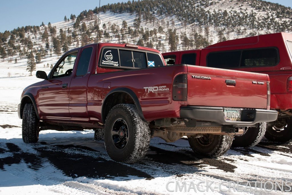

    Badges w/ front and rear bumper
    1st gen (cmack http://www.tacomaworld.com/forum/1st-gen-builds/67995-devil-penguin.html)

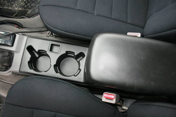

    Interior
    1st gen (SlimDigg- http://www.tacomaworld.com/forum/1st-gen-builds/113795-slimdiggs-2001-double-cab-build.html)
    Floor trim
    Side of seats
    center console
