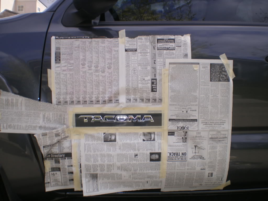

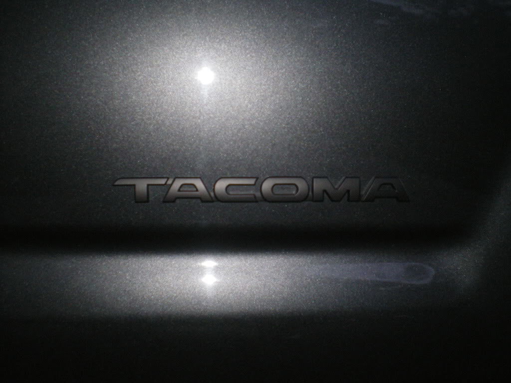

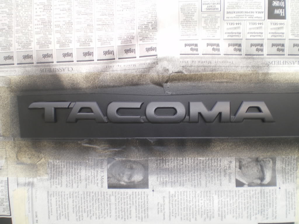

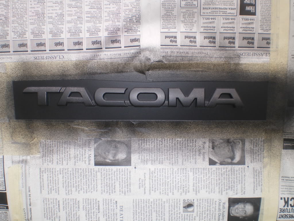

    well here we go with pictures:
    This was done at about 5pm to 7pm with outside temp at about 60-65 degrees.
    ENJOY :D
    Materials needed:
    All prepped and cleaned:

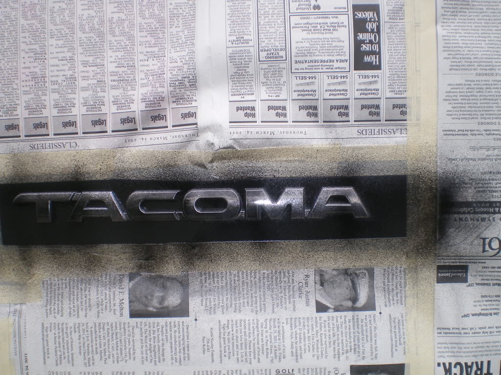

    Coat one:
    Coat Two: (waited 15 minutes between each coat)
    Coat Three:
    Finished Product: (waited one hour to peel)

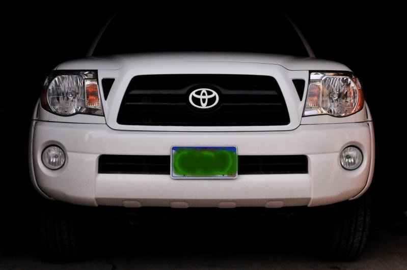

    Tinted windows, Plasti-dipped emblems (black), white 2011 grill w plasti derped white toyota emblem, Weathertech dontfits; Clarion HU, Hertz-165 Coax, Alpine 500w mono to 8" JL 3w3, Wet Okeles, CBI sliders, Eibach/5100's @0.85 in front, Dakar leaves and OME shocks in rear, Leer topper.

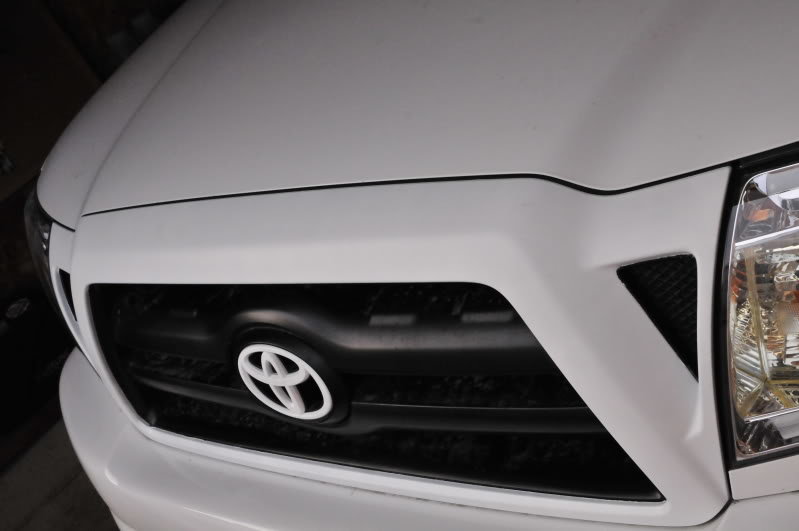

    So does the white plasti-dip match?
    You be the judge, keep in mind my truck is dirty.
    I guess it depends on how picky you are, and how it wears over time.
    Its pretty close, but not perfect.
    I didn't do the best job of application. and taping the grille was a pain, but at least I found out that I would like a color matched grille. The edges came out pretty crappy where the paint met the tape too. but i can just peel it of or re-do it!

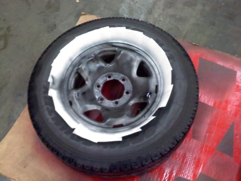

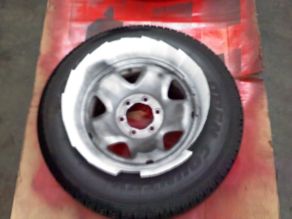

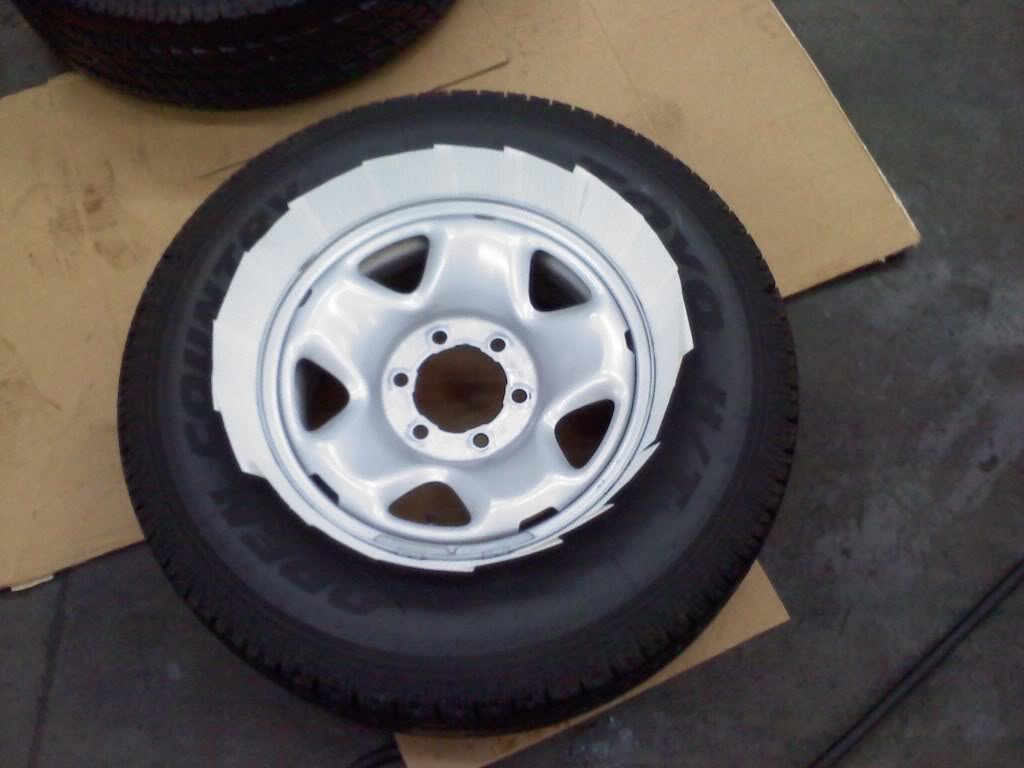

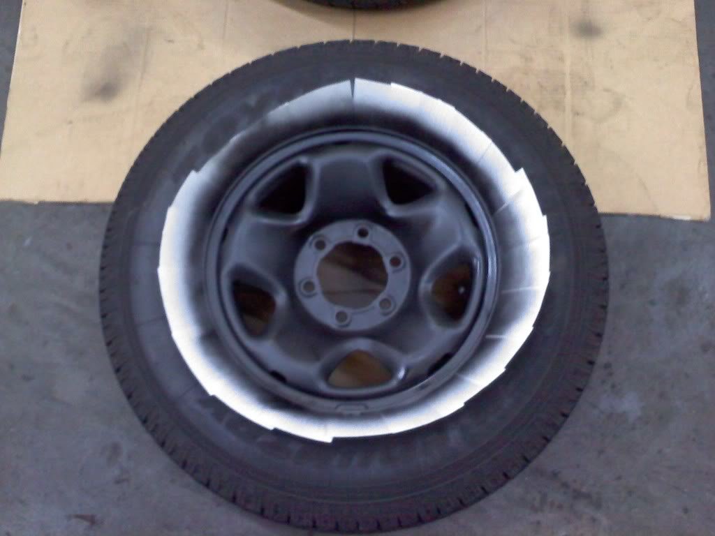

    How i did my wheels..
    Did what people said and lined the wheel with note cards:
    Then start with the coats every 15 minutes. I did i think 5 total
    All done. Im pretty please with it!! i happened to miss a few spots but ill just touch them out later when its dry. Hope you like it!

    Looks good man. Did you do any scuffing/sanding to the wheels for better adhesion? Would be interested to see how it holds up.

    i didnt do any type of prepping at all. All i did was get a shop rag and clean the rims. it was raining all day so they were kinda wet. so thats what i did. Ill let you guys know how everything is in the next few day/week

    I dipped my rims... lools really good for about 2 weeks...now it looks like shit

    Why? Hard to keep clean, scuffing, oxidation? Let us know dude.
  20. Mar 26, 2011 at 9:59 PM
    #940
    kinkrider101
    kinkrider101 Well-Known Member
    Sep 29, 2009
    #23497
    2,649
    santa barbara
    2007 cummins/2007 tacoma
    wheels and tires
    Its hard to clean and mine keeps peeling as I drive, I've redone some wheels like 2 times, bubbles just keep formine and its peeling where the tire is, still looks sick though
