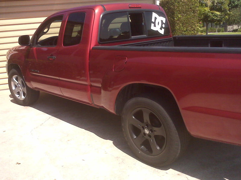

    dipped my rims today :D

    a buddy of mine is doing his this weekend. Now that you did them do you have pointers? Would you do anything different? From the picture they look good.
  8. Jul 27, 2011 at 7:37 PM
    #1808
    upnadam
    upnadam Well-Known Member
    Jul 3, 2011
    #59224
    83
    Adam
    Wilmington, NC
    11 PreRunner TRD Sport LB
    5100's up front, TSB, tinted windows, tail gate theft deterrent mod, fog lights anytime, de-badged, 7 pin relocate, AFE dry, Magnaflow
    It rained the afternoon I sprayed them on, on the drive home and the next day too. Survived the wash today as well with zero issues so far.

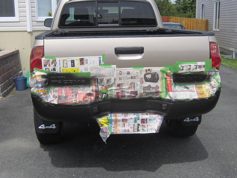

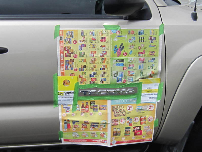

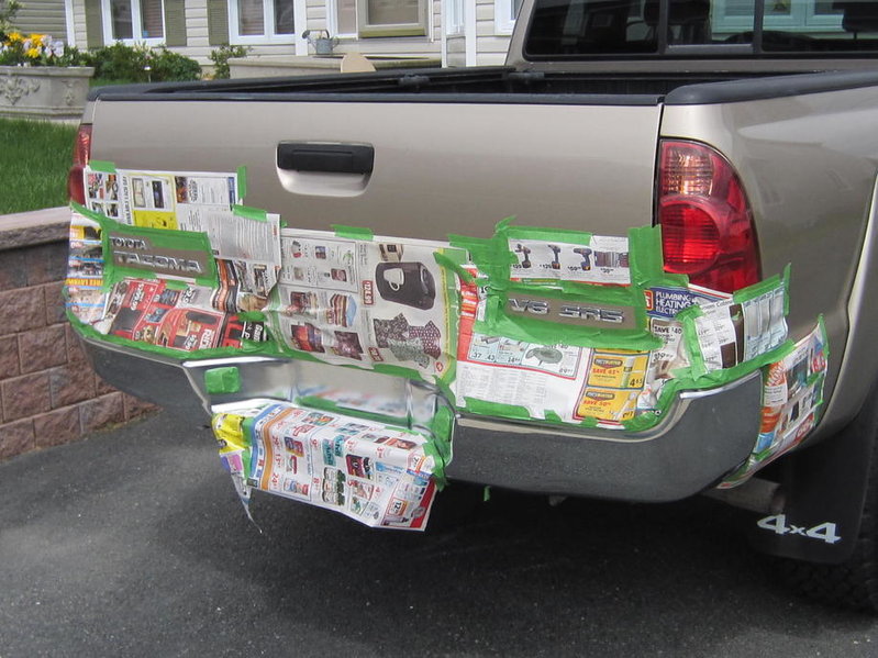

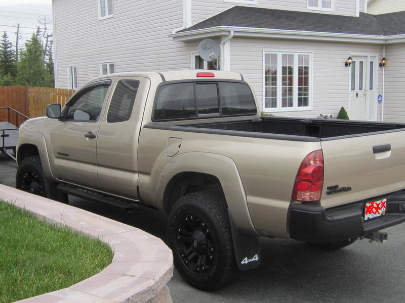

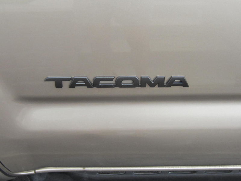

    Finally did the truck today. One can did all the badges and bumper with 5 coats, and enough for re-touches and still a drop left. I had to retouch the tailgate badge as the Toyota was hard to get a good coating. It cooled off later in the day and its harder to peel the excess off. But it looks awesome!
    Lessons learned:
    There are parts of the black plastic step on the bumper that touch the chrome, other places it doesn't. If I had my time back, I would have tried to wedge the places that were touching apart. It makes it hard to peel the Plasti-dip off with the tape etc. I had to touch up some spots after.
    I also learned quickly to not go side to side over the badges where the spray was perpendicular to the surface. I turned the can so the spray was hitting the badges on an angle to make sure the edges were getting properly coating. I also pointed the nozzle up from under the badge to get at the bottom...opposite for the top of badges.
