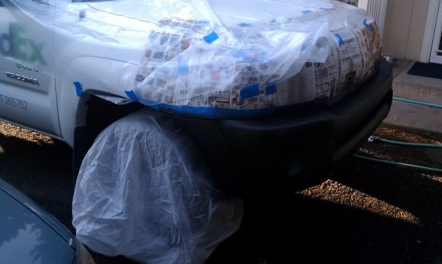

    It worked very well for my needs. My FedEx truck was required to have a black front bumper. Cheap easy and reversible.
    Just take your time let the layers dry for 30 min between coats. And do at least 3 coats.
