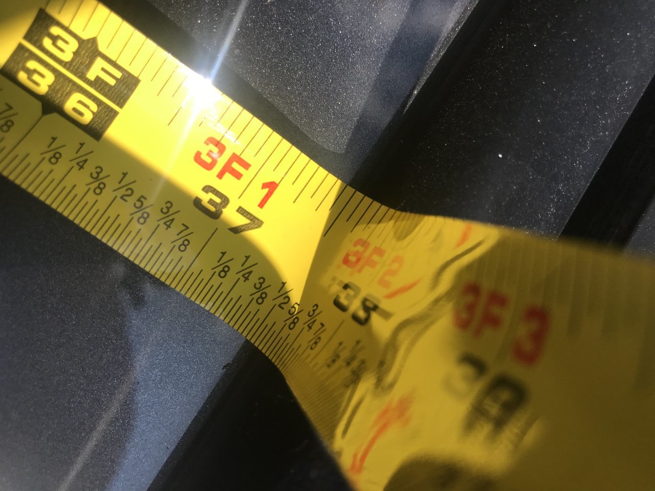

    Here you go:

    Thanks man! Is that inside edge to inside edge?

    Yes. Inside edge to inside edge

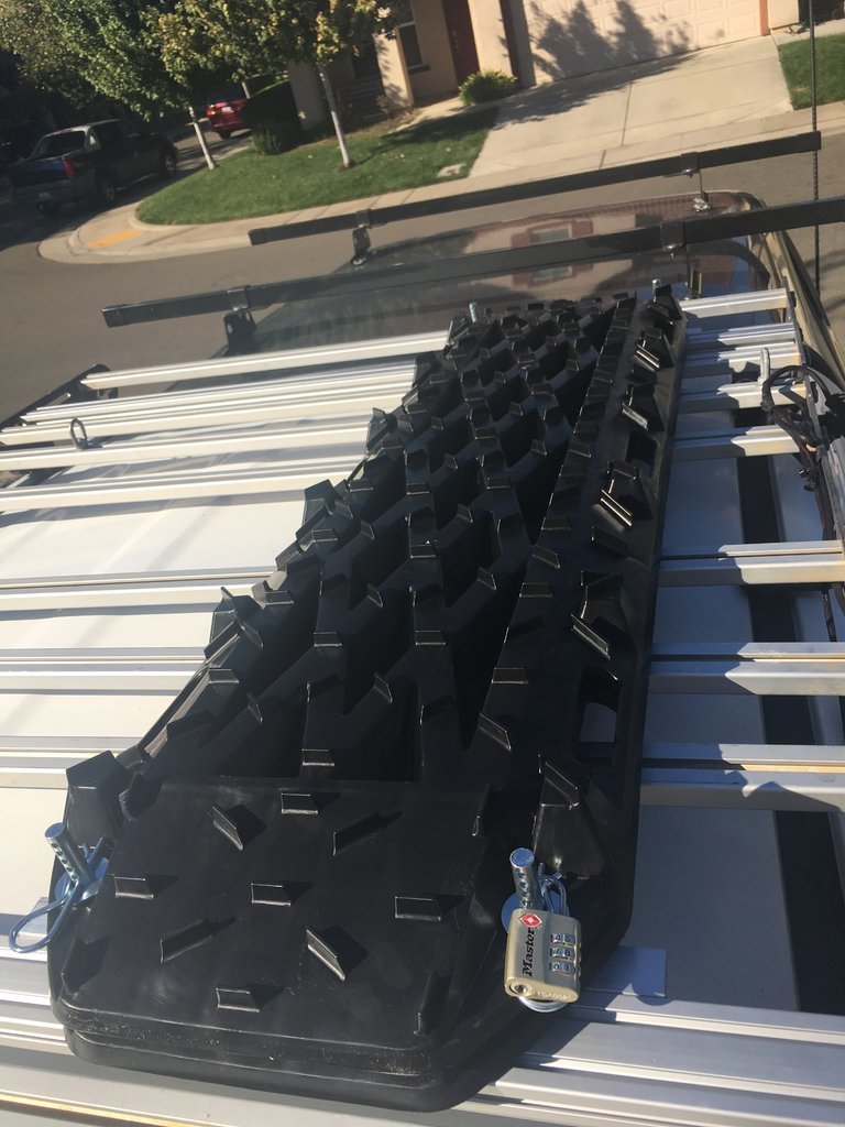

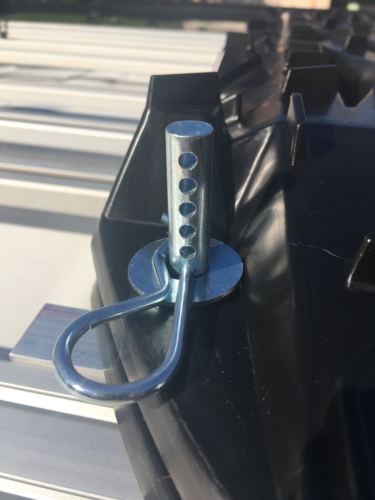

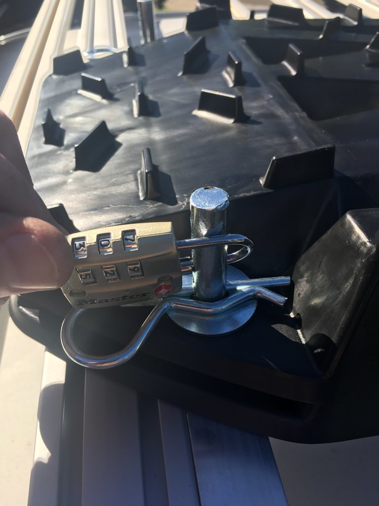

    Just mounted X bull traction boards to my Prinsu. Used the same method with the angle but instead of bolts I welded hitch pins and used cotter pins and a small lock that fit inside the pins.
